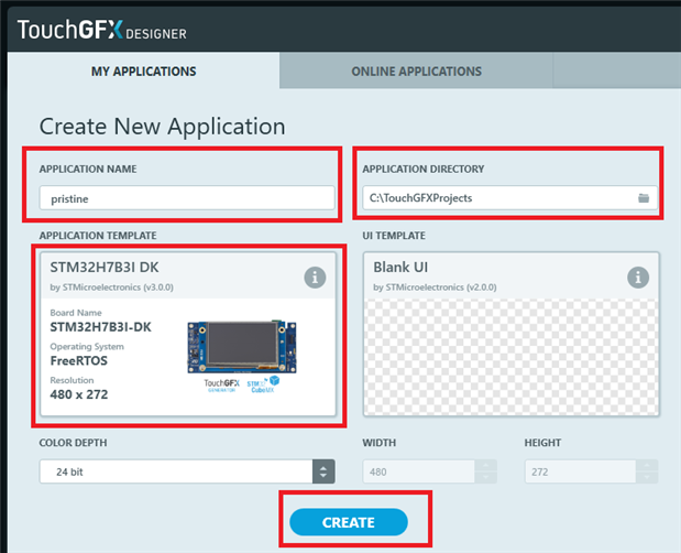

To do this, start the Designer, then give this temp project a name and location.
Select the development kit as template, then click create.
Then click Generate Code top right. That's it. You now have a .ioc file ready in the subfolder where you created your project.

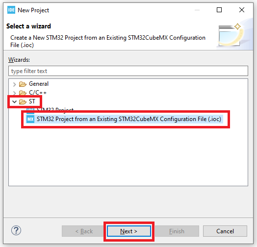

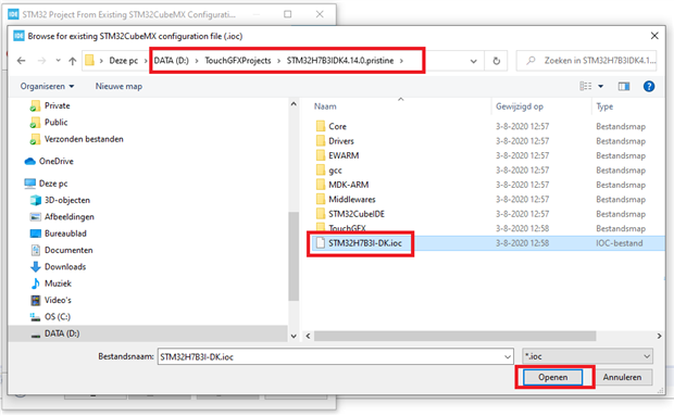

2. Create a CubeIDE project based on your .ioc file
Start CubeIDE, and open menu File -> New -> Project ...
Then select ST -> STM32 Prooject from an existing Stm32CubeMx Configuration File (.ioc)

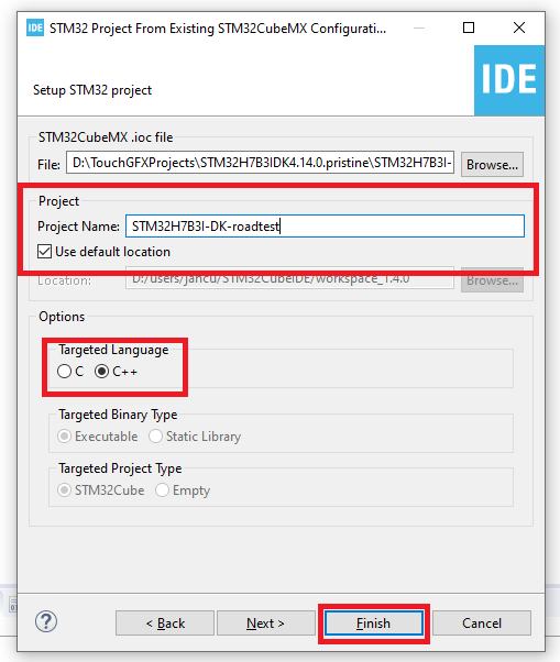

Next, and select your freshly created .ioc file.
Open
Finish, don't migrate if asked (unless you know how to do that. In that case please write a blog about it image ).

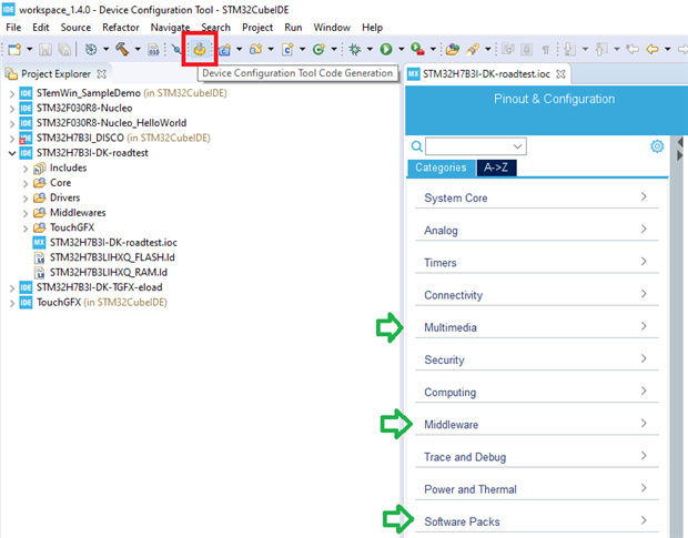

Let Mx generate the project.
If you're curious, click on the items marked with the green arrows and appreciate what's done for us. A lot is preconfigured by the .ioc file.

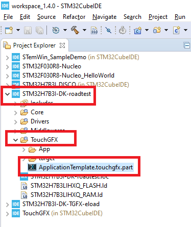

Open the TouchGFX folder of the new project, and double-click the link called ApplicationTemplate.touchgfx.part.
The Designer opens, with your project loaded.

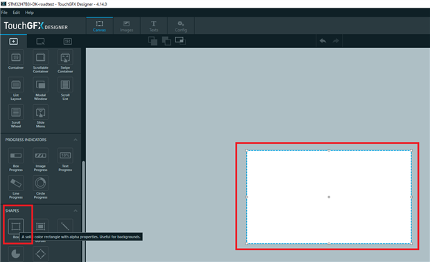

Draw a white box on the empty screen.

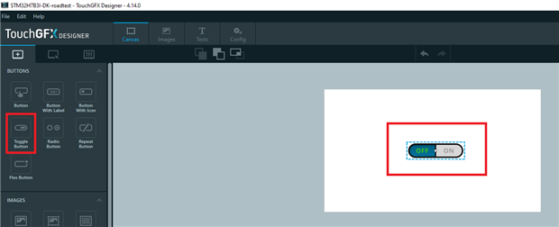

Add a toggle button (why: because it's easy to test the touch screen with it later).
Click Generate Code in the right upper corner.

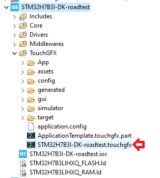

Back to CubeIDE. Right-click on your project and select Refresh.
The Designer generated the remainder of the code for you. And also a new link. From now on, if you want to alter the design, select that link.
Right-click on the project and select Build Project.

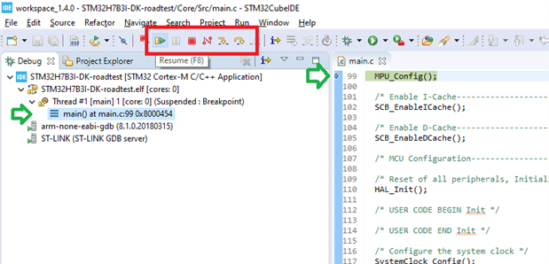

If that's successful, let's do a first debug session.
Attention: your graphic design will not show yet. We are successful if at the end of this step, we have a black screen: no backlight, no image.
Plug in your development kit.

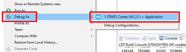

Right-click on the project and select Debug As -> STM32 Cortex-M C/C++ Application

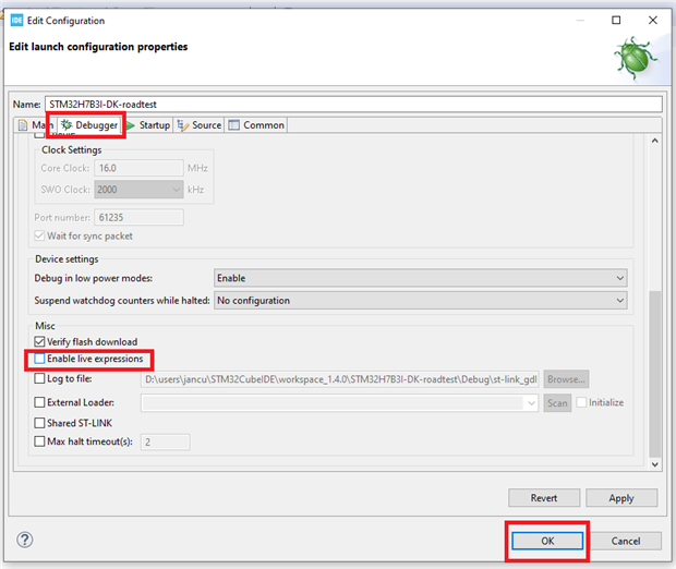

Navigate to the Debugger tap and unselect Enable live expressions.
Press OK. The debugger loads the firmware to the controller and stops the session at the first line of the main() function.
This is a good opportunity to try out the debugger. You can step through the code, resume, ...
Don't be disappointed that you won't see anything, and that even if the backlight was on when starting, it will be dimmed when this line is executed:
  /* Start scheduler */
  osKernelStart();
We'll fix that in the next section.
When you're finished plaing, press the red stop button in the IDE to return to the edit view.

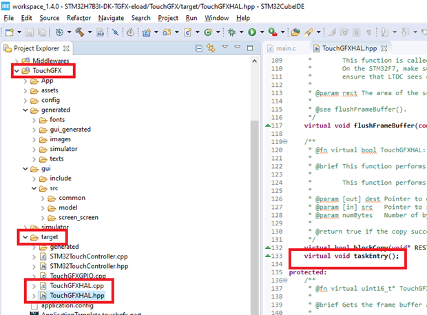

5. Fix the Display Initialisation
The CubeIDE + Designer combination doesn't implement a virtual function needed to initialise the display.
Funny enough, when you create a project with the Designer itself, this function is generated. But then you can't use the Mx HAL configurator in your IDE. Can't have it all.
Navigate to TouchGFX -> target. We'll edit two files there and add the missing virtual function.
First in TouchGFXHAL.hpp, add this as the last function in the public section:
virtual void taskEntry();
Save
Then in TouchGFXHAL.cpp, add the implementation:
/* USER CODE BEGIN TouchGFXHAL.cpp */
#include <touchgfx/hal/OSWrappers.hpp>
void TouchGFXHAL::taskEntry()
    enableLCDControllerInterrupt();
    enableInterrupts();
    OSWrappers::waitForVSync();
    backPorchExited();
    // Turning on display after first frame is rendered
    HAL_GPIO_WritePin(GPIOK, GPIO_PIN_7, GPIO_PIN_RESET);
    /* Assert display enable LCD_DISP_CTRL pin */
    HAL_GPIO_WritePin(GPIOA, GPIO_PIN_2, GPIO_PIN_SET);
    /* Assert back light LCD_BL_CTRL pin */
    HAL_GPIO_WritePin(GPIOA, GPIO_PIN_1, GPIO_PIN_SET);
    for (;;)
        backPorchExited();
/* USER CODE END TouchGFXHAL.cpp */

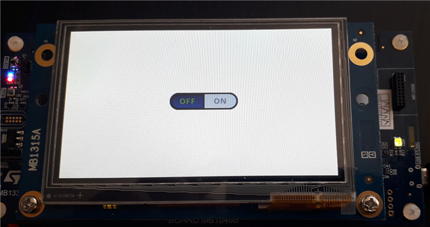

Build and Debug again
When you execute the program, the backlight switches on and your home screen appears. The touch screen doesn't work yet, so the button doesn't toggle.
