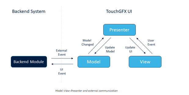

In this part of the review, I explore the application layer:
  • request data from the business layer
  • display that data
  • use the Model-View-Presentation style paradigm, where the display logic only deals with display matters
  • use a freeRTOS message queue to send business layer data to the TouchGFX application
image source: ST TouchGFX documentation
The business layer in my example is a SCPI client.
The TouchGFX app has no knowledge of the fact that the SCPI client uses UART to talk to the my electronic load.
Ah, and it's in C++.

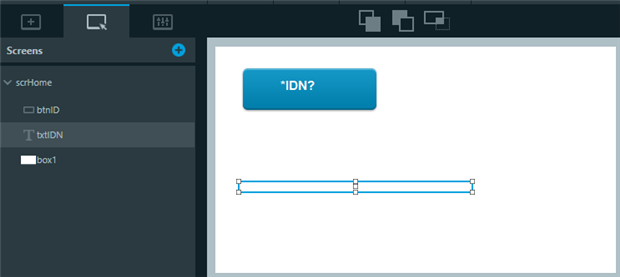

Graphic Design
A simple design: a button and a textbox. When I click the button, I want to ask the load for its SCPI identification.
When that ID arrives, I want that the textbox displays it.
If I click the button again, I want the textbox cleared.
The button needs to have an event handler. I am not explaining that here because done in the previous posts.
For later reference, the function called when the button is clicked is fnClickID(). The implementation is discussed in the code part of this article.
And I'll attach the code.

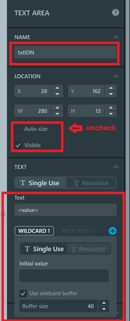

The text area is a bit more involved. To be able to change the text, we need to define a wildcard.
This will create a 40 character buffer that we can write into. We'll do that in our View code, then ask the screen to redraw that part.

The tick() is a standard feature. The TouchGFX loop keeps the model alive by making it tick every so often.
In that method, we chack if data is received from the business layer (SCPI).
If yes, we check what type of message, and then inform the presentation layer of that.
At this moment, the only thing the model (and other classes) understand is the reply on a *IDN? command.
The other way around, asking the business layer to send a SCPI command in request_scpi_idn(), is - as I discussed in the compromises section - done by directly calling that layer. Discuss.

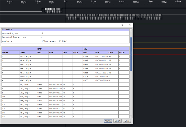

I know that the last character the electronic load sends on a data request, is a '\n'.
When I detect that, I call the SCPI manager to notify it that the payload arrived.
Here's a capture of an exchange.
SCPI doesn't always reply on a message. Only on queries. For this design it doesn't matter because request and response are separate mechanisms.
What would be unexpected is a response without sending a request first. But that should not happen.
