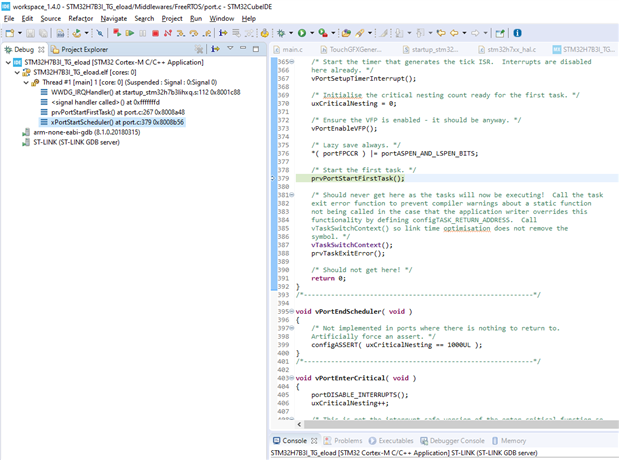

The kit has arrived, and the first results have been mostly successful, except for graphic projects using TouchGFX.
What works for me:
image A graphical STemWin project. I imported the example in CubeIDE, built it, loaded via STLink and debugged it.
image Out of Box binary downloaded from product page and then upload it via STLink using the STMCube Programmer.
image what I can't get to work yet: Compile a ToughGFX (example import or a self-made project) and load it on the board from CubeIDE.
The compilation / build succeeds. The STLink debug session starts but then the firmware load fails.
Error in final launch sequence:
Failed to execute MI command:
load D:\\users\\jancu\\STM32CubeIDE\\workspace_1.4.0\\TouchGFX\\STM32CubeIDE\\TouchGFX-STM32H7B3I-DK_OoB-Release\\TouchGFX.elf
Error message from debugger back end:
Load failed
Load failed
Load failed
Load failed
Some investigation to do ...
(solved, see comment below)

    Jan Cumps over 5 years ago in reply to Jan Cumps +3
    I have it working on the CubeIDE too now. I reused a .ioc file from a TouchGFX generated project for this board, and created a new CubeIDE project based on that. Then used the generated hyperlink to load…
    Jan Cumps over 5 years ago +3
    I have more success when following this video (not mine!)
    Not everything translates to this board, and some corrections needed, but the debugger loads it and the RTOS starts ...
    It's not the build program. Because when I use the command line STMCube programmer to load the binary made by CubeIDE (I used the build profile TouchGFX-STM32H7B3I-DK-Release), the firmware loads and works.
    So it must be the debug settings for the project in CubeIDE .... Investigating further ...
