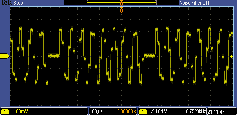

That experiment wasn't very successful. My attempt to recast it for the 18-bit multipliers in the Lattice device was a mess and didn't work properly. Although at first I got something like a sinewave from it, it was stuck on a single frequency and didn't respond to changing the parameters in the way it should have done.

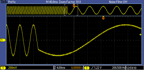

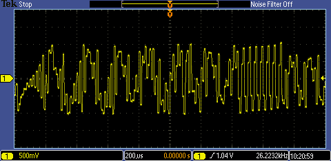

Fiddling about with it made for some very entertaining waveforms, though. Here's an example:
At that point I realised that I wasn't even implementing the correct form. I had implemented the simple Biquad oscillator thinking that it was the same as the oscillator given in that testbench, but it isn't: the one in the testbench has a couple of extra delays. I tried adding those, but had even less success - it now didn't do anything. I think that was down to my arithmetic and not handling the fixed-point stuff properly but, at this

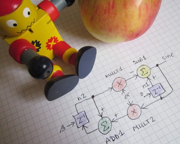

Magic Roundabout Oscillator
This oscillator - 'Magic Roundabout' is my own name for it, it often gets called 'Magic Circle' - works on an alternative principle, namely modelling a rotating vector. Although the details are hidden and not obvious from simply looking at the code, essentially it's matrix multiplication where the matrix does rotation of a unit vector about the origin. [I found that out by reading about it - I wouldn't have puzzled it out for myself.] The
number of multiplications needed can be reduced to two multiplies rather than the four you might expect and, though there are two multipliers, they take the same parameter, so simplifying the frequency control of it.
Here's a diagram of its form:
If you're not used to such diagrams, the boxes marked z^-1 are storage elements and latch their inputs at each sample time, so providing a single sample-period delay.
This oscillator has two state variables. One is the sine output, the other is almost the quadrature of that but, if I'm understanding it correctly, differs by the amount needed to drive the process forward (it's almost, but not quite, the cosine, but the difference from the true cosine will vary according to the frequency selected and the inaccuracy will get quite bad at the top end of the frequency range). A nice feature of it is that the
frequency control parameter can be varied on a sample by sample basis [there's no previous history that would need to be adjusted], however I don't know if it remains constant-amplitude if you do that a lot.

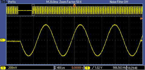

This time I was immediately more successful. Here's the DAC output for a 1kHz sinewave with a peak-to-peak amplitude of 1V (that's half the DAC range).

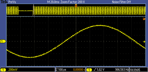

Here's a closer view of the sine - keep in mind that there's no reconstruction filter, so we expect to see the steps.
I ran that for about half an hour (about 1.8M cycles) and it didn't show any change of amplitude.
Here it is with the code adapted to switch between 250Hz and 25Hz on the fly. I ran that for about 10 minutes without seeing any change of amplitude, but the switch of frequency only occurs about once a second, so you'd need a much longer test to be very sure of it. I had a look at it later and the amplitude had increased slightly, so it looks like it does wander.
