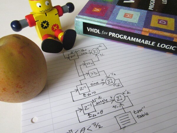

An alternative way to compute a sine and, simultaneously, a cosine from a given angle is to use a CORDIC method. That's what I'm going to try here.
CORDIC Sine
I've based what I've done on a very useful article by Ray Andraka[2]. His survey is both good on the basic algorithm and is also very practical in that it focuses on implementation in programmable logic rather than with a processor. As a result, I won't spend too much time talking about the theory of how it works.
Here's how it looks in a fairly generic form.
(Today's apple is a Norfolk Royal Russet.)
Curiously, the method has some commonality with the computed iterative oscillators I looked at in a previous blog. Those oscillators relied on rotating a vector and this does too, however this time there are two rotations coupled together, the unit vector (represented by a pair of variables holding the sine and cosine) and that of the desired angle. As the angle is taken to zero, the 'unit' vector moves in step to the sine/cosine value for the starting angle. The neat thing about it is that the operations on the vector are in terms of powers of two, so multiplies become shifts. The overall process has some gain, so the cosine value at the start, instead of being one, is set to the inverse of the gain for the number of iterations being done so that the end result is unity [otherwise we'd need a multiplication at the end to scale it]. Of course, unlike the iterated oscillators, this one computes the sine from scratch for each sample, so there are no potential propagated errors from sample to sample, though obviously we need to concern ourselves with matters like the precision of the calculation: the control angle will come from a phase accumulator, in much the same way as with a sine table look-up.

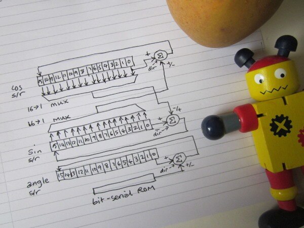

Andraka's paper outlines three possible ways to implement the CORDIC processor, each with advantages and disadvantages. The natural way you'd think to do it, operating on words with one iteration per clock, unfortunately necessitates a barrel-shifter. That starts to get expensive in terms of both area (logic) and time, because of the delays through it, as the word length goes up. The simpler approach he gives is the bit-serial one. Here the variables are held in shift registers and the add or subtract is done one bit at a time. In this case, the barrel-shifting can be done by tapping off the shift registers. The big problem with this approach is simply the time it takes to do all the processing. Going the other way, he also points out that the fastest approach would be to unroll the iteration and have dedicated hardware for each cycle (this is the equivalent of in-lining a piece of recursive code). Interestingly, that helps with the shifts because there's no longer a need for components to do that, it all becomes a matter of wiring as the shift is fixed for a particular cycle. The table constants [the inverse tangents of the vector steps] also become wiring as the constant that is added to or subtracted from the angle for a particular iteration is a fixed value.
Because my sample rate is very low compared to the clock rate (100ksps vs 50MHz: I've got plenty of cycles before each result is needed) and I liked the apparent simplicity of the bit-serial approach, I chose to have a go at that one. [Note the word 'apparent' there. It didn't turn out quite so simple as it looked from simply drawing it quickly on a piece of paper.]
Data-flow Diagram
Here's how it's structured in the bit-serial form:

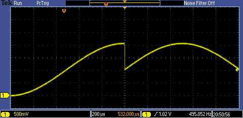

Coding and Testing
Here's the VHDL I concocted. As before, it hasn't been tested thoroughly nor had the output validated in anyway. It's an experiment: use it for real at your peril!

Here it is generating the fourth and first quadrants of a sine (left of screen) and the fourth and first quadrants of a cosine (right side of screen). I've got about 100 steps from -pi/2 to +pi/2, so the time is something like 10uS x 100 = 1ms for each. [It generates both sine and cosine together but, with only one DAC, I can only show them one at a time.]
