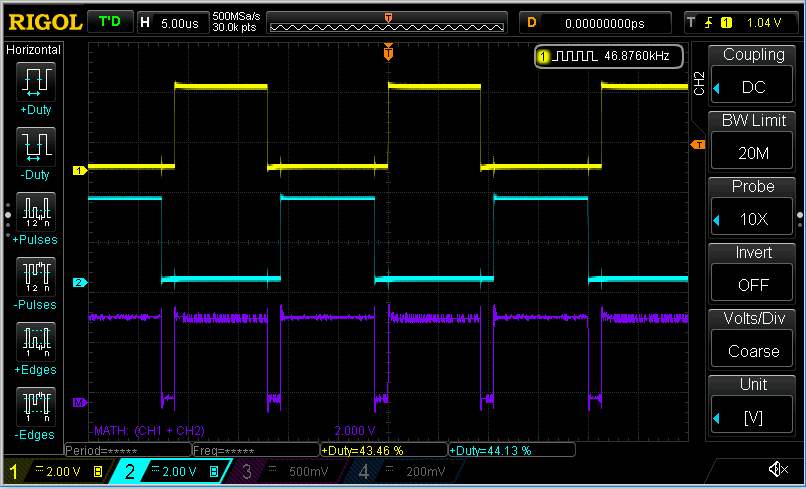

A PWM module for FPGAs that supports dead band.
A VHDL project that generates two opposite PWM signals with a dead band. You can change the duty cycle with a rotary encoder.
When you drive half-bridge designs, you need a control signal for both transistors in the circuit.
These signals need to be each other's opposite, because you close one transistor when you drive the other.
At the switching time, you introduce a tiny bit of dead time, to allow one transistor to properly shut before the other opens.
If you don't allow for this stabilisation period, your transistors will get hot and the magic smoke will eventually (sooner rather than later) escape.
I've made a VHDL module that generates these complementary signals, including a configurable deadband.
You decide in your design what the frequency and deadband is.
You can then freely change the duty cycle. The FPGA takes care that the dead time is guaranteed.

duty_i is a register that holds the desired duty cycle. It's configurable - I've set it to 8 bits.
Your clock speed is dependent on the size of this register.
The clock that you present on the clk_i input of the module will be divided by 2^(number of bits). In this case, 2^8 -> 256.
For the standard 12 MHz clock of the XuLA2, the PWM module will beat at 47 kHz.
There are ways to increase the clock frequency in the FPGA and the XuLA2 libs have support for that.
The dead band, in clock ticks, is passed via the band_i pin. The two complementary signals appear on pwmA_o and pwmB_o.

architecture arch of PwmDeadBand is
  constant MAX_DUTY_C : std_logic_vector(duty_i'range) := (duty_i'range => ONE);
  signal timer_r      : natural range 0 to 2**duty_i'length-1;
begin
  process(clk_i)
  begin
    if rising_edge(clk_i) then
      pwmA_o   <= LO;
      timer_r <= timer_r + 1;
      if timer_r >= band_i + TO_INTEGER(unsigned(duty_i)) then
  pwmB_o <= HI;
  end if;
      if timer_r < TO_INTEGER(unsigned(duty_i)) then
        pwmB_o <= LO;
        if timer_r >= band_i  then
  pwmA_o <= HI;
   end if;
      end if;
    end if;
  end process;
end architecture;

So the handover point is the 8-bit register accumulator_s. When you turn the encoder, it changes the value of the register to reflect your action.
In real-time, the duty cycle of the PWM module adapts. There's not a single clock tick between event and action.
