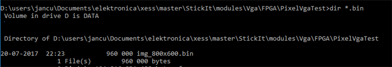

The result is a file that has 800 * 600 * 2 bytes. Checked with the file size:

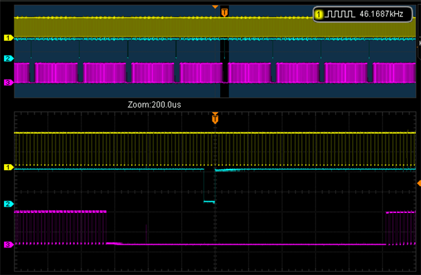

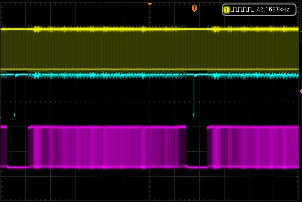

I will know that once I connect the kit to a TV. I've checked the VGA output on an oscilloscope.
I built and loaded the Xess VHDL example (I'll explain the steps in a future blog) and loaded the bitstream:
xsload --fpga pixelvgatest.bit
output
Success: Bitstream in pixelvgatest.bit downloaded to FPGA on XuLA2-LX25!
Yellow: HSYNC
Cyan: VSYNC
Magenta: one of the video signals
I hope to be able to show a TV screen with image soon. Hang on ...

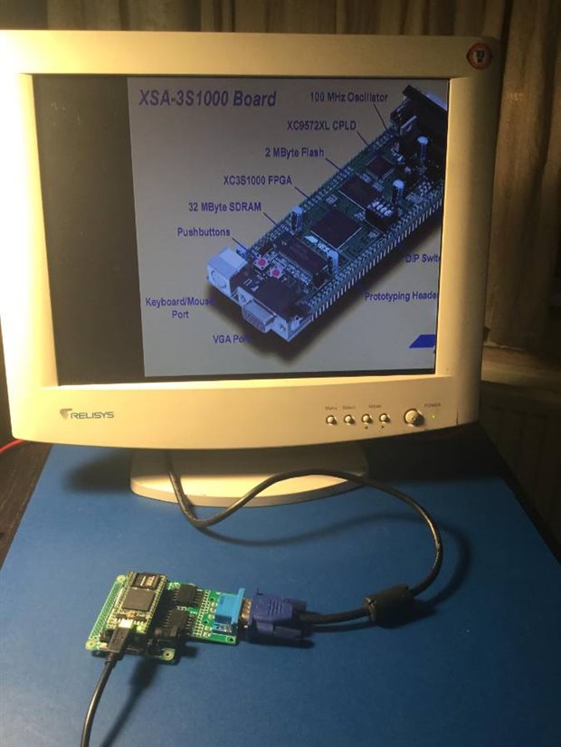

edit: I found a VGA monitor at a curb . Here's the image - only took me a year image.

    I finally have a VGA monitor. Here's the image. I have some position issues, but there's definitely an image coming out of the FPGA
    Jan Cumps over 8 years ago in reply to jc2048 +1
    I also suspect it's the monitor. There must be a reason why it's left at the curb. I maxed out both position and clock settings of the monitor. It only helped partly - maybe 10 % more to the left. The…
    I maxed out both position and clock settings of the monitor. It only helped partly - maybe 10 % more to the left. The monitor will be disposed of now - it served its purpose.
    The good news for my FPGA morale is that there is an image. It's like blinking an LED on an Arduino.

    Your waveforms look fine.
    I'd say it's the monitor that has the 'position issues'. Won't it let you adjust the horizontal position using the menus?
