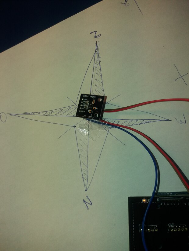

A few measurements, first flat on the table, with the text on the sensor PCB facing:
North:
BM1422AGMV XDATA=1.208[uT]
BM1422AGMV YDATA=-0.375[uT]
BM1422AGMV ZDATA=-76.875[uT]
South:
BM1422AGMV XDATA=-26.333[uT]
BM1422AGMV YDATA=-24.333[uT]
BM1422AGMV ZDATA=-79.417[uT]
East:
BM1422AGMV XDATA=-28.917[uT]
BM1422AGMV YDATA=-4.042[uT]
BM1422AGMV ZDATA=-80.917[uT]
West:
BM1422AGMV XDATA=1.333[uT]
BM1422AGMV YDATA=-26.708[uT]
BM1422AGMV ZDATA=-78.083[uT]

  • kulky64
    kulky64 over 8 years ago +3
    Have you tried to calibrate out hard and soft iron interference? Because from your data it seems there is some present. If you are in Belgium you should be getting total magnetic field of around 49 uT…
    Jan Cumps over 8 years ago in reply to kulky64 +3
    There is an iron molecule in my neighbourhood
  • kulky64
    Have you tried to calibrate out hard and soft iron interference? Because from your data it seems there is some present. If you are in Belgium you should be getting total magnetic field of around 49 uT with inclination of 66 deg. You can check magnetic field data for your exact GPS location at:
    https://www.ngdc.noaa.gov/geomag-web/#igrfwmm
    From your data I'm getting total length of magnetic field vector ( =sqrt(x^2+y^2+z^2) ) from 48.3 uT to 87.1 uT.
    kulky64  wrote:
    Have you tried to calibrate out hard and soft iron interference? Because from your data it seems there is some present. ...
    Today I’m going to try the sensor without the shield and away from the Arduino. I’ll check if their ground planes are interfering
    Jan Cumps over 8 years ago in reply to Jan Cumps
    Result, sensor horizontal, PCB print facing South:
    BM1422AGMV XDATA=-11.125[uT]
    BM1422AGMV YDATA=-16.917[uT]
    BM1422AGMV ZDATA=-84.333[uT]
    BM1422AGMV VECTOR=86.730
    With the sensor in exact the same location and direction, with the sensor on top of Arduino and Sensor shield:
    BM1422AGMV XDATA=-28.792[uT]
    BM1422AGMV YDATA=-19.625[uT]
    BM1422AGMV ZDATA=-81.875[uT]
    BM1422AGMV VECTOR=88.981
