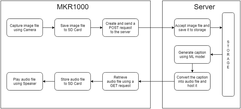

Today, we're happy that this system has finally come to fruition. The device, centered around the powerful MKR1000, is small, lightweight and user-friendly. All the user has to do is connect it to a portable power source, and it will automatically start periodically describing the surroundings to the person.
The following block diagram is a bit more refined, and captures the working rather nicely:

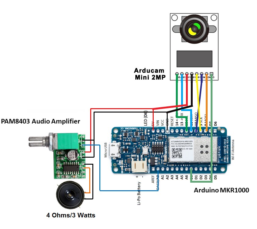

Here's the list of components that went into this project:
Components
Cost (USD)
Arduino MKR100034.99
ArduCAM Mini OV2640 2MP25.99
PAM 8403 Amplifier1.00
Speaker (4 Ohms, 3 Watts)
3.00
SD Card and SD Proto Shield
Total64.98

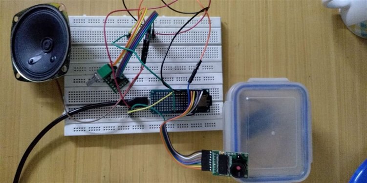

Final connection diagram -
Here's the finished prototype:

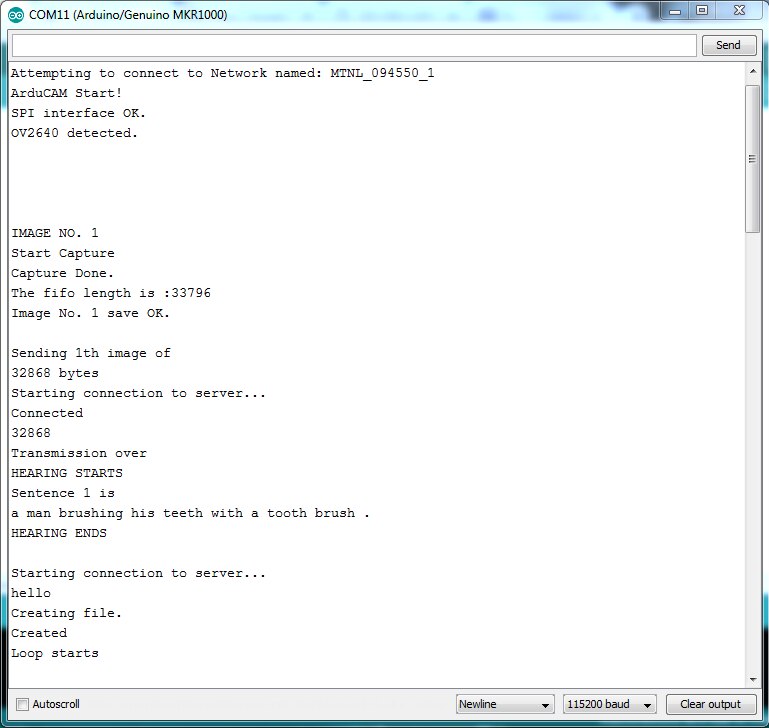

This is how it looks on the serial monitor -

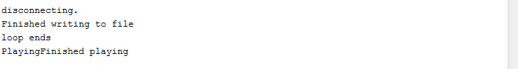

The audio produced is -

  Serial.print("Playing");
  // until the file is not finished
  AudioZero.play(myFile);
  Serial.println("Finished playing");
  delay(300);
