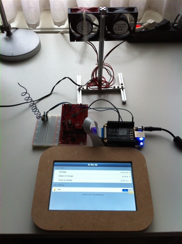

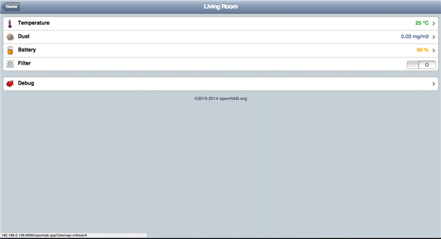

The central unit is based on the Beaglebone Black with a 7" BB View LCD touchscreen (week 2) running openHAB (week 5). The Beaglebone Black is connected to the MSP430FR5969 (week 16b) using their UART interfaces. The MSP430 is in charge of the timing critical task of sending signals over RF (433MHz) to power sockets in order to turn individual filtering systems on or off. The data received by the control unit is categorised, interpreted and trended over time.

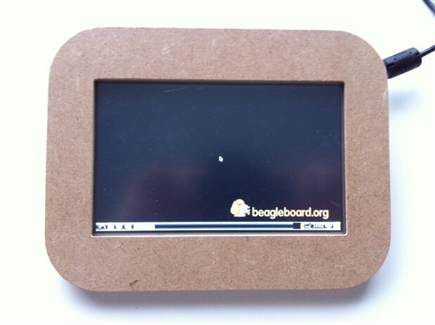

A custom enclosure was built to house the LCD touchscreen, Beaglebone Black and MSP430FR5969 with RF transmitter (week 16).
{gallery:autoplay=false} Control Unit

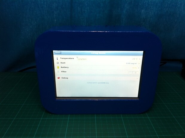

Enclosure: the control units enclosure assembled and painted

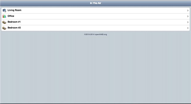

Home: the landing page of the application, providing an overview of the monitored rooms
Data Collection: collected data available per room, with a debug menu providing more detailed information

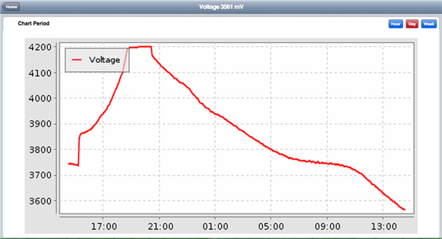

Graphs: graphs are available for every measured value in hourly, daily or weekly view

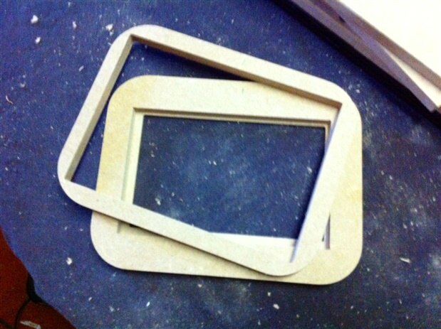

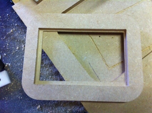

Enclosure: enclosure in the making
Enclosure: screen fits, but enclosure needs additional layers to contain all electronics
Testing: testing the control of a fan using the MSP430FR5969 and a 433MHz transmitter
Enclosure: making additional layers to create depth in the enclosure

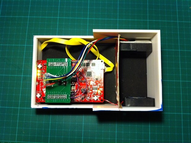

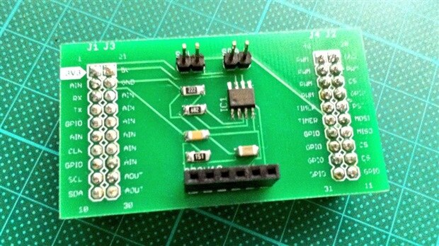

The remote sensor is built around the CC3200 Launchpad. Combined with a Fuel Tank and a custom dust sensor Boosterpack (week 13), it offers dust level monitoring, temperature measurements, battery information and solar charging. The CC3200 uses MQTT (week 4) to pass all the monitoring data to the control unit.

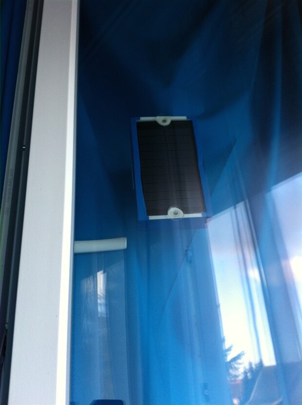

Remote sensor: Attached to window for solar charging

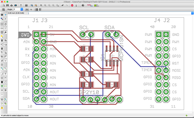

Boosterpack: board design
Boosterpack: fully populated dust sensor boosterpack

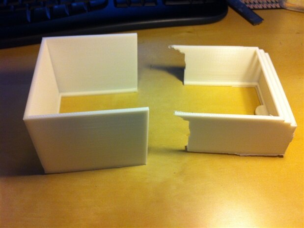

Remote sensor: my printer giving me trouble days before the end of the challenge

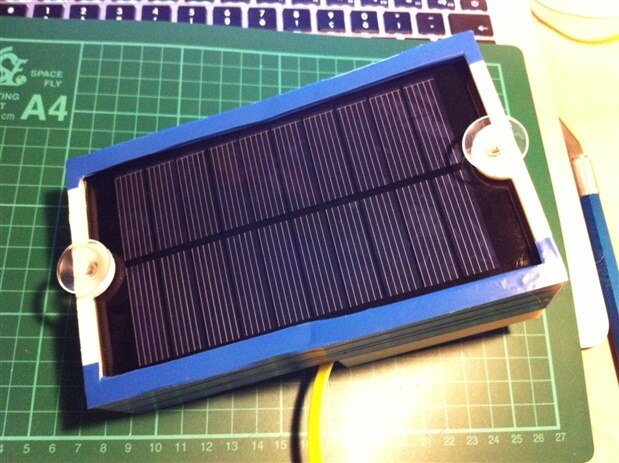

Remote sensor: solar panel and window suckers in place
Remote sensor: the "guts" of the sensor, with a separate chamber for the dust sensor
