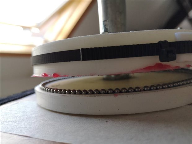

Do you remember in Art-a-Tronic Episode 4 I had to use the 3.25 mm diameter spheres from a bicycle freewheel as the last minute alternative to the 3.5 mm ones that were not delivered in time by Amazon? Well, then a thousand of spheres finally arrived. After two months of 8 hours a day torso rotation frankly I was expecting something critical in the 3D printed parts. Instead, I opened the mechanics and all the spheres wen to the floor. The plastic PLA parts were intact.
The new spheres thickness make the difference, as well as filling the entire guide. I also added some few technical vaseline grease in the rail of the spheres. This is the same grease you find to protect the nylon components in the plastic moving parts of many printers and scanners. It is not the first time I use it and I have already experimented that it is perfect for noise attenuation and had no corrosion effect on both the materials (metal and plastic).
Replaced the spheres and reassembled the body. And motion is perfect with 0.5 mm of separation between the two parts, as in the original design. Ready for at least other two months of motion.
