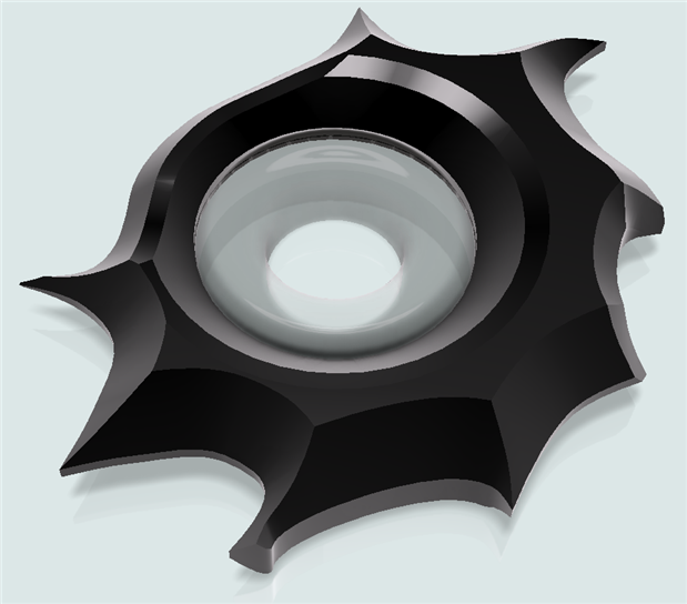

Starting from the mannequin head proportions I have designed the implant profile, then I have converted it in SVG format with Inkscape and, finally, used the profile to create the model with fusion 360 for 3D printing.
Above: the draft idea of the eye implant overlayed on the left side of the face; the size is conditioned by the dimensions of the NeoPixel 12 LEDs ring.
Below: the Fusion360 3D rendering of the implant. Note in the center the transparent toroidal ring that will be the front side of the NeoPixel ring.

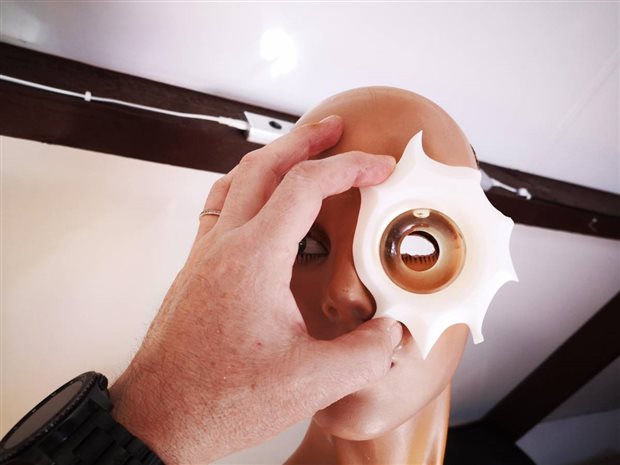

To complete the eye implant effect I initially decided to use a 12 LEDs NeoPixel ring; a second internal toroidal ring has been designed for this purpose, 3D printed with the Elegoo MARS LCD printer using transparent resin.
Below: the implant preview covering the left eye of 7 of 9 before painting and gluing the parts together.
To keep the NeoPixel ring in place to the back of the transparent ring another small support has been designed and 3D printed. Also after painting the result was technically good but aesthetically not very satisfying.
Anyway, I have decided to use it to see the real effect when put in place. As you can see in the above images the size and the internal transparent ring have a too hard impact with the face proportions,  and the transparent ring seems redundant. Thus I decided to redesign it with a reduced size.
