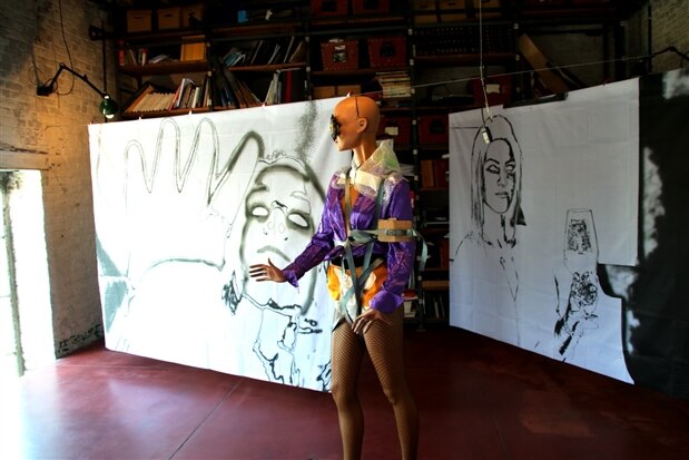

Starting by the evening of the 5th of April, 7 of 9 has been moved to the exhibition location. This has changed the roles for a while as it should remain active for two months while the development will go ahead.
Until the development is complete I have prepared a first beta version; the real limitation is the way I should manage the interventions, software updates, and the next steps of updates/upgrades. Another limit concern the updates to the software: as the automatron will run during the day, I can't leave a development phase in the middle; every change should be calibrated so as it is finished and tested it give another feature to the system without interruption. The same replacement of the left eye implant described in Episode 8 has been done in one hour, tested, checked the camera working then restarted the system with the changes in place.
With software additions and updates things are more complicated; if it is not well tested before, there is a high risk that the program crash, or hang with the system laying in an unrecoverable condition that needs my presence on-site for a physical reset.

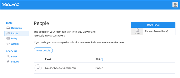

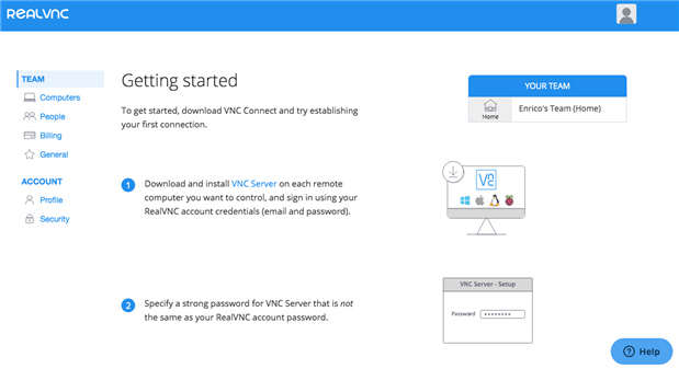

Step 2 - VNC Server and Remote Access to the PI
Accessing the Raspberry PI from remote on the same local WiFi LAN is not sufficient, it will remain alone in a different place from where I develop. To do this I have configured the VNC Server to be accessible from the Internet creating a personal team, free up to five computers to which I have added the PI.

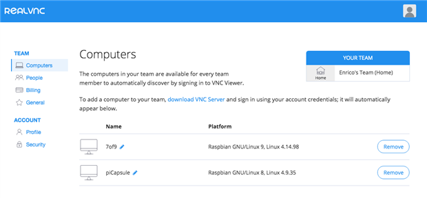

The RealVNC viewer can be easily set up as an online team, free for personal use. The steps to register are very easy and the advantages are countless;
Above: as your team appears after the registration.
Below: the list of registered computers in your team
Above: you can also invite via email other collaborators to join your team and participate accessing to the registered servers.

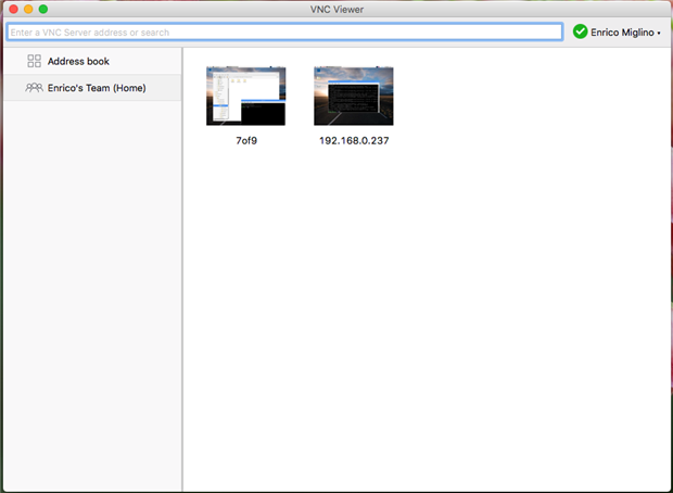

The image below shows how the list of available VNC servers appear after the registration and setup; the Address book will list the local servers (as many as you want), not registered in the team while the <Your team name> Team (Home) shows the list of (max five) servers accessible from remote.
As the VNC viewer client is available for free for any platform(Mac OSX, Windows, Android, iOS and Linux) the PI becomes reachable from the Internet from everywhere.
There is a potential issue on the desktop resolution when you start the viewer without any screen connected to the PI; the resolution is very low (640x480). You can change this value setting the resolution in the Raspberry PI configuration and restart the system. I have set a 1024x768 default resolution for comfortable use of the PI desktop from the VNC viewer.

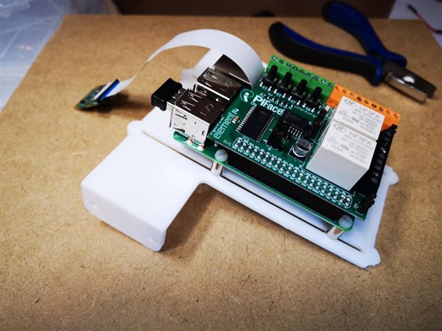

Step 3 - PiFace Digital 2
The setup of the PiFace Digital 2 board was another of the preliminary steps before leaving 7 of 9 going to the exhibition. I have already used in past this board so I was not expecting particular issues. I have installed the Python libraries and tried to test it – just to save time – without installing the emulator. Unfortunately, the board was nor recognized. I checked everything and everything was fine. I tried replacing the board with another I have here with the same result. Ok, step-back and installed the emulator. it worked!
The problem was just with the command line. A stupid command in Python as shown in the (poor, I should admit) documentation on the PiFace Digital 2 site.
Good: the board software is open source
Bad: it seems that the development is of abandonware kind. No one has updated the sources following the recent evolutions of the Raspian Linux.
To be honest, I also thought to an alternative solution of using the board (I need it at least for the relay availability); I have absolutely no time to clone the source repo trying to find the bug if any. unfortunately, there is a known bug that has not been solved yet. It is the case to say abandonware - sic - as on the GitHub repository the bug is the PiFace Digital Issue #36, opened on past 3 January 2018 (!!!) and still remain open. It is a blocking bug that I can suppose Element14 as a distributor is not aware at all.
Fortunately, I have not special problems switching (or mixing) Python 2 and Python 3 developments because there is a workaround but it is working only on the Python 3 version of the libraries.
The reason for the issue
The most recent Raspbian Kernels initializes the SPI serial communication to the speed of 125 MHz while the PiFace Digital 2 expect a default speed of 500 KHz but does not initialize this speed when it starts. This generates an incompatible speed in the communication protocol and the board is not recognized.
The workaround
The workaround worked but we should consider that some other issue may occur if using together with the PiFace Digital 2 another board communicating through the SPI protocol expecting without initialization the SPI new default speed. Despite this disquisition, there are a few changes that should be done to solve the problem.
  • Open a terminal session on the Raspberry and search where the spi.pi configuration file (Python 3) is located in your installation with the command find / -name spi.py
  • In a standard Raspbian Pixel installation, you can expect to find the file in this location:  /usr/local/lib/python3.5/dist-packages/pifacecommon/
  • Edit the spi.py file and search along the lines for the following part of configuration:
# create the spi transfer struct
        transfer = spi_ioc_transfer(
            tx_buf=ctypes.addressof(wbuffer),
            rx_buf=ctypes.addressof(rbuffer),
            len=ctypes.sizeof(wbuffer),
  • Now, modify the definition of the transfer struct that includes all the parameters for the default SPI connection protocol adding a line that forces the SPI speed to the desired value as shown below
            speed_hz=ctypes.c_uint32(15000)
Save the file and restart the system. Now the board should work.
