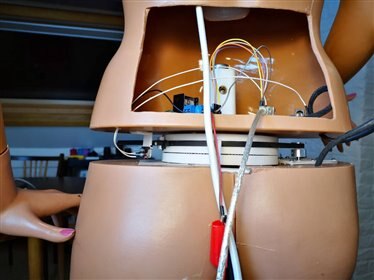

Above: one of the two cut part to the bottom of the belly. The only other part I cut was the back of the head, hosting the Raspberry PI brain controlling all the body behaviors.

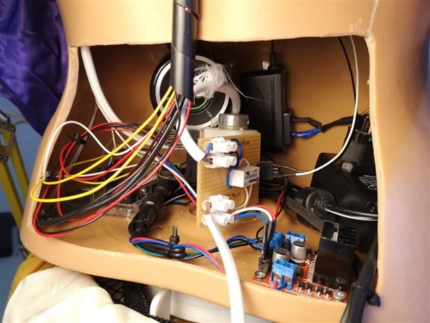

This is the case when an image is worth than thousands of words.

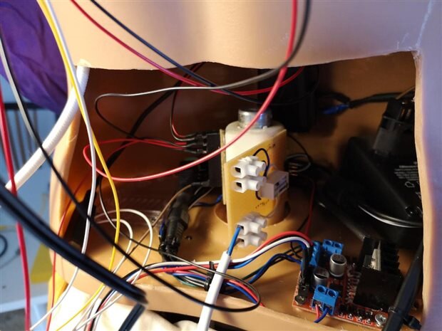

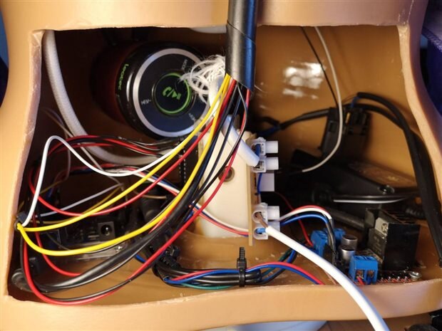

On the left side of the torso base, I fixed the Arduino Uno – covered in the above image by the connection wires – and on the opposite side, I connected the L298 motor controller board, the red PCB with the blue screwed connectors in the image.
The motor controller board is powered by a 2,5 A power supply hot glued to the right side, near the controller.
As the controller also provide a regulated 5 Vcc output I have created a small power rail where to connect the sensors and other components with a small PCB glued to the torso rotating support, easy to access by the connectors.

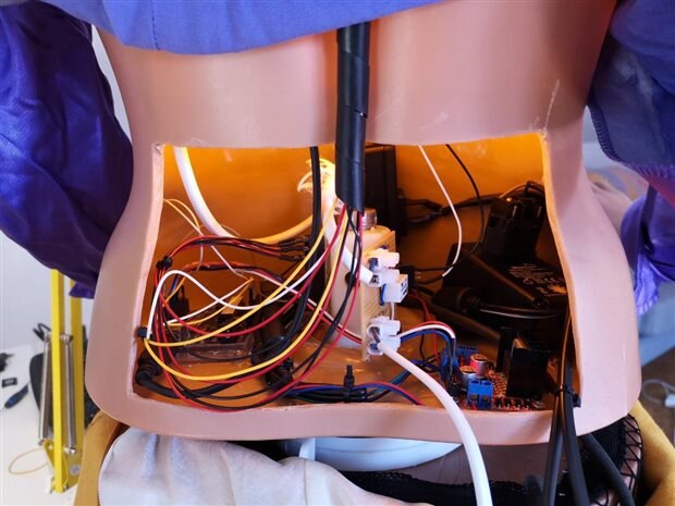

The Fire Light Lamp

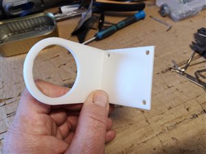

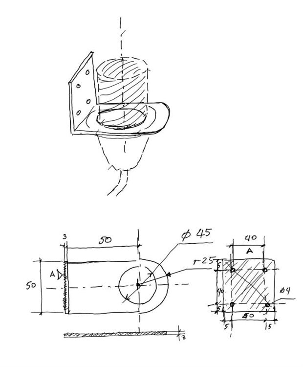

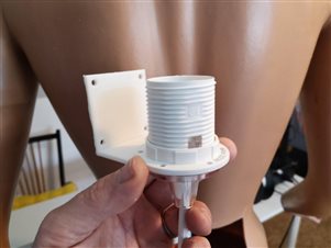

The fire-light lamp is fixed by a custom designed the 3D printed support, locked with two Allen screws about to the middle of the back, internally to the body; when the light is on it creates a suggestive effect of “pulsing heart on fire” visible in front of 7 of 9.

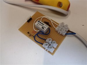

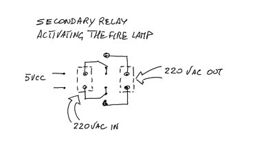

The initial idea was to power the lamp by software with one of the two PiFace Digital 2 relays. Unfortunately, the PiFace relays can drive max 30V devices, while the lamp operates at 220-240 Vac. I have solved the problem using a 5V powered relay by Finder that can drive up to 300 Vac. The model is listed in the attached data sheet.
The resulting wiring will be a chained relay: the Pi face relay, when switched on powers the Finder relay with the 5V available on the PI that closes the 220 VAC circuit and power the lamp. The relay circuit and cabling connectors were glued to the other side of the central shaft support using another small PCB.
Above: the relay PCB glued to the shaft. To the opposite side, you can see the power rail for the sensors, getting the current from the regulated 5Vcc of the motor controller.

Also, the Raspberry PI should be part of the internal supply chain. The below image shows the PI power supply glued to the belly, to the right of the audio box.
And also this second power supply has been hot-glued to the front-bottom side, corresponding to the internal side of the belly of 7 of 9.

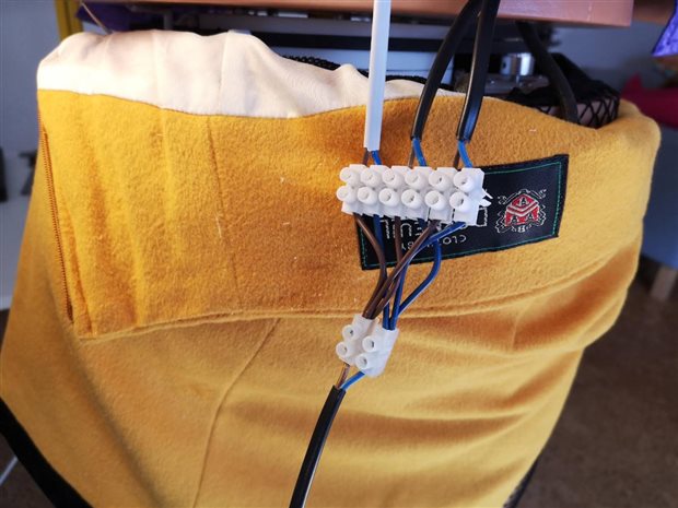

As I want only one high voltage power supply going outside to power all the building, the internal high voltage lines have been connected using a group of Mammut fixed to the back cover, as shown in the images below.
