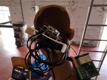

The MDK in Practice

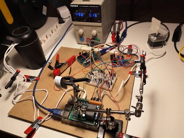

Let me spend only a few words on the development kit. I have just re-created the electronic part of the architecture on the bench; this resulted useful for the creation of the new components and making software upgrades as the original oper lives at Art-a-Tronica exhibition, but not only. It was just spending time seeing how the parts I have already done were working that I have focused the steps ahead, keeping coherence with the project and trying and testing the best solution.
As shown in the above image, all the parts of the project are already connected: The raspberry PI with the camera and the PiFace Digital 2 board, the Arduino, the two left and right microphones, the motor controller and the stepper motor and the audio out. To emulate the motor end-stop switch I have used just a temporary switch button. Connection testing is done using a small breadboard.

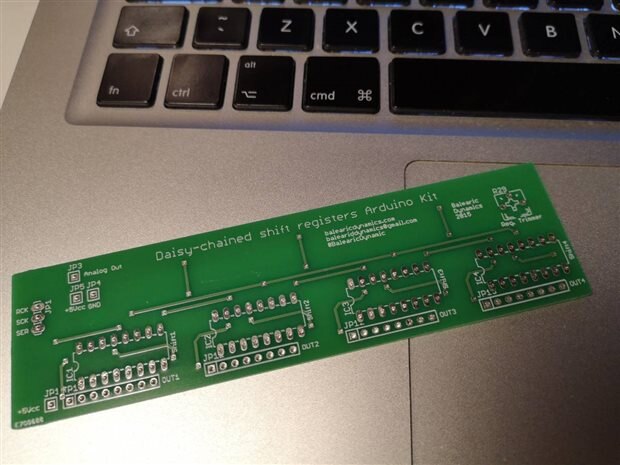

The first approach was to use three other pins of the Arduino and a shift register. I have also developed in past a Multiple Shift-Out Registers for Arduno, including the board and PCB.
Some of them are already here around and I have plenty (some hundred) of shift registers, so why not? The naswer is simple: because as much a solution is simple, as much it is elegant. I am not a fanatic of the hardware redundancy and if I can reach the same result with less stuff, the solution is better. And everything was under my eyes from the starting of the project. The PiFace Digital 2 board has eight open-collector pins while I use only one (pin zero) connected to the relay for the internal Burning light. So, also thanks to the particular shape of the Eye implant, 7 LEDs are more than sufficient (I should admit that it will be impossible to place more than seven LEDs without using SMD components).

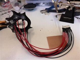

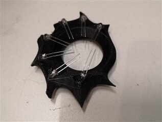

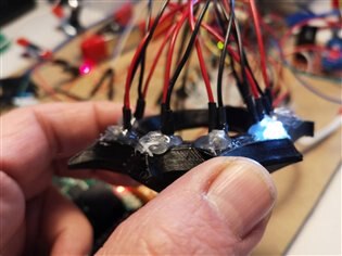

The seven LEDs have been hot-glued to the seven curved vertices of the eye implant: the 3.5 mm LEDs fits perfectly. To get the better effect – also considering the multicolored environment of the character – I have used clear white high-intensity LEDs and a 68 Ohm limiting resistors (calculated values for the LEDs).

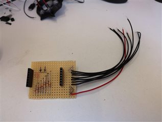

As mentioned in a previous post, all the electronics and wiring has been conceived to be relatively easy to modify and upgrade, repair, etc. Also, in this case, the wires of the eye LEDs have been set to connect internally to a small PCB with the pull-up resistors; all the positive wires (red) are collected to a single cable to be connected to the PiFace Digital 2 +5V while the seven ground wires (black) are connected to the remaining seven open collector pins of the PiFace Digital 2.
As shown in the short video below, the bench test worked well and the light motion effect shown is expected.

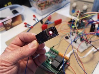

Another light feature added to the head is a laser, the light arm of every Borg. I plan to use several sensors together to the laser next weeks so I decided to buy a set of sensors all-together. I got a 37 sensors package from Elegoo and I should admit that it was a very good selection. Excluding a push button (maybe 36 was a bad number?) all the other components were very useful.
Hardware

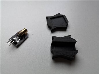

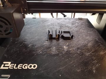

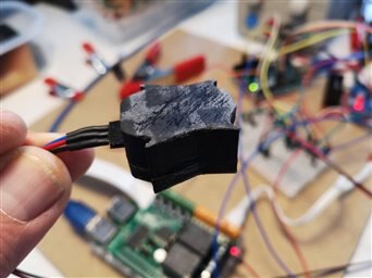

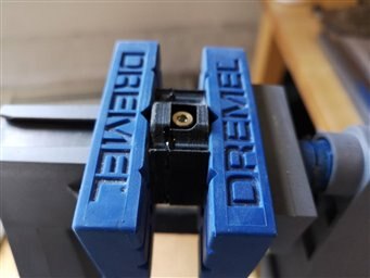

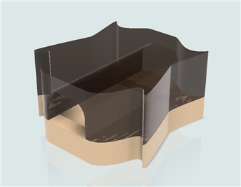

I designed a small case to host the Laser following the same style of the eye design and 3D printed two shells to include the small sensor.
The images below show the assembling sequence and testing of the device.
The laser sensor is controlled by Arduino through a PWM pin so it is possible to vary the intensity of the emission. The small collimation lens can focus a 10 square cm at a distance of about 10 meters.

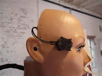

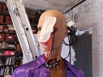

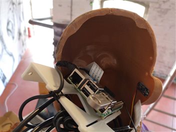

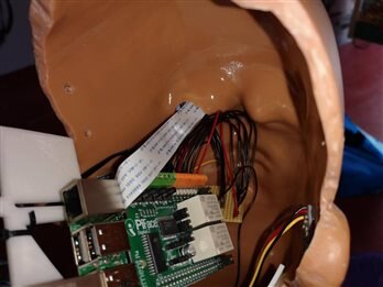

Installing the Updates
After setting the software on the test bench and completed the hardware, the last step has been adding the components to 7 of 9. The images below show the sequence of the update.
The short video below shows the suggestive effect generated by the new components.
