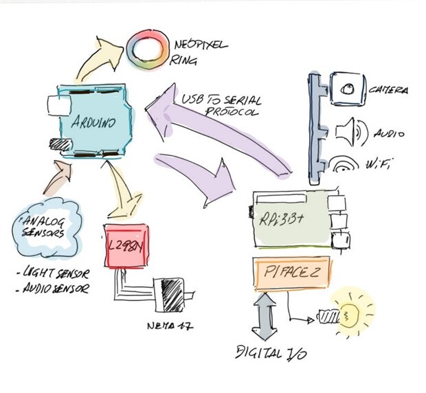

In this fifth episode of the Art-a-Tronic Picasso challenge, I have finished the torso motion with Auduino. At this point, before going in depth in the details, it is important to see the global design of this antenna. I apologize to not reveal the global idea but when I started there was a member of incognita I were not sure how to solve. Until I have not opened (surgically, obviously) the mannequin it was not clear of the internal space, structure robustness and thickness, and other variables.
Now the roles between the Raspberry Pi3 B+ and the Andrino board are almost clear. to be fixed in an approximate scheme. If these posts will surprise you, consider that many steps involve a level of uncertainness and some choices need improvisation.
As shown in the scheme above I have decided to split the control of the automa (or droid? Or Borg? or simply mannequin? No idea) in two parts because of some tasks are better if delivered to a microcontroller instead of the Raspberry Pi itself and because I need to manage also some analog signals.
In the Meantime, at Depot09...
Components Roles
Arduino Role
  • Control the lights of the NeoPixel ring
  • Control the torso rotation
  • Control the environment light intensity
  • Control the environment audio level and direction
The Arduino functions are called by the Raspberry Pi 3B+ through a USB-serial connection and a set of single-character commands. In the first experiments, I used an Arduino UNO R3 but I will definitely use an Arduino MKR 1010 so some behaviors of the mannequin can be controlled remotely through the Arduino IoT cloud.
Raspberry Pi 3B+ Role
The Pi act in this context as the brain of the system. It receives information from Arduino controlling the responses depending on the visitors and environment changes and interactions. For example, when a higher loud level is "heard" by one side, the torso will rotate to this direction until the audio level is balanced between left and right, as much as possible.
In the meantime, the Raspberry Pi will stream online the live camera replicated locally on a 5 inches HDMI display, part of the equipment of the Borg. To be honest, the mannequin is not a Borg but it will have a number of Borg-like technological implants.
The other way the Raspberry Pi 3B+ can interact is speaking sentences through the audio output and an amplified speaker. Moreover, when some condition occurs, the robot can express increasing her emotions.
The effect is created by a flame-simulating lamp inside of the torso controlled by one of the two relays of the Piface Digital 2 The system also detect when a user or an object is too near to the body thanks to a PIR sensor connected to one of the I/O pins of the Piface Digital 2.

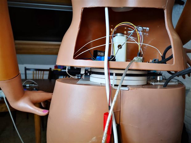

Auduino Motor Control

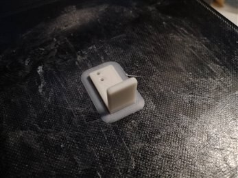

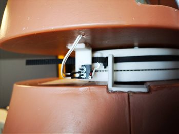

The mannequin, when the transformation is complete should operate alone at the Art-a-Tronic exhibition. This means that I should take care that the system can run autonomously many hours. To be sure that rotation will start well after its daily power-on I have added another couple of 3D printed components to support an end-stop switch to reset the motor position. Accordingly, to the design, the torso will rotate 60 DEG with the mid-point at 30 DEG

The part of the software described here refers to the stepper motor control. As the movements will be controlled by a command set I have developed a series of functions to execute all the movements, including an initialization function. The initialization function search for the 0 DEG position corresponding to the end-stop switch, then execute a complete left-to-right rotation test and complete the cycle positioning the torso to the mid position.

The initialization function SetTorsoZero() is emblematic as it includes the structure settings, as well as moving the motor for the testing cycle. You can see that the approach is to set or change one or more parameters then call the moverTorso() function.

The fire-simulating internal light, expressing emotions, has not been yet connected to the Piface Digital 2 relay but is fixed installed in place, inside the torso.
The video below shows the effect of testing the lamp inside the body.

    genebren over 7 years ago +5
    Looking good (except for the picture with the missing eye, that was kind of creepy). The stepper motor seems to hum throughout the mannequin, have you thought of some sound deadening material? Keep up…
    balearicdynamics over 7 years ago in reply to genebren +5
    Hello Gene, about the loud, considering that the body does not move compulsively but has a certain logic, can be reduced but I have kept it just because it is part of the scenery. To be honest, I have…

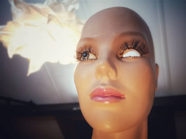

    dubbie over 7 years ago +2
    Enrico, I was watching the first of your videos and thinking 'are her *** lighting up?' and then thought surely not, must be some external lighting effect. Then it turns out you had installed internal…
    dubbie over 7 years ago in reply to balearicdynamics
    Enrico,
    I look forward to seeing these eyes installed and being realistic.
    Dubbie
    balearicdynamics over 7 years ago in reply to dubbie
    Dubbie,
    it is what I thought but I have not tried to find it... A realistic eye is the worth, totally different than the classic Halloween ball.
    So, to make the story short, you have convinced me and I decided to give a try.
    Includes the support on the back, not stupid red veins and very nice.
    Enrico
    Enrico,
    I understand now why the eye was missing. I am sure you will come up with something good.
    One animatronic head that I was associated with (regretfully none of it was my design or construction) used prosthetic glass eyes, which look just like the real thing. Below is a link to actual glass eyes
    https://www.bbc.co.uk/news/magazine-17126713
    but these would very likely be very expensive. I am sure that there must be cheaper alternatives. It was some years ago now but I was shown a catalogue of several pages of different types of artificial eyeball, all different colours. When two eyes were installed in the head, which was just a wire frame outline and connected to move up/down and left/right using servos, it was freakily realistic. As people we are obviously attuned to look for the eyes in a face and can blank out the rest of the face or non-face as in my experience.
    Dubbie
    balearicdynamics over 7 years ago in reply to DAB
    Hello DAB,
    as I have already told to genebren I am not sure if I want. The camera grabbing images very near to the movement and the body full open makes a louder effect than normal. Then, in a normal context, this is the sound of the robot, and it is not moving continuously. This is a potential issue that I will eventually solve at the end of the project. For now I leave it then I will see if the loud is too high.
    One of the next videos I will try to make a test from a reasonable distance and see what is the result. Sure rotating the base vibrations are transmitted and amplified to the bottom.
    Enrico
    DAB over 7 years ago
    You are making good progress.
    You might want to add some insulation to damping the motor noise.
