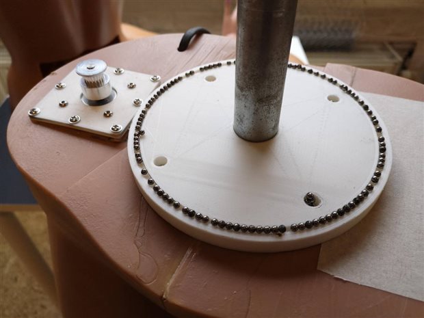

In this fourth episode, we see the completion of the torso movement of the Art-a-Tronic mannequin. The solution adopted seems working fine with good mechanic stability. The only problem was finding a way to get fast a considerable number of steel spheres to make the Lazy Susy bearing support; unfortunately the Amazon order of the 3.5 mm diameter 1000 sphere set has been delayed and I can't expect to be delivered before next April, 15. I thought what is the mechanism that contains this kind of spheres, cheap and easy to disassemble then finally I solved it in a sport mega discount. At the ridiculous price of 7 Euro, I bought two freewheels replacements for bicycles. Not difficult to open it with the Dremel metal cutter and like magic I have found the treasure: some hundred of 3.5 mm diameter steel spheres. Let me show you how I have completed this part.

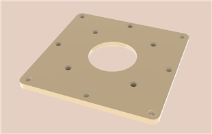

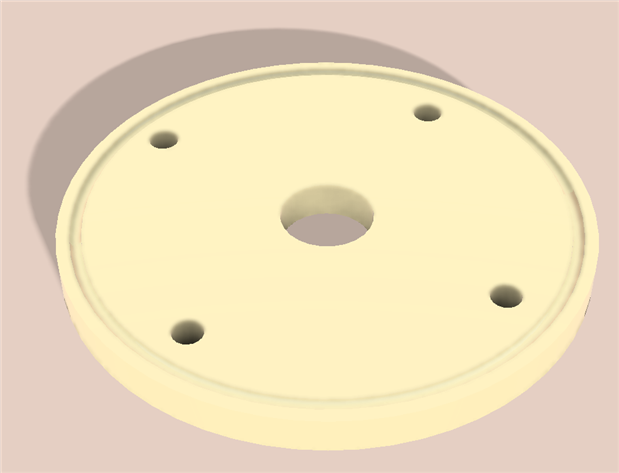

As already mentioned in the previous post, the 3D printed part has been designed with Fusion 360.
The two above images show a more detailed rendering of the stepper motor support discussed in the previous post.
The base

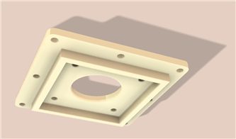

The base of the rotating support has four holes to keep it in place with the central hole of the same diameter of the mannequin shaft. the engraved guide on the internal diameter of the base is 3 mm depth; it is half of the Lazy Susy bearing guide. The rotating support has the same to keep the spheres in place.

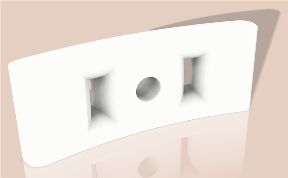

As the rotation of the torso is not complete, the teeth belt does not need a 360 DEG full revolution, so the belt is fixed to the rotating plate by a clamp to keep the teeth belt with the right tension.

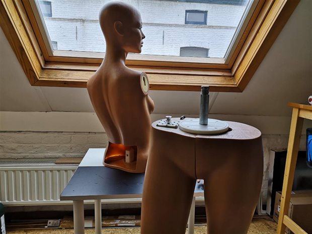

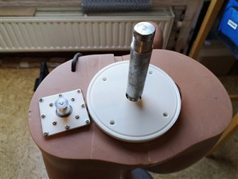

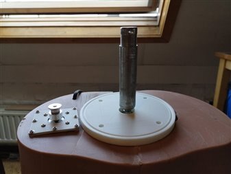

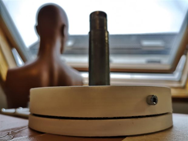

To assemble the base has not been too complex; as it is impossible to use nuts in the internal side of the legs I have used parker screws. The height of the base has been calculated to have the rotating part at the same height of the teeth pulley on the motor shaft.
I met some difficult to center the 3D printed base to the shaft; as shown in the above images, the base of the shat is a threaded bar about half of the diameter of the shaft.

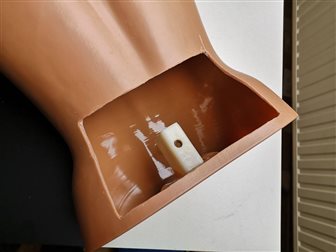

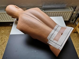

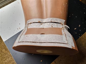

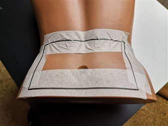

The further step has been to cut the bottom of the torso to be sure I was following the right assembly procedure. I never had seen how the interior of the mannequin body is built. Frankly, I never saw the interior of a mannequin. This surgical operation revealed that the body is 5 mm thick; this measure influences the length of the locking screws of the rotating support.
At this point, it is time to test the fixed base with the steel spheres.
The design was right and the Lazy Susy bearing works as expected.
The Rotating Support

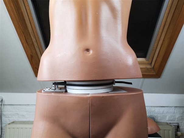

The images above show how the teeth belt is fixed to the rotating platform with the clamp. One of the two sides of the belt is locked with a cable tie while the other side is locked closing the clamp when the belt has the right tension connected to the motor pulley.
All the parts fit perfectly and motion is smooth. Next episode, the motor in action!

    balearicdynamics over 7 years ago in reply to dubbie
    As a matter of fact no. Important is to calculate correctly the dimensions.
    Top and bottom engravings in the design are from a torus 3 mm diameter. Balls are 3.5 So as a matter of fact, when the two parts are one pressed over the other there is about 0.4-0.5 mm open. That is just what is needed to give smooth motion and to keep the balls in place. If needed / possible you should lock the upper part with a top ring on the shaft. Here I can't so in case of an earthquake, maybe the torso goes away and the balls are lost. I am thinking on how to fix the torso with a locked on the top of the shaft. But in this special case mechanics is strongly constrained by the "ancient' features of the vintage subject.
