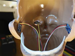

The last assembly effort was finding a way to fit the Raspberry and the PI camera together with the "ears" inside the reduced space of the head. Then, I can finally close and dress 7 of 9. In this episode, I will show how I have completed this last task before moving to the software configuration and programming the boards.

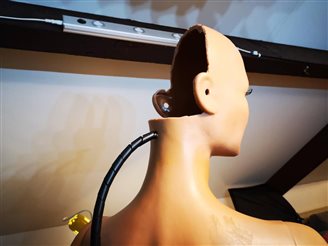

The image below shows how I cut the head to save the front-view of the face, with the best possible access to the interior of the head.

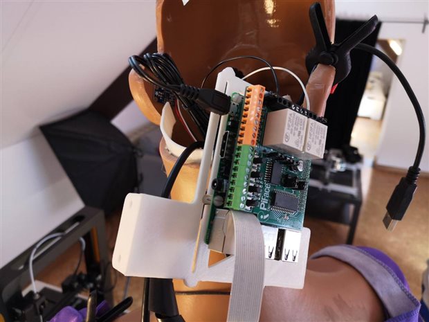

The Raspberry PI 3B+, the "brain" of 7 of 9, should be installed inside of the head near to the left eye where the implant hosts the PI Camera. Finding a solution to assemble the interior of the head in a so reduced space I experienced how incredible engineering designs should be the implants of the Borg technology!
The connectors on the Raspberry Pl are distributed along three sides, respectively:
  • USB Ports to the front shorter side
  • Power connector to the left side
  • PiFace Digital 2 relay connectors to the back side

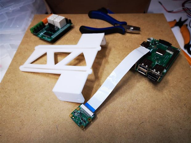

Designing the Rail Support

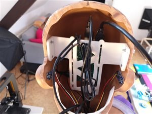

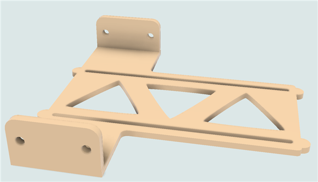

As the Raspberry PI can reach a reasonable temperature (average 40C when working), I considered avoiding to fit the board glued or wired somewhere to the internal sides of the face.
The best solution I found is to keep the Raspberry hanging in the center of the head.
For this task, I have designed and 3D printed a support to screw the Pl on two rails centered to the head internal space. Thank this solution it was sufficient using only two couple of Allen screws to keep the rail in the mid of the head meanwhile the PI has a good air circulation without the need of a fan.
Above: the Fusion360 rendering of the support rail to keep the Raspberry PI in the center of the head.
Above and below; The 3D printed rail support with the Raspberry PI screwed on it. The form factor of the support makes possible to position the PI at the best height and is easy to move it for maintenance and update, plugging the connectors, etc.
Assembling the Brain
The images below show the sequence of positioning of the Raspberry PI fixed to the support, inside the brain.
What is the White Band Glued to the Neck?
To see is more in detail, take a look at the images below:
It is the cut part of the head support. I have drafted the profile of the cut part; then, from the draft, I have extruded it 3 mm thick and 3D printed. Using 20% only of fill percentage the 3 cm height band is almost flexible to perfectly adapt to the internal profile of the neck where it has been hot-glued. To make it easily removable I have hot-glued only in three points the removed part of the head and - at least this is the plan - the top side will be kept firmly with an original headband.

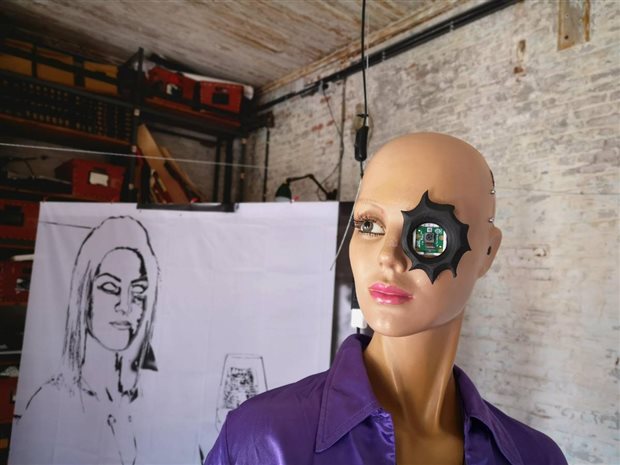

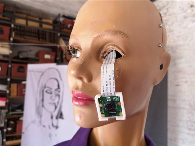

The New Eye Implant

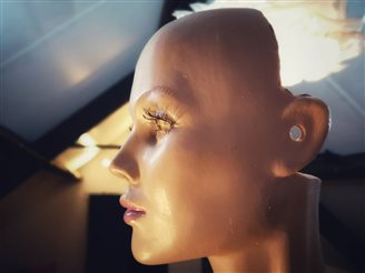

As discussed in Episode 6 with dubbie the original implant is not definitely viable, so I reduced the design by 75% and removed the NeoPixel ring leaving only the PI camera.
As you can see in the two above images, in my opinion, the effect is definitely better with good proportions and letting the camera circuit exposed contribute to accentuate the android effect.

    DAB over 7 years ago +4
    I like the eye fix, though you might want to add a filter over the camera to disguise the camera a little. DAB
