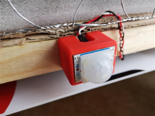

As the carousel will detect the human presence through a PIR motion detector, together with the four supports I have also designed a small box for the PIR as shown in the renderings below.
The images below show some detail of the final result.

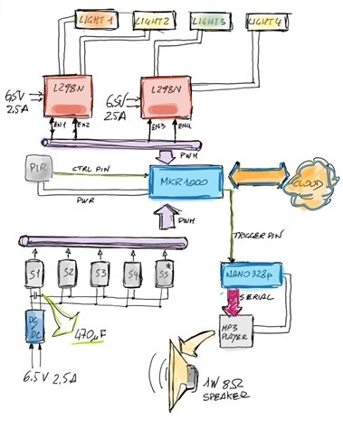

Revisiting the Technology and Upgrading hardware

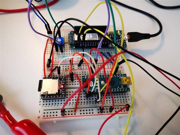

The first version of the carousel has been developed around the features of the BBC micro:bit. Two key aspects imposed to replace the original board with a couple of Arduino: adding new features to make the project complete (I discovered later I missed something essential) and adding connectivity and IoT capabilities to the carousel cage, as well as different kind of interactivity that should coexist together.
To avoid excessive complexity, after experimenting with the limits and incompatibilities of some Arduino libraries with others, I decided to split the architecture in two separate parts:
  • Arduino Nano 328pArduino Nano 328p to control the carousel music (that revealed a relatively complex software)
  • Arduino MKR1000Arduino MKR1000 to control the servos, WiFi connectivity, and IoT data via the MQTT protocol (and more, read below)
In addition, I had to use two separate power supply lines and a DC-DC power regulator. The scheme below shows the architecture of the carousel components and wiring
The four light spot – every light is built with six high-intensity white LEDs – are mounted on four micro servosfour micro servos to continuously change the spot direction. Lights are powered by 6.5V 2.5 A power supply, while their intensity is controlled by four pins (one very light) by four MKR1000 PWM signals, connected to two L298N half bridges. The same 6.5V power line power the servos through a DC-DC power regulator, to avoid powering the servos with a current higher than 4.5V. Note that the 470 uF capacitor is used to filter the current to the servos and avoid unwanted vibration when a specific positioning angle is sent. The servos signal instead is controlled by other six PWM pins on the Arduino MKR1000.
The carousel activity is started by the PIR motion detector (My Elegoo sensor kit seems endless image ) or by the Seven Of Nine Raspberry PI 3B+Raspberry PI 3B+  remotely through the MQTT protocol on the WiFi LAN.
Using a very cheap microSD mp3 player I have programmed an Arduino Nano to control all the features of the player through the serial interface (the most complete available on the mp3 player). The player also includes a microSD card reader where I put a series of classical carousel samples. The Arduino Nano can execute a series of automatic player functions when a pin is triggered – in our case by the MKR1000 board –
The player includes a low power amplifier that can connect directly to a less than 1W power speaker, as well as a couple of earplug outputs.
Making the Sound Loud
To reach the necessary power without adding an amplifier, in-style with the carousel features I have designed a passive amplifier, one of those cones just used to make the music loud thanks to the physics of sound. In this context we don't care about the quality of the sound, it is not needed a HiFi sound output but an outdoor carousel music simulation. Below the render of the loud cone and the 3D printed version.
Above: the testing prototype of the Arduino Nano connected to the mp3 player and the MKR1000 controlling the system
The video below shows the first test of the loudness amplifier with the Arduino Nano prototype. After the first couple of hours writing the software and going ahead to complete this part of the project, I have also added a 4.7 K trimmer to the Nano analog input to set up the maximum output volume of the music...

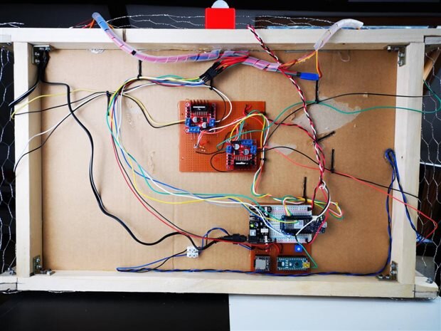

Few Words on the Software
The software setup of the Arduino Nano is detailed in the CarouselSound sketch. For this subproject, I have created a dedicated GitHub repository including the rendered images and the STL components described above. As a matter of fact, this project is part of the features extensions of Seven Of Nine (the main subject of the Art-a-Tronic project) but can be developed (or inspire some new creation or hacking) as an IoT stand-alone project itself.
Above: carousel bottom view with the implementation of the electronics and wiring. From top to bottom: PIR sensor (exposed), L298N light controls, the Arduino MKR1000 and the Arduino Nano with the mp3 player.
To integrate the carousel I followed two steps, creating three different sketches. The first version – can run on any other Arduino like the UNO R3, Mega, etc. is the control software. To make all the parts (servos, rotating wheel, sound triggering and lights working together I had to set a loop() function of the sketch as event-driven. This approach (also available on the mentioned alicemirror/Carousel GitHub repository) is a well-known methodology to control different and concurrent events on the same microcontroller I have already used in other cases and in my opinion the most efficient approach when for some reasons there are limitations using interrupts.

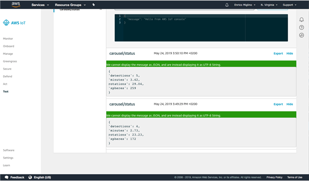

Cloud Integration and Borg Assimilation
After the experience with the Arduino IoT Cloud and the strong limitations met with the Beta version of the platform (based on the AWS IoT) – and also considering that I already own an AWS account by years, as well as an EC3 machine, some virtual storage disks and other AWS stuff – I have decided to enable the carousel on the IoT cloud using the AWS IoT platform.

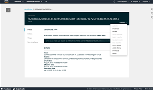

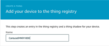

This solution revealed the best choice and, as far as I have tried until now the AWS IoT remains the most versatile and performing IoT cloud platform I ever used.
I moved directly to the IoT thing creation; I tried to see some tutorial available online on how to set up the platform and I should say that I strongly discourage to try to follow some of them. The real problem is that the AWS IoT is growing fast, and continuously evolving; if you are not so lucky to find a very recent tutorial probably it is out of date. By the other side, AWS is updating contextually to the changes the large documentation and series of examples and how-to you can access directly from the site so it is definitely the best way to approach the system.
Above: the entry point for the AWS IoT (after registering and setting your credentials) is the creation of a thing, in this case (right) the carouselMKR1000 thing.
Below: the ARN (Amazon Resource Name) and the other information related to the thing. This is the identity card of your thing inside the AWS cloud. To the right, how the thing certificate (used to identify in the program your IoT cloud object as it appears opened by the certificate reader on the PC.

Every time a request is sent to the MKR1000 the current state of the counters is converted in a Json object and send to the broker. Below a screenshot of what is published on the AWS IoT cloud
