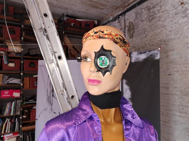

A Voice for Seven Of Nine
Seven Of Nine should be able to communicate to the Internet but I avoided to have a sort of permanent connection to the cloud creating another Alexa-like engine. This (sort of) Borg should have its own character possibly following a coherent logic in all the parts; for this reason, I decided to exclude any kind of text-to-speech software to generate sentences. I followed a more complicated approach but as far as I can see, the result is not so bad and the possibilities are limitless.

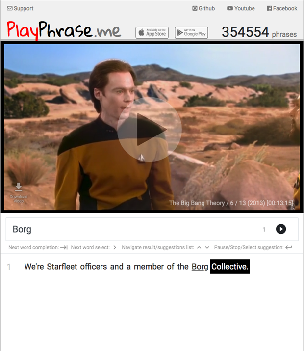

Coherently with the design of the animatronic and the environment with which it reacts and interacts Seven Of Nine speaks using sentences from film, TV series, videos and more. The initial difficult has been finding a method to develop the set systematically: after searching on the net, a great help come from the site playphrase.me where you can search by word or sentence over 350k short pieces of video that you can download. Better to take a try than explain how it works.
But this was only the first part of the job. After selecting a set of phrases (but the list is growing), I converted every video sequence to its corresponding .wav file, cleaned, equalized and then finally saved it in the format Text01.wav ... Textnn.wav Every sentence is also included in a constantly updated index document to make easy programming the audio composition algorithms.
The most updated list of phrases and the PDF index file are available under the Phrases folder of the mannequin GitHub repository.

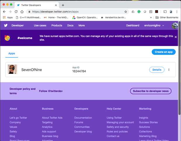

Register a Twitter Account as Developer
To be able to manage Twitter from a program you should have a developer certificate sent to the server; this is an easy sequence that can be activated with any Twitter account at the address developer.twitter.com
The path to follow to create your own app (or more than one) is well explained after you register your account as a developer and there are many tutorials on the network explaining the process step-by-step. What is important to know, is that after creating your Twitter APP you are provided by foud keys, all indispensable to access the Twitter APIs (directly or through a software library). In my case, I have used Python so the best solution is saving the keys provided by the Twitter App in a text-only Json formatted file.
Your app keys are unique and secret so you should not share them, e.g. on a GitHub repository.

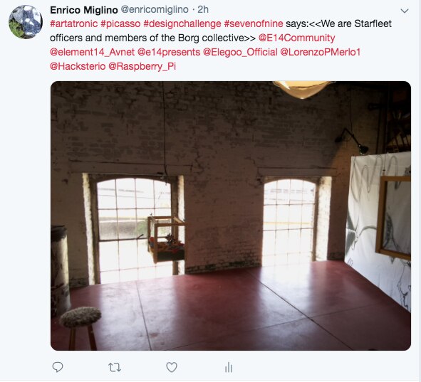

Thanks to the class library that pragmatically manages all the dirty job of initiating the twitter communication, connecting and sending the tweet message, the Python command to send periodically tweets is very simple and the library can be reused by other Python commands that will use Twitter messages in other contexts.
#!/usr/bin/python3
from pyclasses.twitter import SevenOfNineTwitter
from picamera import PiCamera
tweet = SevenOfNineTwitter()
tweet.connectTwitter()
camera = PiCamera()
camera.capture("/home/pi/images/twitter.jpg")
tweet.tweetGeneric(True)
The command before calling the SevenOfNineTwitter class to send the tweet captures an image, overwritten always with the same name. the tweetGeneric() method of the class to the rest. Also, this command has been added to the crontab scheduler to execute recursively. Below some examples from my account Twitter feed.
