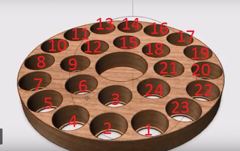

               -> I wanted to make a command to load the spice in the platter: 'Ok Google, load <some spice name> into < some jar location>' I could not figure out or find a way to have the assistant capture the whole phrase and then allow me to programmatically get the name and location from the actual command.
     - Sometimes you need to make sure you enunciate you words, 'Spice of Pi' was sometimes interpreted as Spice of Thai, which apparently is a Thai restaurant about 2000 km from my location. I wonder if they deliver...
     - English words...  Thyme and time sound the same.
All in all, I found the Voice kit to be a fun tool to use in this project.  As time goes on it can only become more capable and easy to program for.

#in this next line the first parameter is the servos actual GPIO number, not the servo number.
 # servo 0 would be 26
 # servo 1 would be 6
 # servo 2 would be 13
 # servo 3 would be 5
 # serv0 4 would be 12
 # servo 5 would be 24
    s =AngularServo(6,min_angle=-180, max_angle=180,frame_width = 10/1000)

def get_spice(SpinAngle, LiftAngle,s,l):
    l.angle= -20
    time.sleep(1)
    s.angle  = SpinAngle
    print ('Moving platter')
    time.sleep(4)
    l.angle = LiftAngle
    print ('Lifting bottle')
    time.sleep(1)
    print ('Enjoy your spice!')
    print('Say "OK, Google" then speak, or press Ctrl+C to quit...')
    return;

Since the actual platter had to be disassembled for transportation, here are the instructions to recalibrate the angles for spinning the platter and lifting the jars:
Put the correct number for your servos in the lines with AngularServo ( XX, blah, blah, blah)
You may need to make sure the angles are correct for servos.  Both test scripts are activated by the push button so you can look at the position of the platter and lifter to make sure the angle is correct.
                                                      Top of jar
                                                        _____
Larger number to move jar left       |        |        smaller number to move jar right
                                                        |____|
                                                      Bottom of jar
I would only connect one servo at a time when testing/determining the proper angles for the servos.
Once you determine the proper angles, change the ones that need changing in the SpiceofPi script.
I don't think I put in the instruction text file on the sd card that I gave Doug, is that the location of all these .py files are in the /AIY-voice-kit-python/src directory.
And finally how I numbered all the jar locations...
