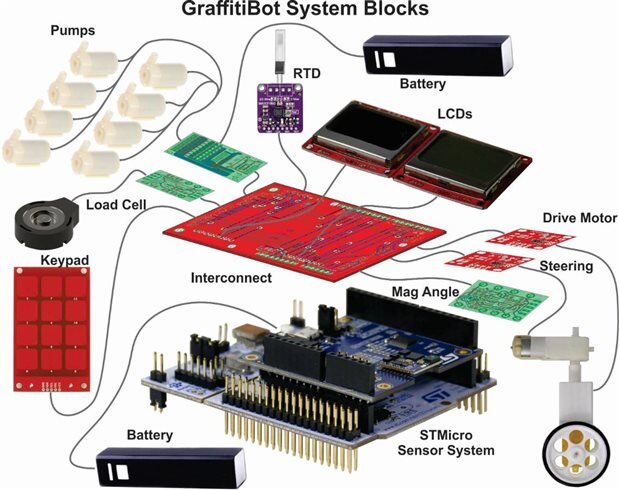

The diagram below shows how all the electrical subsystems are connected in the GraffitiBot.
Although this is a busy diagram with lots of subsystems, there are just as many sensors on the Sensor Tile itself which are not broken out on the diagram.
There are 2 batteries - one will power the pumps and drive motors, the other one will power the rest of the electronics.
The keypad and dual LCDs will form the user interface, although the STMicroelectronics Sensor Tile has BLE on it, so Bluetooth remote control is also a possibility.

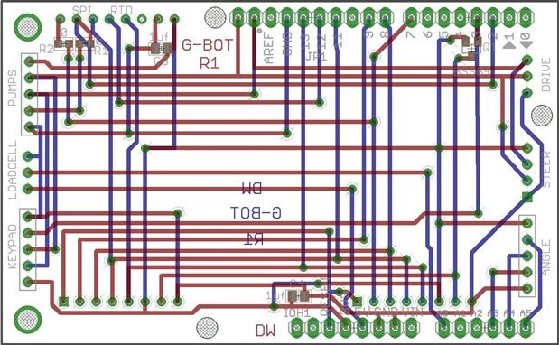

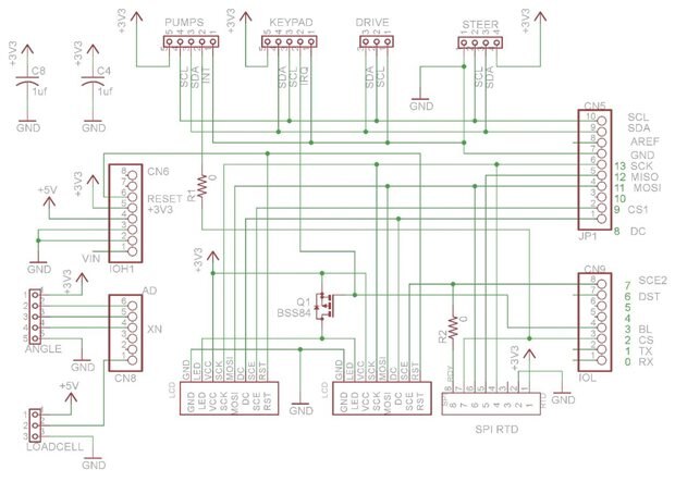

The big interconnect card doesn't have a lot of circuitry on it , but in addition to connecting all the subsystems, it serves as a platform for the LCDs. Its size makes it much more expensive than the other custom cards.
Here is a schematic showing how the interconnect card works:
Here is the corresponding PCB layout:

    genebren over 7 years ago +3
    Doug, Nice job on the system interconnect drawing. I really like the 3D views of all the parts, floating in space. Nice and clear! Gene

    So if I understand it correctly you are going to supply both DC motor driver boards with 5V from one of your power banks (I guess you will run cable from J10 connector on aquarim pumps driver board to…
    dougw over 7 years ago in reply to kulky64 +1
    You are correct, that is roughly the plan, but there are contingency plans if issues arise. The pump controller is also 3.3V although the pump FETs will supply 5 V to the pumps.
    The backlights will not be used on these displays - they would only be needed at night when the graffiti wouldn't be visible anyway. These displays are similar (software compatible) to the displays from SparkFun, but use a different pinout. Without the backlight, they are very low power displays - like what you would find in a dumb watch.
    Why 2 displays? - There are a large number of sensors to display, plus I want to display the graphics to be printed by the bot.
  • kulky64
    kulky64 over 7 years ago in reply to dougw
    Just the backlights on both displays will probably consume big chunk of your current budget. At SparkFun site they claim that backlight on those displays can consume as much as 100 mA:
    https://learn.sparkfun.com/tutorials/graphic-lcd-hookup-guide
    Although your diplays look a bit different, so the figures may not apply. What for do you need two displays anyway?
    Good question. I expect them to require much less than 500 mA, but I will measure to make sure.
  • kulky64
    And second power bank will go to USB connector on Nucleo board? Will 500 mA be enough for all devices on 3.3V bus?
