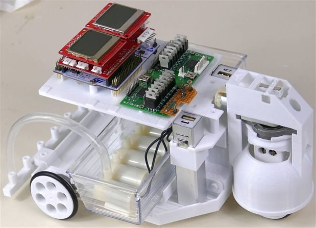

GraffitiBot is a fully autonomous ground vehicle capable of printing graphics on the surface it is traversing.

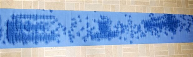

This crude attempt artistic rendering at writing "E14" demonstrates what the GraffitiBot accomplished on the last day.

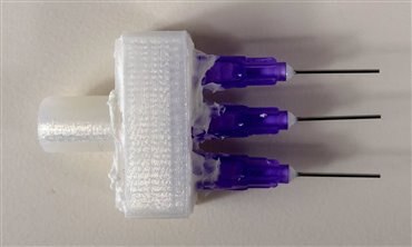

The challenge has ended, but I did not stop experimenting with the GraffitiBot. As shown above, the bot spays too much fluid and drips where it shouldn't. I had ordered some syringe dispenser needles to achieve more precise nozzle flow, but they did not arrive until after the challenge deadline had passed. I wanted to at least try them out, so I spent a few days designing and printing a manifold and trying to seal the new nozzles into individual pixel heads. The needles come with a plastic funnel which was so wide it only allowed 3 needles per pixel. The caulking compound I used had low toxicity, but it was very hard to work with on this scale. Here is an close-up of what a 3-needle head looks like after caulking:
This head arrangement added an extra 17 printed parts to the bot for a total of around 46.

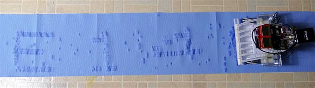

I had made a mistake when ordering these needles - the description indicated they were 22 gauge needles and I assumed they were 22 gauge inside diameter, but that was the outside diameter and the inside diameter was only 32 gauge. So they were not going to deliver as much fluid as I planned - but I decided to try anyway. About half of the nozzles were clogged with microscopic material, so I spent quite a while trying to use flimsey 32 gauge wire to clean them out. It was very fiddly but worked okay. When trying to get reasonable flow rate I discovered the pumps worked much better at 7 volts, but I only had a 5 V battery. Anyway after a week of upgrades here is a new run for comparison with the run above:
You can see there is a lot less water and a lot less dripping in unwanted areas, but it could really use slightly larger diameter nozzles. Raising the nozzles another cm would also pretty much eliminate excess dripping. It could take quite a bit more tweaking to perfect performance, but this does show that the GraffitiBot concept could create reasonable results with a few more iterations.

It is still too fresh to properly summarize what this project has meant to me, but it was a major undertaking given all my other priorities and constraints.
Stats
GraffitiBot involved a lot of disciplines like electronics design, firmware design, mechanical design, and hydraulic design.
I think it had more sensors than I've attempted to incorporate in an element14 project. (I think there were 18 sensors)
There were 5 custom printed circuit cards, which is a record for me on element14 projects.
There were 29 mechanical parts designed and printed for this system.
It had 10 DC motors which is another record for me on element14 projects.
There were 20 blogs and 19 videos in 14 weeks.
These postings generated over 50,000 views (and counting), which I think is a record for me on an element14 design challenge.
The stats sound pretty dry, but behind them was a lot of meticulous design and intense problem solving. There was so much work and already so much blogging activity that blogging about all the myriads of issues that were encountered was necessarily pretty sparse, but solving problems is one of the most enjoyable aspects of this type of project.
