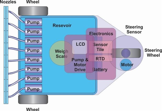

For this challenge I want to build a robot that can draw text and graphics on the surface it is traversing. It will accomplish this by dispensing a liquid such as water (or paint) in a raster pattern as it moves. Similar to a giant ink-jet printer. For locations where paint is illegal, the machine could simply spray water and make temporary images. It is winter here, so the design will have to be on a scale that can work in my house.
Technical Notes
One of the key challenges with the water dispensing design is to start and stop water flow precisely on demand. I plan to use aquarium pumps to move the water, but the hoses they use typically won't stop water flow exactly when the pump shuts off – either excess water comes out or water retreats into the tube due to gravity and air pressure, making precise starts also a problem. The issue could be solved with valves, but they are far too costly for my budget. I plan on designing it so there are not enough flow forces to overcome surface tension at the nozzles. This is a big unknown which could dramatically
affect performance.
System Sketch

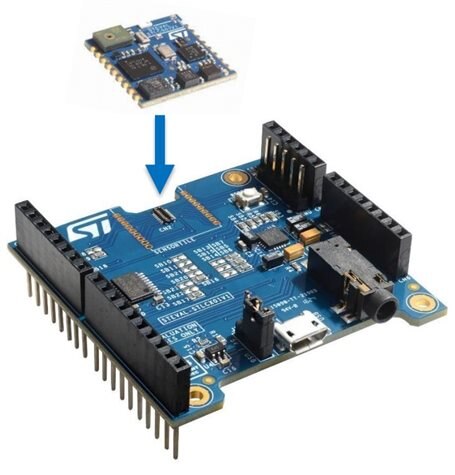

ST Microelectronics Sensor Tile
- The compass will be used to provide heading feedback for robot navigation.
- The accelerometers will be used to monitor and display surface angles of the driving surface.
- The gyroscope sensors will be used to make accurate turns
- The barometric pressure sensor will be used to display pressure and relative elevation

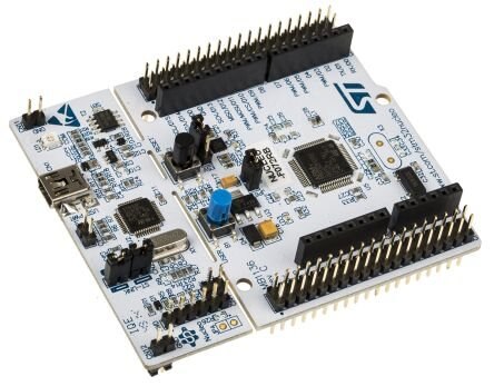

Microcontroller - STM32F411RE
100 MHz ARM Cortex M4 with 512kb FLASH,128kb SRAM and 12 bit ADC

The LCD I would use would have 84 x 48 pixels and the physical canvas (driving surface) would have exactly the same arrangement. The LCD happens to write 8 pixels vertically at the same time and the machine would use the same sequence with 8 nozzles, so the LCD could display each pixel as it gets painted. This will allow testing of the graphics before actually spraying liquid. Initial programming will try to write a single line of text. The stretch goal is to have the robot perform a raster path which would allow full dot-matrix graphics to be printed.
Robot
The robot would have 3 wheels in a tricycle format with the front wheel providing both locomotion and steering. The chassis would be at least partly 3D printed.
Development Plan
Electronics design for this project will require designing at least 2 PCBs. One PCB will be a good chance to do some analog signal conditioning design for the load cell, the RTD and the magnetic angle sensor. The other card will include an LCD to display the target image plus miscellaneous other interface and power circuitry.
Software design will require reading all the sensors and using the data to control drive motors, steering and navigation at the same time as the nozzle control system is spraying paint on the ground.
Mechanical design will include the steering and drive train, the robot chassis, the spray nozzle and reservoir system.
