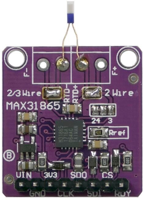

The PTF Series PTFM101C1G0PTFM101C1G0 RTD from TE Connectivity is a platinum RTD making it very stable and accurate and it is tiny as shown in a previous blog, allowing it to respond quickly to temperature changes. Although the Nucleo MCUNucleo MCU has a 12 bit A/D converter, I wanted to implement an RTD interface with even higher accuracy. I chose a Maxim MAX31865MAX31865 chip which is specially designed to handle RTDs with its internal 15 bit A/D converter. This chip has an SPI interface and is mounted on a small circuit board:
Note the 2 solder bridges near the RTD that configure this card for 2-wire RTD operation. The wires to the sensor are so short, 2-wire mode should work fine.
A similar RTD cardRTD card is in the Newark catalog, but was not in stock for this order. Adafruit makes an arduino library for this chip and provides an example program. Unfortunately the example will not compile with the Nucleo as a target.
My interface card is compatible with both the Nucleo and standard arduinos, so I plugged the teperature sensor interface card into an Uno to see if it would work. The example program worked flawlessly, demonstrating the high performance of the RTD and also showed my interface card works with this sensor.
I removed the LCDs for this test because the arduino UNO runs on 5 volts and the LCDs run on 3.3 volts.
The temperature sensor card is designed to work on either voltage and seemed happy to be running at 3.3 volts even though the arduino was running at 5 volts.
