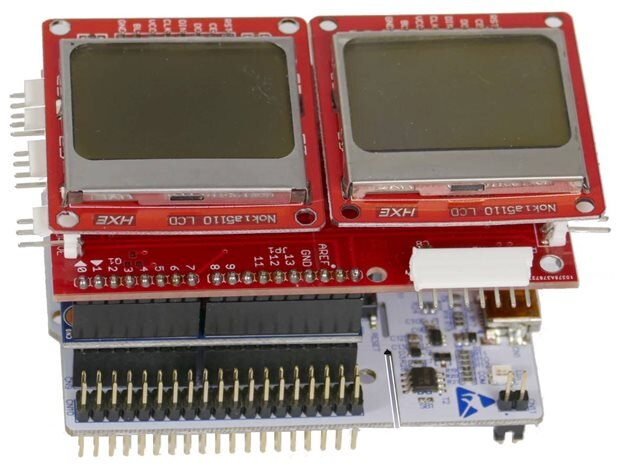

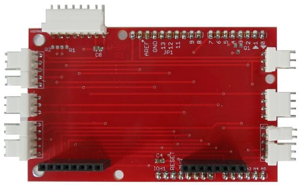

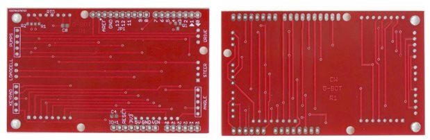

This is the big milestone tenth blog in this design challenge, but there is still a lot of work to do with only 4 weeks left. My LCD PCB finally came back from the being printed, so I can connect up the liquid crystal displays and start programming.
The schematic design and PCB layout were covered in blog 5.
Here is what the bare card looks like:
It is red because that was the lowest cost color at the time of ordering.
Here is what it looks like assembled with connectors for 2 LCDs, 3 sensors, 10 motors, a keypad and the MCU:
Here is what it looks like stacked on the MCU with sensor tile and LCDs:
Here is a quick video showing my first program that ensures I have the connections right for the LCDs:
It is always a great day when a PCB fires up without problems.
