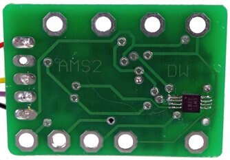

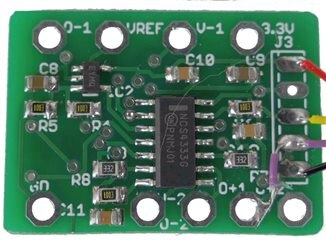

This blog describes assembly and testing of the TE Connectivity magnetic angle sensor. The circuit design was described in a previous blog. The PCB arrived a couple of weeks ago, but I had to wait for parts to build it.
I had ordered parts from Newark using a shopping cart I won in a Project14 contest. They came in this week accompanied by an $18 shipping charge but I am now able to assemble these cards. Here is what it looks like.
Note the sensor chip is on the underside of the card to allow it to be near the magnet without interference from other components. The extra long pads I used for the magnetic sensor proved very useful in making the small chip hand solderable. I used a little flux and wicked the solder under the chip. It is a relief that the magnetic sensor was solderable on the first try and I didn't damage it, because I have no spares.

This is the second analog sensor that is now assembled and working properly.
