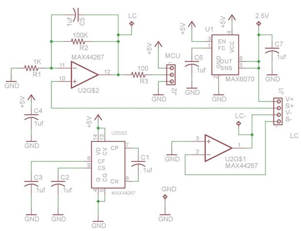

For the load cell circuit I want to try using an  exotic amplifier from Maxim that uses an internal charge pump to provide a negative reference for the amplifier.

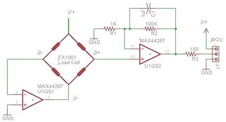

This will allow the load cell to have a negative rail controlled by an amplifier which forces one of the bridge nodes to precisely sit at zero volts, neatly minimizing offset in one arm. This allows the other signal node to be amplified and filtered by a normal amplifier, with any gain needed. Conceptually the circuit looks like this:
The first amp creates a negative voltage for the load cell which is about the same magnitude as the positive rail. This Maxim amp is a great (simple) way to force the negative signal node to zero volts which greatly simplifies the output amplifier. We can select any gain we want by changing R1.
In this case the gain is R2/R1 + 1 = 101.
The output resistor is just to ensure the amp is stable if the load or cable has high capacitance.
The Capacitor limits the amplifier slew rate, effectively providing a low-pass filter function. My application does not need any speed, so a heavy filter helps eliminate noise.
This load cell only operates in compression, so I only need to deal with single polarity output signals.
The full circuit below uses a voltage reference to supply the load cell, because the load cell is ratiometric. Changing the excitation changes the signal amplitude, so we want the excitation to be very constant. The load cell cannot be soldered to a card, so there is just a connector for the load cell.

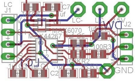

The Load Cell PCB layout fits on a small card about 1" by 3/4". Note the test points which will allow the signals and reference voltage to be monitored by a DVM.

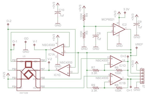

I am going to use a similar circuit, but it will be biased to a reference voltage that is half the power supply. This will allow the gain stage to use the reference voltage as its "ground" and amplify the sinusoid about that reference - making full use of the A/D range. The MCU will also be able to read the reference voltage and subtract it to get a proper plus and minus sinusoid.
This circuit never goes below ground, so the Maxim amplifiers are not needed. Instead I want to use precision zero-drift op-amps. I chose a quad op-amp from ON Semiconductor for its low cost. NCS4333. I also used a low-cost zero-drift op-amp (from Microchip) to buffer the reference voltage because I had some in stock. MCP6021.
The circuit uses the same idea of dedicating one amp to force the negative signal node to the reference voltage in this case and a second amp to provide gain.
Here is the full schematic for the magnetic angle sensor:

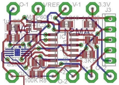

Here is what the PCB layout looks like. It has even more test points but is about the same size as the load cell card.
The sensor chip is tiny - just over 2 mm (it almost fits in one of the 2 mm test points!) and the pads are only 0.25 mm so I made a special footprint with long pads so I can hand solder by "wicking" the solder under the pads. (because I don't have solder paste or a good way to re-flow it). The long pads allow excess solder to be dragged away from the chip and spread out enough to separate any solder bridges. (This is just my theory, not some standard soldering technique)
I'm not sure how close the magnet needs to be to the sensor, so I put the sensor chip by itself on the bottom of the card where there are no components to prevent getting the magnet very close to the sensor. I even needed to put a copper dot for pin 1 because there is no silk screen on the bottom.

    dougw over 7 years ago in reply to kulky64
    Excellent points kulky64 . Thanks.
    I can easily adjust the reference to be higher than half the supply voltage.
    I will check the pinout as well. It would have been so much easier to solder if the part in the kit was an SO8.

    Hi, I have several notes to your design:
    - You goofed up Eagle part for the KMT32B magnetic angle sensor. I assume you created your part according to Figure 1 in the datasheet. But this figure refers to pinout of the SO8 package. You want to look at pin assignment table for TDFN package on page 5 of the datasheet. With this error you have basically flipped the role of excitation and measurement points of the Wheatstone bridges. I don't know if this part would operate under these circumstanes, but I would not rely on this.
    - I would remove center solder pad underneath KMT32B. Recommended solder pad layout in the datasheet does not show this pad, so why risking shorts to this pad that are difficult to see once the part is soldered down?
    - I don't think your circuitry around KMT32B would actually work (unless I'm missing something). Because if you provide positive excitation voltage from +3.3V source and you are creating negative excitation voltage from op amp output so that one of your measuring points is at +1.65V, then as the bridge is unbalanced to positive and negative values between measuring points, the op amp output needs to go few millivolts above (no problem) and below (this is problematic with single supply) GND potential to maintain constant value of 1.65V at S- as shown in the picture (excuse my crude MS Paint sketch created from one of your images).
