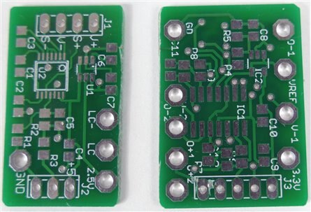

Two of the PCBs I designed for the GraffitiBot came in but I won't have enough components to assemble them until at least next week. Here is what they look like:
One interfaces to the load cell and one interfaces to the magnetic angle sensor.
While waiting for parts I have started looking at the software. ST Microelectronics has written a lot of software for this sensor tile and I am including some of the links in this blog. There are multiple links on each of the pages I have linked. This of course means there is more to learn, but it should also provide helpful examples. There is a mode to stream data to a PC via a USB SPP but I didn't see any documentation on the data format - I will need to dig through the code to figure out the format and change the output to a normal UART for the main MCU.
