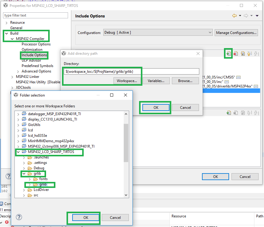

The start of that forum post contains a zip file. You'll find grlib and LcdDriver folders in BluHale path of that archive.
Copy these two to your project and add a new include entry that points to grlib/grlib.
And then add this include and rtos task (or just replace the existing heartBeatFxn() task of the empty example) to your project. Check my links below to learn how to start a TI-RTOS project if you don't have one ready.

    Jan,
    Thanks for finding this and for posting your solution.  I've created an empty TI-RTOS project in Code Compose Studio 7 and have added the GrLib and LcdDriver folders to the project as well as set the Include path to GrLib/grlib but I am getting unresolved symbols for g_sContext and g_sFontCm20b.  I've corrected this by adding a definitions for both in the main project file (empty.c for me), and it looks like you did the same for g_sContext from what I see in your .zip files, however I am still not able to see any output on the LCD. Also, I noticed in your  lcdtest.c file has "Board_initI2C();" uncommented but I thought the Sharp ICD Booster was a SPI device.     I've tried both the SPI and i2C but neither results in anything being displayed on the LCD.  The red LED does blink so I know the program is running.  Also, I can run the MSPWARE project 430BOOST-SHARP96_CapTouch_MSP432P401R on the board with the Sharp LCD and it works just fine.
    Any suggestions?
    Thanks,
    Jon
    Jan Cumps over 9 years ago in reply to jomoenginer
    I had forgotten this in my code snippet on the blog:
    Graphics_Context g_sContext;
    What can also be misleading is that the zip file contains a grlib within a grlib.
    You have to copy the parent, including the child grlib.
    I've done the exercise again and filmed it. I'll upload the end-to-end when it's finished rendering so you can check out where the explanation and reality are different.
