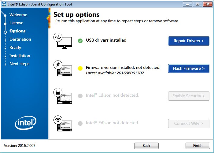

I decided enough was enough for tonight, and since it came back with exactly the same screen AGAIN I chose Finish.
As it closed there were multiple warnings about the F:\ drive requiring formatting and this
So presumably after a disconnect and repower it might wake up and we can proceed.

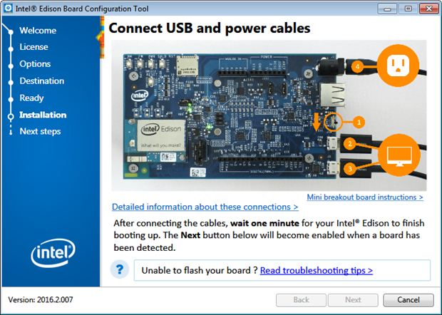

I tried the tool but it seemed to be stuck at this picture.
The Next never came up.

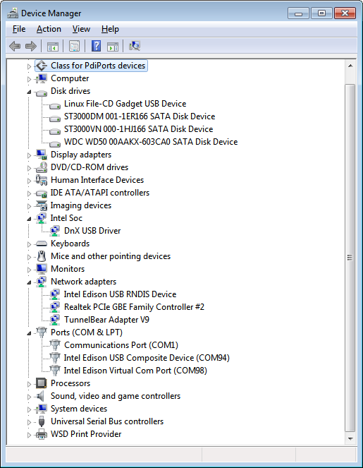

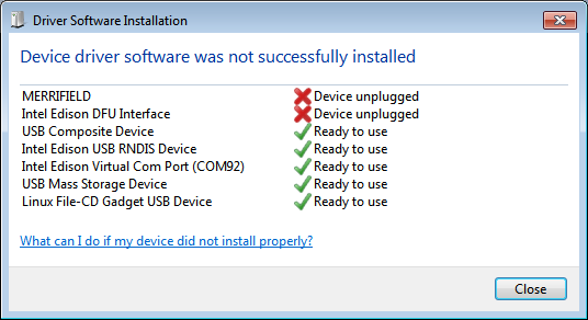

Windows knew the drivers were there

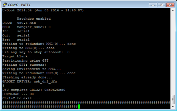

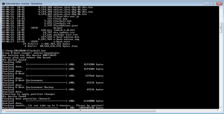

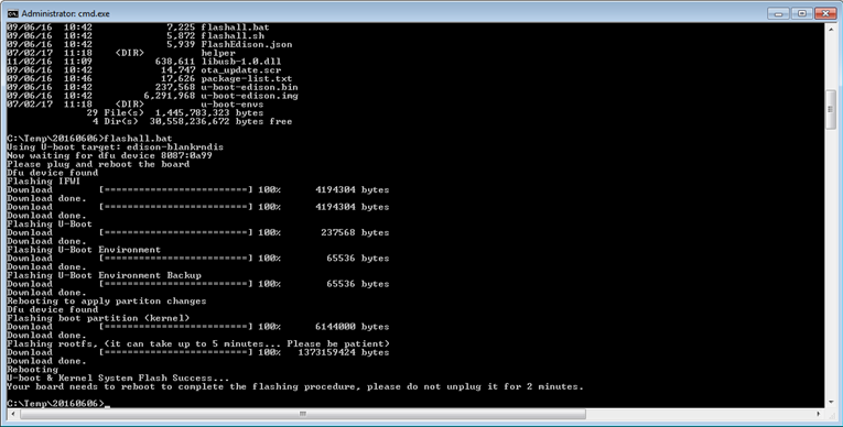

Flash the image
Since I could force a reboot and the session stayed up, I thought I'd try the manual reflash again.
Basically you download and extract the image, then copy dfu-util.exe and libusb-1.0.dll into the same folder.\
Open a command prompt (i ran as Administrator) and change directory to the extracted file.
You then type 'flashall.bat" and it will ask you to reboot.
This time I issued the command reboot via the PuTTy session and amazingly things happened.
After a period of time it completed.

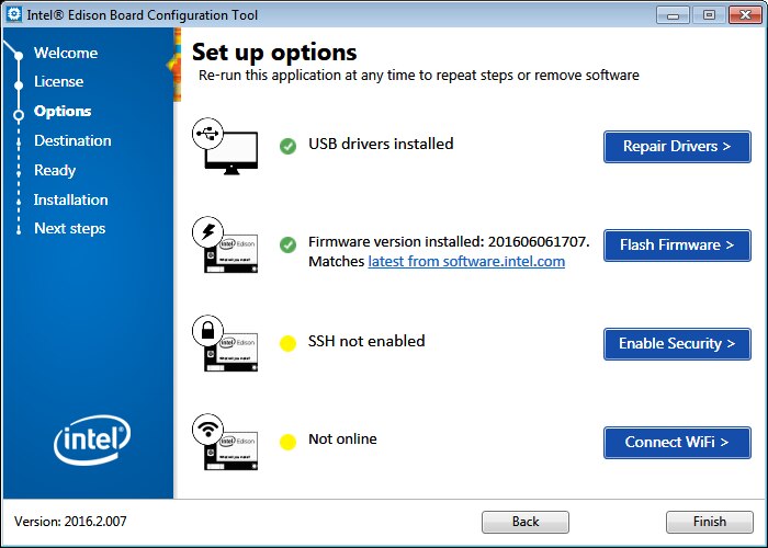

So I have a working version of fireware.

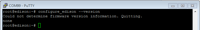

Firmware
There seems to be a newer version of firmware labelled
iot-devkit-prof-dev-image-edison-20160606-patch.zip
The internet suggest you can tell what version you are running by typing in a session
"configure_edison --version"
I seem to get this response
The configuration tool seems to now be happy.
