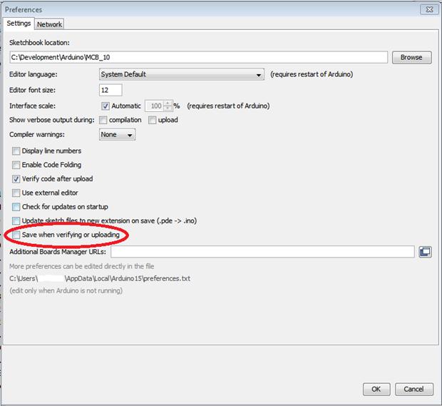

In the last post First Steps - Intel Edison Arduino
I managed to get the Intel Edison running on both Laptop and Computer.
I was able to upload the blink sketch and run it.
The sketch doesn't run at bootup, but that's expected (there is a tweak to make it auto-run).

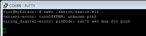

Test Sketch
I have a sketch that uses One Wire, I2C LCD, and some Inputs and Outputs.
This is my "go-to" test sketch for a new IDE or board, and it's only fair I throw it at the Intel Edison.

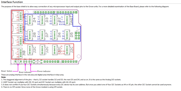

   Uses a 16x2 I2C LCD Backlight Display
   The LCD Connections are:
   GND to GND
   VCC to +5v
   SDA to A4 (Arduino)
   SCL to A5 (Arduino)

The next job was to connect it to the version1 Grove base plate I had.
I'd brought this some time ago thinking that the Grove system would be useful for teaching pupils, and it is.
Ultimately we went with a slightly different version due to costs and we connect directly to our Arduino's without the base plate.
For whatever reason I have only one lead (Plans to fix that are on the way), so some improvisation was required.
I did have a bunch of Grove end to individual sockets and some long header pins.
I decided that the LCD could be connected easily, the pushbutton using the lead, and the Temperature sensor and rotary pot via 6 header pins.

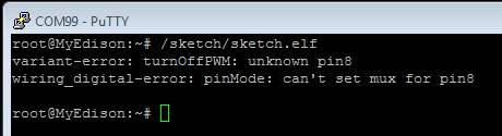

I've been doing some digging and it seems that the download process causes it to run the sketch.
The Edison seems to be put into a 'download over the Serial port mode', and part of that then executes the sketch.
Thats fine .... but what happens if you reset or stop the sketch.
Normally a reset of the Arduino board (power or the reset button) will restart the sketch as it boots up.
For the Edison we are talking about one 'program' running under the OS.
When we play with the Raspberry Pi we generally use Shell scripts (.sh) or Python scripts (.py) and these have their own handler/launcher.
The file is modified to be an executable, but simply running it doesn't do anything. (well except annoy it)

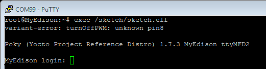

We can use the 'exec' command
That reply was sort of 'go-away' ... but it still didn't run.
You'll note that it also stopped the current session as you need to Login again.
In among the various things I tried adding a period (part of my redirection attempts)
Lo and behold it ran.   image
It's kept running, and you can hit Ctrl C to make the shell return, and it keeps running.
I've tried running it with exec /sketch/sketch.elf & to make it run in the background, but it won't run.

Latest Arduino IDE
Normally I don't subscribe to the very latest release, but in this case there are some great advantages.
The IDE has a board detect, which is very useful to confirm you are indeed talking to the board.
What I don't like with the newer releases is where they splatter the files.
Arduino started out as a simple set of files, that would even run from a memory stick.
Now it seems they have the program wherever you install it, but once you run it it dumps files in
C:\Users\xxxxxxx\AppData\Local\Arduino15  (where xxxxx is the user login name)
This is fine if you are the only user, but it also makes it hard to copy the whole installation onto your laptop, or back it up.
Why??
You should be careful of the default settings.
I save my files into one of two directories based on version 023 or the later 1.0 version.
I normally don't bother checking for updates  ... (why change for the sake of change)
You may wish to set Verbose during upload and the compiler warnings.
The dangerous one is that the Save when Verifying or Uploading is ticked by default.
It overwrote my file I started with, and luckily I'm in the habit of copying the line and commenting it out until I want to delete it.
I'm sure I'll find out about Code Folding and the Interface Scale one day.
