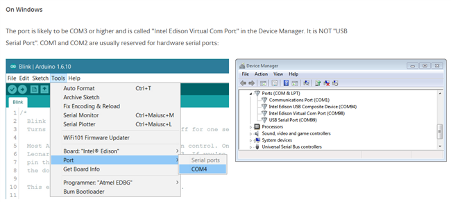

They suggest connecting both USB cables, and then specify which port to use.
In my case it is COM98 (yes I've had lots of different boards of varying flavours plugged in this machine)

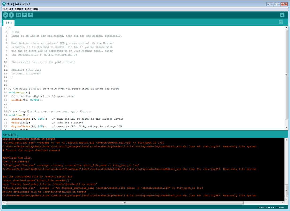

So I hit the upload and it does the compile, writes some stuff and stays with uploading.
It seems this line is the problem.
#mv the downloaded file to /sketch/sketch.elf
target_download_name="${host_file_name##*/}"
echo "Moving downloaded file to /sketch/sketch.elf on target"
"$fixed_path/lsz.exe" --escape -c "mv $target_download_name /sketch/sketch.elf; chmod +x /sketch/sketch.elf" <> $tty_port_id 1>&0
C:\Users\Beckettm\AppData\Local\Arduino15\packages\Intel\tools\sketchUploader\1.6.2+1.0/clupload/cluploadEdison_win.sh: line 56: /dev/ttyS97: Read-only file system
It makes the read-only statement several times, so obviously the Edison isn't happy to receive it.

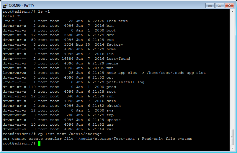

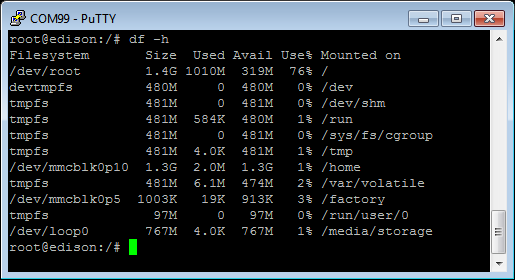

PuTTy
For anyone that doesn't have this on their windows machine, best you do install it.
You'll need it to talk to RPi in headless mode, and since the Intel Edison is a linux based device, it will be useful here.
It says to check there is space using df -h
In my case there is.

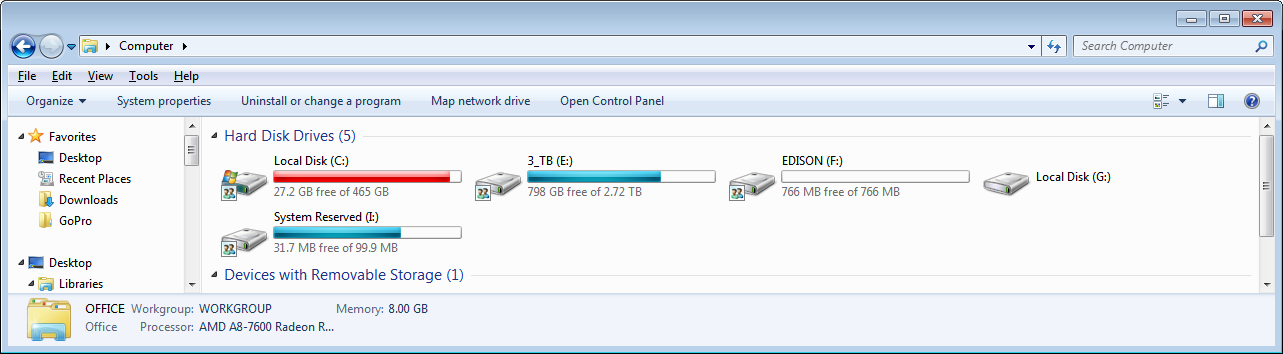

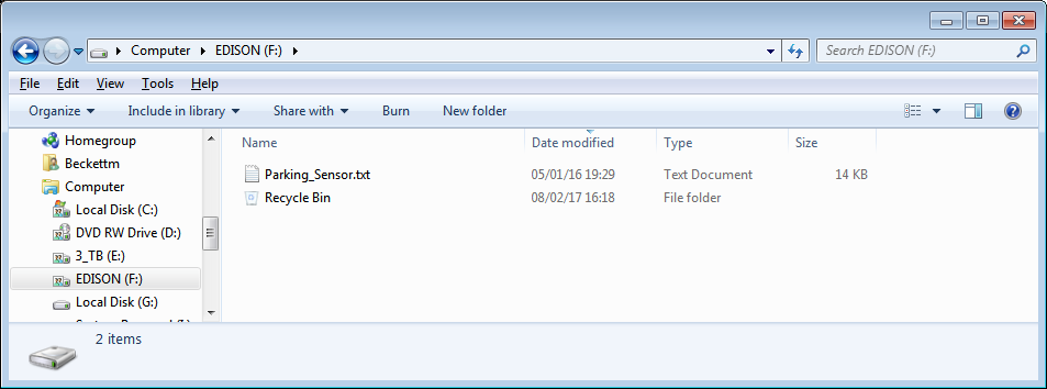

However I have a F: drive showing 767Mb free and I can copy a text file onto it.
I can check the F: drive for the file
Strangely though, when I log into the Edison and check /media/storage it's not showing.
Now I'm assumming that this is the right directory.
It is the right size.
I used 'nano' to creat a text file.
I then attempted to copy that to the folder /media/storage
Lo and behold it seems that folder is a read-only.
So next step is to check if it is or that the way Linux presents and the symbolic links aren't creating the issue.
After all Windows can write to something that seems to be the right size.

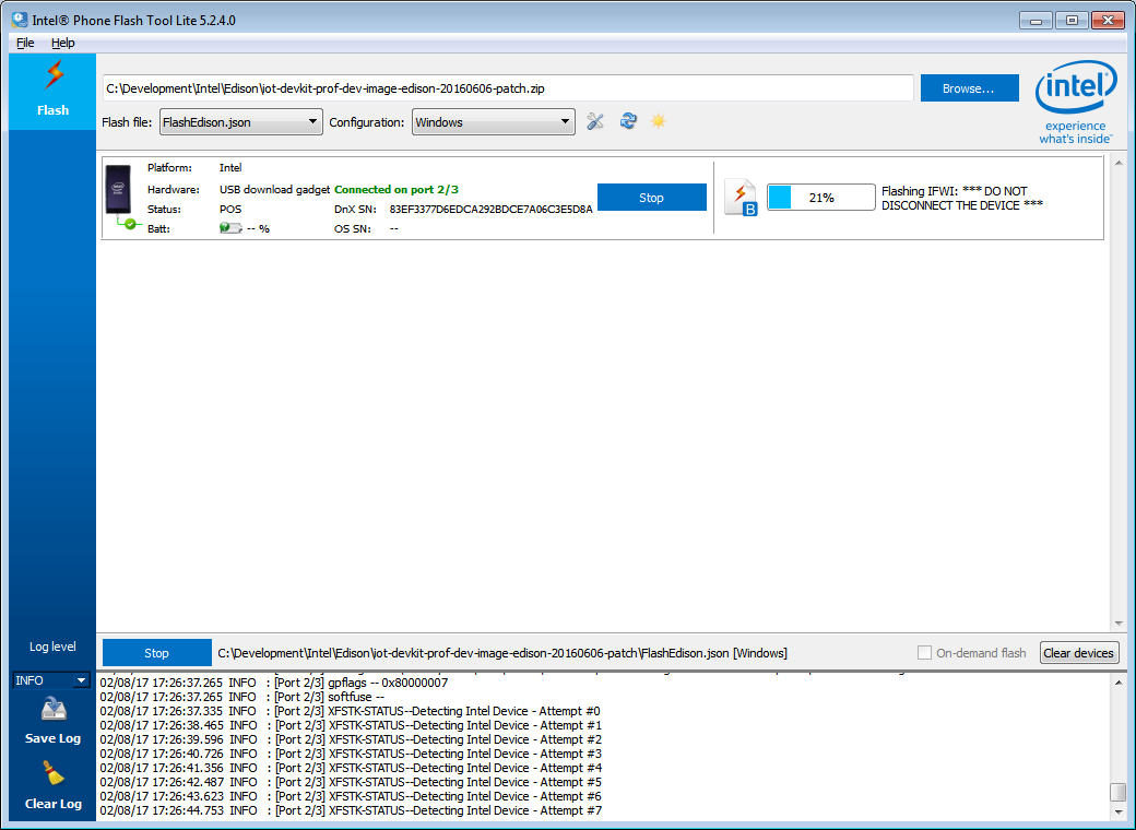

I found a utility called Intel Phone Flash Lite and the people in the www world suggest this is the best way to flash an Edison.
https://software.intel.com/en-us/using-flash-tool-lite
After downloading it, and running it, it wants to relace one driver ... (what is it with these drivers)
It then fires up and asks what image you want to use.
I pointed it at one and it unzips it, then extracts the .json file.
It's a very interesting utility and gives various other information that the previous one didn't.
So I started downloading and it kept failing after a while, with lots of beeping from the computer and driver installs.
