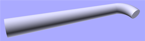

I've used different CAD packages over the years but recently I've been doing a lot with OpenSCAD. This is different from a lot of CAD packages in that the only way you can create objects is via scripting.
Here's a simple example of a cylinder joined to a circle which has been extruded around a 70degree corner.
module Exhaust() {
    union()
    translate([1.81,4.66, 0])
        rotate([-20,-90,0])
            cylinder(r1=1.5,r2=2.5,h=30, $fn=100);
    rotate_extrude(convexity = 10, angle=70, $fn=100)
        translate([5, 0, 0])
            circle(r = 1.5, $fn = 100);
I find it is good for 3D printing as you can tune the parameters as you build different models. As it's a coding language naturally parts that are repeated in arrays or circles are easy to reproduce. It's less good at producing organic items such as trees although you could use "fractal" algorithms for that kind of thing.
I have been working around a bug where the "difference" function causes things to disappear on one of my Win10 machines. Something to do with Java and incompatible video drivers apparently.

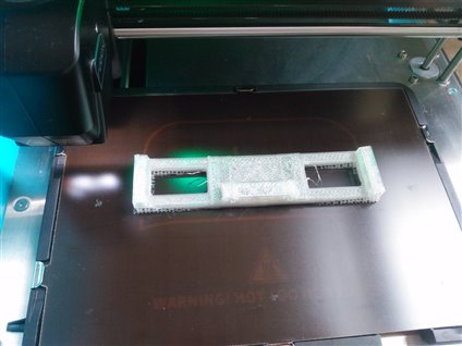

One technique I used on several of the parts was to print out a couple of layers and then cancel the print to give a floppy template. This allowed me to cross check the dimensions and ensure things would fit together.

The chassis serves several purposes: it's there to strengthen the middle section that was weakened by the cutting down; it provides mounting for the battery and Edison, and it provides an attachment point for the bumpers. This has gone through many iterations, the initial models were massively over engineered with 10mm thick struts and would have taken many many hours to print. So it's been slimmed down and simplified. The other key design feature was making it short enough to fit on my 210mm printer bed. After watching a video by Vicki Somma, I realised that the buffers that held the bumpers in place would be better as octagons so that when I print the sockets on the mating parts they won't have a big span to cross. The design changes cut the predicted print time from 4hrs to 2hrs 20minutes and also the amount of filament used is reduced.

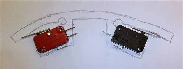

Bumpers
I had initially thought about attaching the bumpers with rods and springs but I realised that I can use the springy properties of the PET plastic and just attach them directly to lugs on the chassis. Here's my sketch and models of how these might be built.
