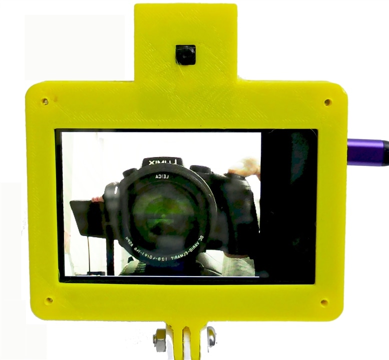

The Arduino Giga R1 has a camera connector, so of course I want check it out, so I purchased the highest resolution color camera I could find that had the correct connector. This is the Arducam B0462 which uses a 2 megapixel GC2145 camera sensor (1616V x 1232H). There is an example sketch that captures Arducam camera images and displays them on the Giga Display, although it is not well suited to this camera.
imageGiga displaying an Arducam image of the camera taking this picture
Giga R1 Demo of the Giga Display with an Arducam B0462 Camera
The example sketch displays the camera image upside down and backwards. Because the camera is connected to the display, it doesn't matter if you turn the camera upside down, the image on the display is always upside down. So I had to modify the code to transpose the image.

It is very cool that the GiGa has a built in camera interface, It is a simple plug-and-play exercise to set it up. However, the example software is not taking maximum advantage of the hardware capability. It seems to be limiting the image capture to 320 x 240 pixels and the display to 640 x 480 pixels. Additionally, the image displayed by the example sketch is reversed both horizontally and vertically, which makes everything look upside down and backwards.. Fortunately the transposition is easy to accomplish in software as shown above. The camera hardware is useable as is, but I hope the Arducam library gets updated to allow camera images to properly fill the 800 x 480 display without upscalling. Incidentally, the camera video and images displayed on the GIGA Display look much better in person than what my camera can show.
