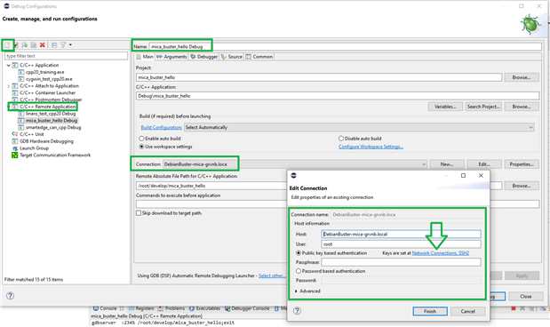

Install gdbserver so that you can use Eclipse on your Windows PC to build, upload and remotely debug your application.
apt install gdbserver
A 20 minute activity to turn the Debian Buster container into a lean environment, where you can develop and debug with IDE support and native Linux, with little load on the Mica..
