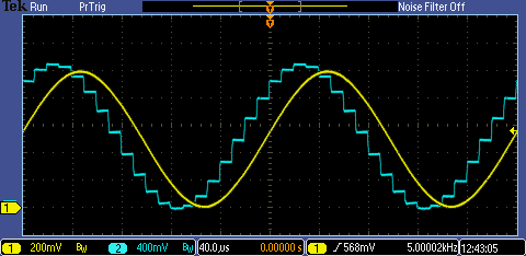

In the last blog, I looked at computing a sinewave using a CORDIC method. It was implemented in a iterated bit-serial fashion to keep the hardware usage low, though it turned out to be more complex than I had anticipated because of some of the fiddly control necessary.
This time I'm going to add a passive analogue reconstruction filter to the output. At the same time, I'll have to do a bit of work on my phase accumulator. In the last blog, I just had it running from -pi/2 to +pi/2 to generate half of the sine, but now I need it to run continuously and generate the actual sinewave.

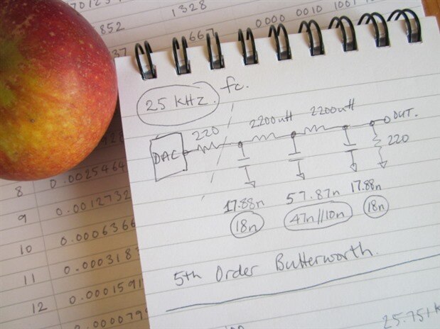

The Circuit
Here's the circuit for the filter I used:
In case you're interested, today's apple is a Cox's Orange Pippin. This one lived up to its name and was a nice orange and red colour.
For the filter, I chose a 5th-order Butterworth low-pass response and designed it by finding the normalised (to 1Hz and 1ohm) capacitor and inductor values in a book and then scaling them appropriately. [I actually worked it out somewhat backwards, because I only had a very limited range of chokes, so I looked for which inductor would give a fairly sensible resistor value for the cut-off frequency I wanted (25kHz) and then calculated the capacitors on the basis I could probably piece them together from parts that I had.]

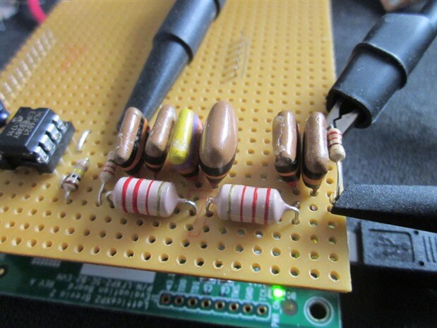

Here it is built on my prototyping board.
You can see that I've paralleled-up capacitors to get the value I wanted. Happily, I found some old 10nF parts that actually measured 9nF and which I could parallel to give 18nF.

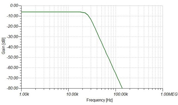

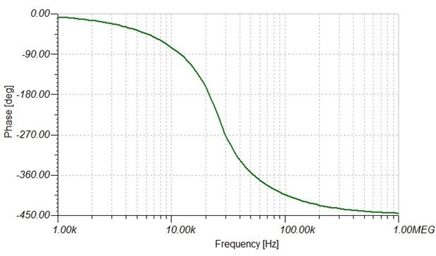

Simulated Response
Here's what a simulator gives me for the frequency and phase responses for the component values I've chosen:

Testing
Here's how it looks on the oscilloscope. The blue trace is the output of the DAC, the yellow the filtered waveform. It was supposed to be 10kHz - I forgot about the extra factor of two that I had built in.
The amplitude is diminished slightly over the gain of x0.5 we'd expect from the equal-value resistors at each end of the filter. That's probably the sinc roll-off from the first-order hold response of the DAC which I haven't tried to compensate for, either in the design of the analogue filter or by filtering digitally with the inverse response in the FPGA. I'll add it to the list for future blogs.

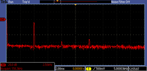

Out of curiosity, I tried the filtered sine with the 'scope's FFT. That shows a fair bit of 3rd harmonic and some 2nd, so it might be that the way I'm folding the accumulator values isn't quite right.

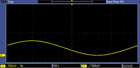

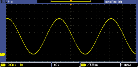

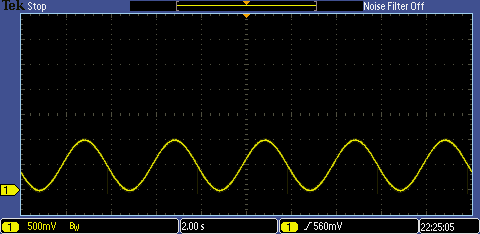

I thought I'd have a look at generating a really slow waveform. I'd already done some calculations for a 2Hz sinewave, so I put in the phase increment and this was the result:
Hmm, got that wrong! My calculations had been for the fast cordic variant, with a sample rate of 50Msps, and not the 100ksps I'm using with the SPI DAC, so the end result was this sine with period of over 16 minutes. I let it run for a whole cycle so that you could see the trace. It does show at least one advantage of a digitally-generated waveform: that result would be extremely hard to achieve with an analogue oscillator.
What caught my attention was what appears to be a glitch. Well, it looks like a glitch, but if I increase the size of the phase increment and generate a 0.25Hz waveform, we can see that it occurs in the same place every cycle.
My tests for whether to leave the phase alone, or do the complement and add one, needed an additional test so that they get the very negative-most value right (it needs to be treated as a special case, unfortunately).
I now have this for the 0.25Hz waveform
That's quite mesmerising to watch, a bit like looking at a pendulum swinging back and forth as it gets drawn on the righthand edge of the oscilloscope screen.
There's been next to no change of the spectrum, so it doesn't look like the distortion is coming from the phase calculations.
