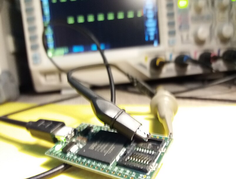

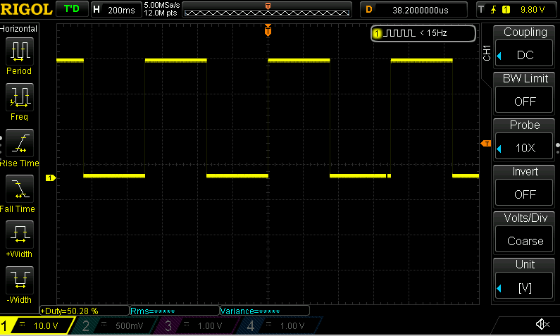

I used the mandatory blinky project. I didn't use an LED though, but an oscilloscope.
The XuLA2 examples are available when you install the Xess XSTOOLS.

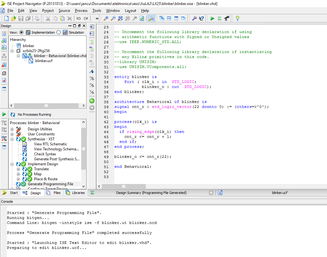

I've opened Examples/XuLA2/LX25/blinker in the Xilinx ISE, synthesised it and generated the programming file.
You can also make the project yourself by following the instructions in the Xess tutorial, chapter "Starting a Design in WebPACK"
Then I used the XSTOOLS Loader to beam it to the XuLA2:
xsload --fpga blinker.bit
Success: Bitstream in blinker.bit downloaded to FPGA on XuLA2-LX25!
With my scope attached to the CLK pin at the right lower corner of the PCB, I got the output:
The clock and output setting are defined in blinker.ucf:
net clk_i     loc=a9;  # 12 MHz input clock.
net blinker_o loc=t7 | IOSTANDARD=LVTTL | DRIVE=24 | SLEW=SLOW ;  # Blinker output to LED.
The downcount from 12 MHz clock to approx. 1Hz blink signal is done in the VHDL design:
entity blinker is
    Port ( clk_i : in  STD_LOGIC;
           blinker_o : out  STD_LOGIC);
end blinker;
architecture Behavioral of blinker is
signal cnt_r : std_logic_vector(22 downto 0) := (others=>'0');
begin
process(clk_i) is
begin
  if rising_edge(clk_i) then
    cnt_r <= cnt_r + 1;
  end if;
end process;
blinker_o <= cnt_r(22);
end Behavioral;
