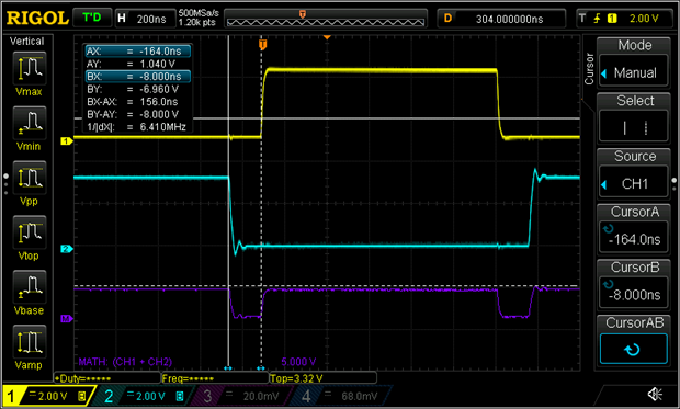

and 2 outputs: the complementary driving signals for the half bridge, with dead time injected.
image: preview of what the final output will be. The cursors show the dead time before output A switches high.

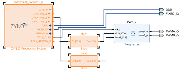

Interaction between the VHDL PWM and the Zynq ARM realms.
In my original Spartan 6 post, everything was happening inside the FPGA. There was a rotary encoder setting the duty cycle, and the PWM module reacting on that.
In my Zynq design here, there is no rotary encoder. The settings come from the Arm, running Linux.

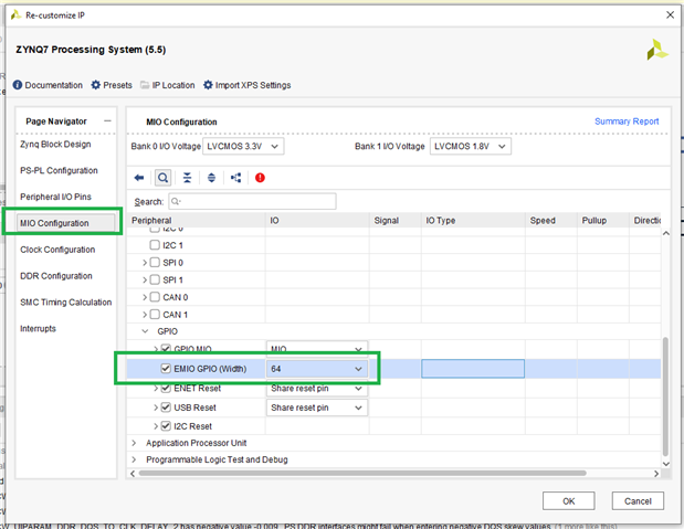

The interface in this blog is the 64 bit GPIO pass-through.
image: the GPIO bus between ARM and FPGA is enabled
The interface will give duty cycle (8 bits) and dead time (4 bits).

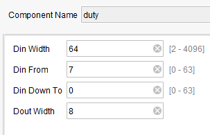

I'll use 2 slice modules to cut these 2 values out of the 64 bit wide GPIO output bus.
image: interconnections. in this picture, the ARM part and the slices that provide duty cycle and dead time are highlighted.
The table below shows how the 64 bit port is "sliced" into different sections:
duty cycle dead time
image image
image: the slices that cut the 8 bit duty cycle and 4 bit dead time out of the ARM 64 bit GPIO output bus.
in a next post, I'll replace this mechanism by memory mapped interaction between ARM and FPGA fabric.
The duty cycle and dead time are inputs for the PWM VHDL module. The 3rd input is Zynq's clock signal.

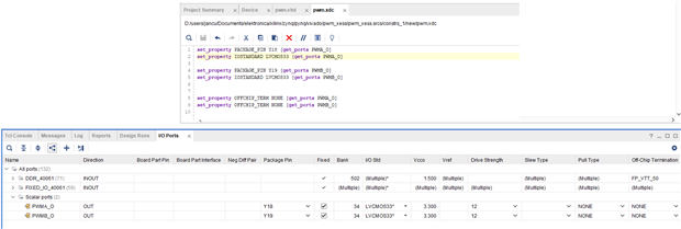

If successful, the output pins can be assigned. I'm going to route them to two pins on the PMODA connector:
Output Pins: Constraints

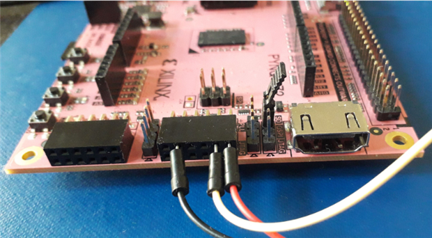

The output of the PWM block is routed to two pins on the PMODA connector:
image source: online published schematics
image: tapping the signals
The template XDC file for the Pynq-ZQ shows what balls on the Zynq package they relate to:
##PmodA
#set_property -dict { PACKAGE_PIN Y18   IOSTANDARD LVCMOS33 } [get_ports { ja[0] }]; #IO_L17P_T2_34 Sch=ja_p[1]
#set_property -dict { PACKAGE_PIN Y19   IOSTANDARD LVCMOS33 } [get_ports { ja[1] }]; #IO_L17N_T2_34 Sch=ja_n[1]
I could copy over that code, but used the GUI to configure them instead:
Before doing that, take care to generate a wrapper for the diagram, and put that as the top module.
That takes care that the inputs and outputs defined on that diagram will be the one that are accessible and can be constrained.
If all is good, let Vivado generate the bit stream.

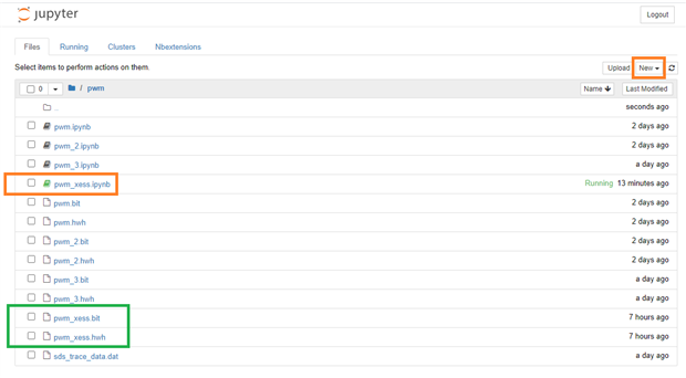

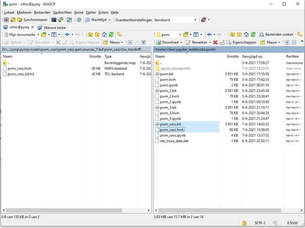

Deploy the Design to the Pynq-Z2
After generating the bitstream, there are two files that you'll need to copy over to the Zynq.
Both can be found in your project subdirectories (mine is named pwm_xess)
  • the .bit file (bitstream, I found it in pwm_xess/pwm_xess.runs/impl_1)
  • the .hwh file (description of the bitstream access points, I found it in pwm_xess/pwm_xess.gen/sources_1/bd/pwm_xess/hw_handoff)
Coy them over to a subdirectory on the Pynq, in the Jupyter structure.
I made a /home/xilinx/jupyter_notebooks/pwm directory and put them there.
They both have to have the same filename, to make to overlay on the Pynq work.
Use the Design on the Pynq-Z2
Now that the bitsream and wrapper are deployed, I can test from a Jupyter notebook.
The notebook is available on the network by surfing to http://pynq.
I copied my files to the pwm subdirectory of the notebooks. In my browser, I navigate to that same subfolder:
image: my Jupyter pwm test folder contains other designs too. I highlighted the ones for this post
I find the .bit and .hwh file listed.
To execute the bitstream, I generate a new Python3 notebook called pwm_xess.

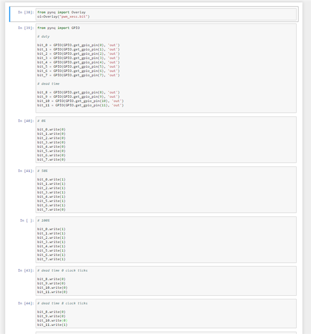

First the code to load the bitstream:
from pynq import Overlay
ol=Overlay("pwm_xess.bit")
Then the definition of the two variables that define duty cycle and dead time:
from pynq import GPIO
# duty
bit_0 = GPIO(GPIO.get_gpio_pin(0), 'out')
bit_1 = GPIO(GPIO.get_gpio_pin(1), 'out')
bit_2 = GPIO(GPIO.get_gpio_pin(2), 'out')
bit_3 = GPIO(GPIO.get_gpio_pin(3), 'out')
bit_4 = GPIO(GPIO.get_gpio_pin(4), 'out')
bit_5 = GPIO(GPIO.get_gpio_pin(5), 'out')
bit_6 = GPIO(GPIO.get_gpio_pin(6), 'out')
bit_7 = GPIO(GPIO.get_gpio_pin(7), 'out')
# dead time
bit_8 = GPIO(GPIO.get_gpio_pin(8), 'out')
bit_9 = GPIO(GPIO.get_gpio_pin(9), 'out')
bit_10 = GPIO(GPIO.get_gpio_pin(10), 'out')
bit_11 = GPIO(GPIO.get_gpio_pin(11), 'out')
All is ready now, to play with the inputs.
Setting the duty cycle to 50%:
# 50%
bit_0.write(1)
bit_1.write(1)
bit_2.write(1)
bit_3.write(1)
bit_4.write(1)
bit_5.write(1)
bit_6.write(1)
bit_7.write(0)
Setting a dead time of 8 clock ticks:
# dead time 8 clock ticks
bit_8.write(0)
bit_9.write(0)
bit_10.write(0)
bit_11.write(1)

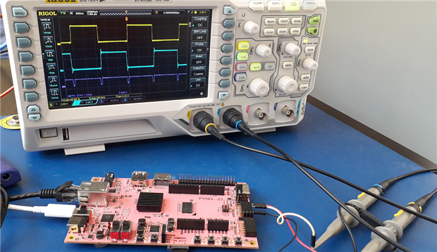

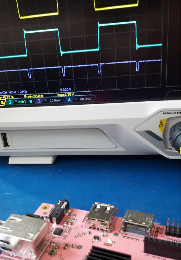

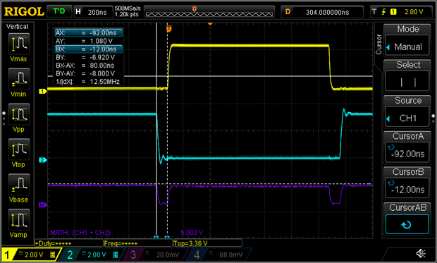

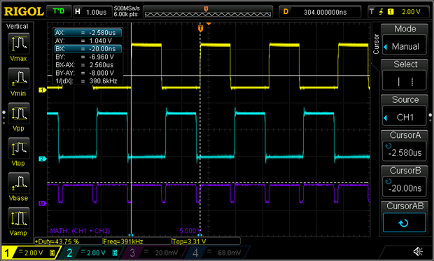

Changing the value has real time impact on the generated signal
image: PWMA and PWMB, with generated deadband
In essence, I now have a half bridge controller that can be controlled from Linux.
A simple starting point, but a real one.
image: the complimentary signals are available on PMODA, pins 1 and 2
