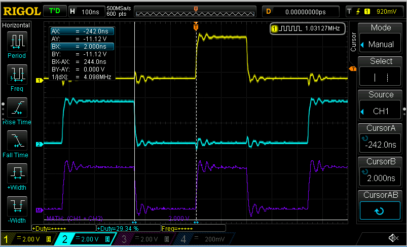

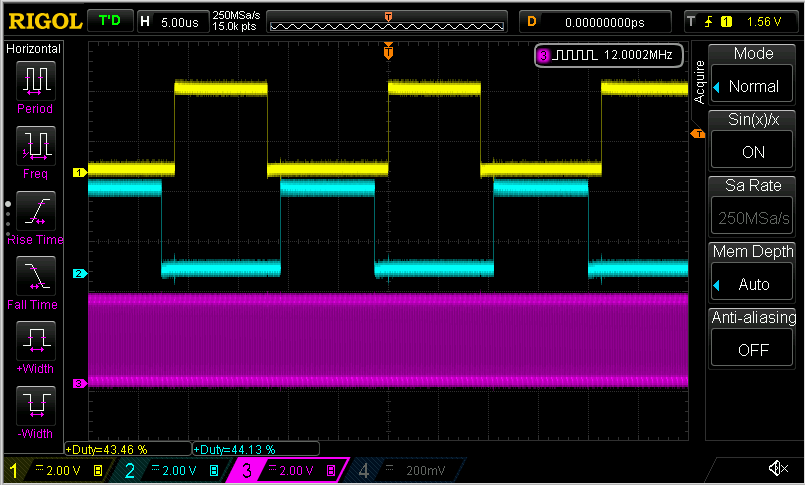

In the capture above, I've set a deadband of 64 clock ticks (to have something measurable on the scope).
The signal frequency is 1.03127 MHz (theoretical 12 MHz * 22 / 256 = 1.031250 MHz)
The time between the cursors is 244 ns for 64 dead band ticks. So the measured granularity of our deadband is 244ns / 64 = 3.8125 ns.

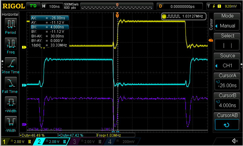

Here's a capture with 8 clock ticks.
My GaN board will run with 2 or 3 ticks - I'd have to use different probe technique to show that.
Good captures in the neighbourhood of 8 ns (that's the deadband that I'll try to achieve) are hard on a 50 MHz scope
