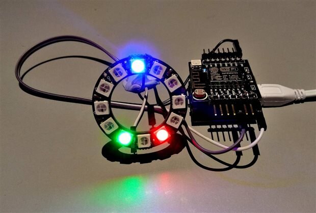

In my quest to sort out the glue that joins all this together, I thought I'd concentrate on the indoor notification portion.
This is an ESP8266 with a neopixel display that runs around pretending to be some sort of clock, while it's waiting on a message.
You can see it here BT_Sentry : Notifications

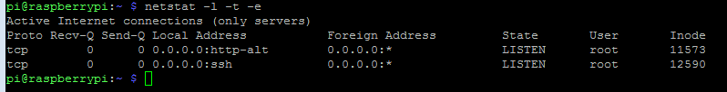

The default settings for Mosquitto allow you to test without specifying the host name.

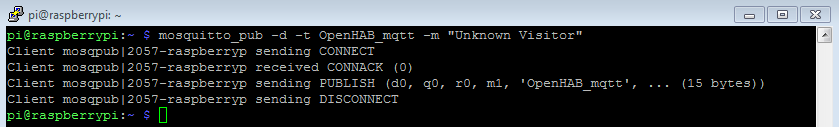

Within the Raspberry Pi I was able to prove that Mosquitto was working by Subscribing an Publishing and it played nice.
Once I tried to connect with the broker using an ESP8266, it all went downhill.
No matter what I tried, the connection was refused.
RPi IP address, default hostname, and some other weird and wonderful creations were no help.
I even changed the WiFi the ESP8266 was connecting to, thinking it was some routing issue.
Still no luck.
In desperation I tried one of the examples, and it connected perfectly to some external broker, so that proved it wasn't my network.
Change the broker in the example back to the Mosquitto and same issue again ... no connection to the broker.

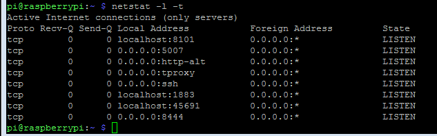

During this problem solving I discovered that for whatever reason there was an IVP6 connection listening to port 1883.
I couldn't recall setting this up, or even allowing it to occur, and worse it was still there when I stopped Mosquitto.

A reboot and check of Netstat shows the TCP6 connections are gone.
There is something listening to 1883 but it still refused to connect.

For whatever reason something was opening a port on 1883.

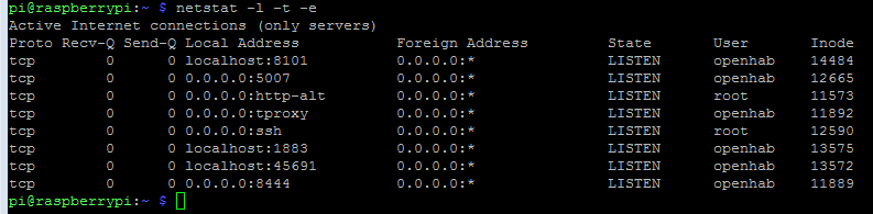

Typing netstat --help gave me the idea to use -e and get extended information.
There's my problem, OpenHAB is starting a MQTT listener and therefore I'm trying to connect to it.

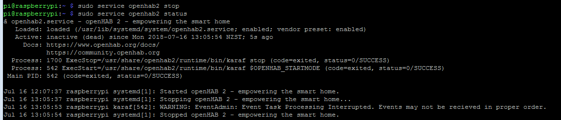

Stop OpenHAB and check to see it has stopped.
sudo service openhab2 stop
and then check the status
sudo service openhab2 status
Note that OpenHAB does take a few minutes to stop, and in the meantime the prompt disappears into the ether. image
recheck netstat.
Hurray, now we're getting somewhere.
Now restarting mosquitto works.
sudo service mosquitto restart

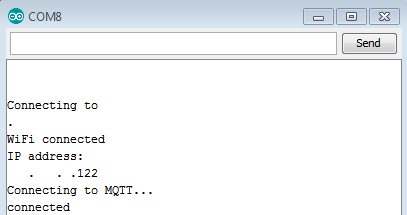

and the ESP8266 is able to connect
and when I publish something
At last some success.

This is my ESP8266 sketch, and I've commented out the time bits, to test the mqtt part.

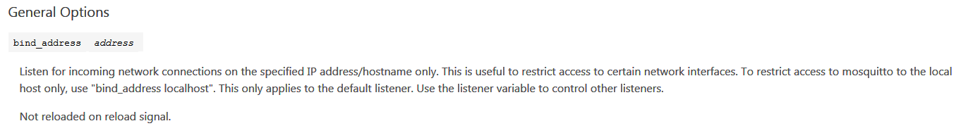

e.g The setting up of a configuration file https://mosquitto.org/man/mosquitto-conf-5.html states
However is this xxx.xxx.xxx.xxx or "xxx.xxx.xxx.xxx" or some other variation.
is there an equals sign, colon or something in between required?
I even saw a few trying to connect to tcp://xxx.xxx.xxx.xxx:1883
So including the actual syntax for each command does make it easier for anyone heading down this road.
