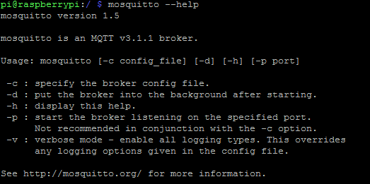

You can check if it has installed and what version by typing
mosquitto --help
In this case it is version 1.5

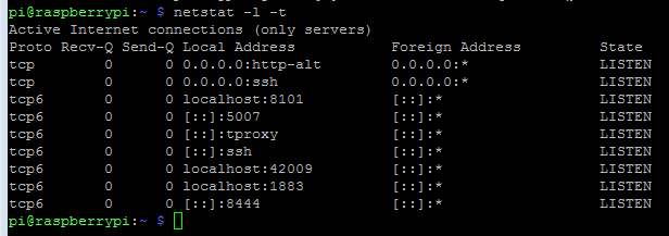

MQTT defaults to using port 1883 so typing
netstat -l -t
This shows that it is indeed listening.
If it isn't then typing mosquitto -d will cause it to start listening.

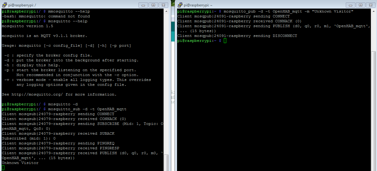

I did find a useful method of checking it works locally here
Installing MQTT Broker(Mosquitto) on Raspberry Pi
Opening two puTTy terminals
start mosquitto by typing in one
mosquitto -d
which starts it in the background. (see the above mosquitto --help results)
then subscribe to a message with
mosquitto_sub -d -t OpenHAB_mqtt
in the second terminal window publish a message
mosquitto_pub -d -t OpenHAB_mqtt -m "Unknown Visitor"
You can see the results in the snapshot below.
So in this case I have used  OpenHAB_mqtt  as the topic
I passed a message Unknown Visitor to whomever was listening (ie subscribed), but I can also pass Known Visitor as well
There is more imformation available at
mosquitto_sub --help
and
mosquitto_pub --help
so in the above test
-d is enable debug messages
-t mqtt topic to subscribe to. May be repeated multiple times
-m message payload to send
While this configuration defaults to using the default host, I need to allow other devices to subscribe.
A quick check shows that
-h mqtt host to connect to. Defaults to localhost.
so adding this to our test example
mosquitto_sub -d -h xxx.xxx.x.xxx -t OpenHAB_mqtt
mosquitto_pub -d -h xxx.xxx.x.xxx -t OpenHAB_mqtt -m "Known Visitor"
where xxx.xxx.x.xxx represents the Raspberry Pi address works fine.

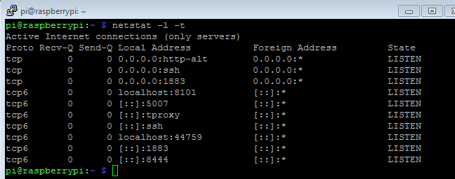

So the trick is to check if port 1883 is active and listening.
netstat -l -t
As you can see on the 2nd to last line there is a port listening on 1883.
But if I try my mosquitto_sub I get a connection refused.

On a reboot now it will start listening on port 1883.

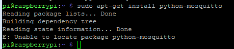

sudo apt-get install mosquitto mosquitto-clients python-mosquitto
While the first two installed fine, the last wouldn't.
Internet search to the rescue and some more things to istall.

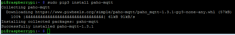

sudo apt-get install python3-pip
After some time and lots of lines, it was installed.
sudo pip3 install paho-mqtt
The pip3 function is like apt-get but the feedback is less than user friendly.
I hate having a blank prompt and not knowing what's going on.
However a minute or so later and it came back with
