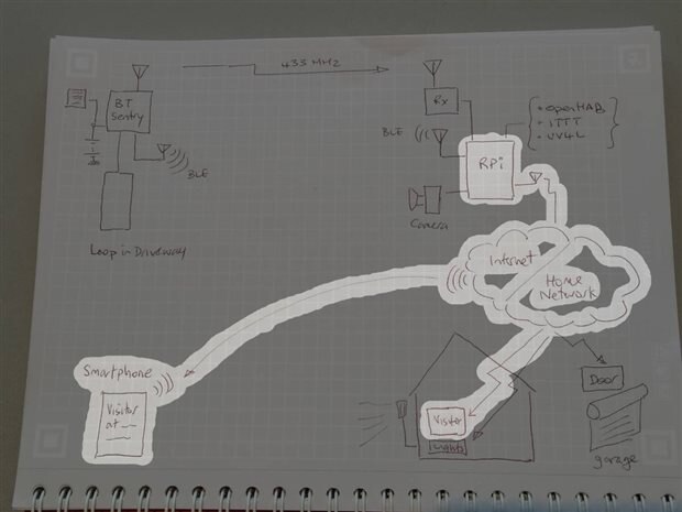

The idea is to detect the bluetooth transmitted from the vehicle and signal other Home Automation functions.
If the vehicle is known then it can open the garage door, and inform the home owner that xx is home.
Hardware
The detection point needs to be at the start of the driveway, and because there is no power source, this will need to be low power with solar charging.
The PSOC range seems a very good fit, but because of the timeline and my need to upskill, the inital design will be Arduino based and some form of RF transmitter/transceiver.
Adding a vehicle detection loop or beam is necessary to ensure those vehicles without bluetooth will also trigger the system.

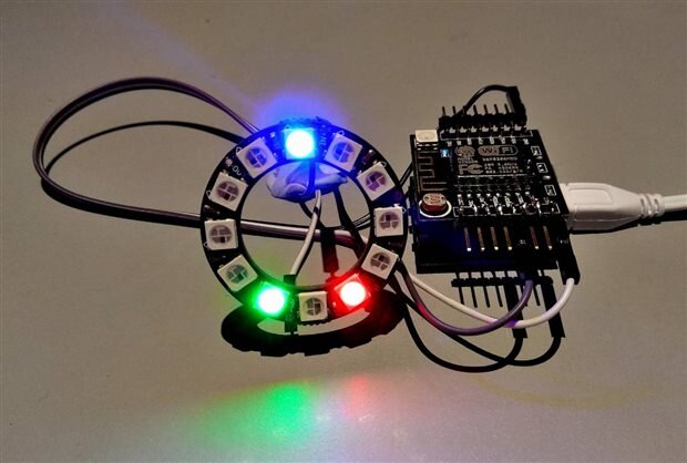

In the meantime I've had a play with ESP8266 and neopixels.
I found this very good post https://www.hackster.io/thearduinoguy/esp8266-neopixel-ring-clock-a9cc74
With a bit of tweaking and a 12 neopixel ring, it makes a very useful object.

Contrary to popular belief, you can drive the neopixels directly from the 3v3 GPIO of the ESP8266.
I did have to download the latest library from Adafruit.
https://github.com/adafruit/Adafruit_NeoPixel
I swapped the order that the pixels are driven so the second hand has priority and overrides the minutes or hours.
The time is currently 17:35 and 0 seconds.
I guess at some stage a different colour when they illuminate the same pixel might be nice, but in the meantime it works.
The ultimate clock would be the 60 ring neopixel and it's very tempting to do some online shopping .... image
My intention is to change the display to all green or all red to warn of impending visitors.
in the meantime the clock display gives some assurance that it's connected and working.

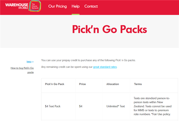

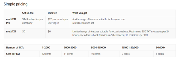

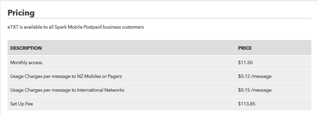

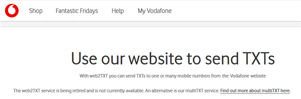

Hence my quest was for a means of sending an SMS to a phone or phones.
While there are plenty of free services around, it seems the New Zealand Telcos have blocked any messages that originate outside New Zealand.
I guess it reduces spam, but I suspect it is more to ensure their own service has to be used.
Telecom runs eTXT, and while the monthly charge might be reasonable, the setup fee is a rip-off.
Vodfone had a great affordable service, but clearly that had to change.
And clearly it did. Again the monthly fee bordering on reasonable, but the setup fee is a rip-off.
I did find one service in New Zealand, signed up  and tried it out.
All that effort to find out that it relied on advertising revenue, and it hadn't had any, so it couldn't/wouldn't send the SMS.
GREAT ... worse than that, there is no way to unregister.! image
While I have no issues with the per text charging, for this project these prices are just not sustainable.
I could purchase a mobile, get a SIM card and send them without all this cost.
I do have a TStick that is designed for data, and I'm wondering if you can use it to send texts?.
Regardless of that, I've decided that I will not be doing this aspect of my proposal.
