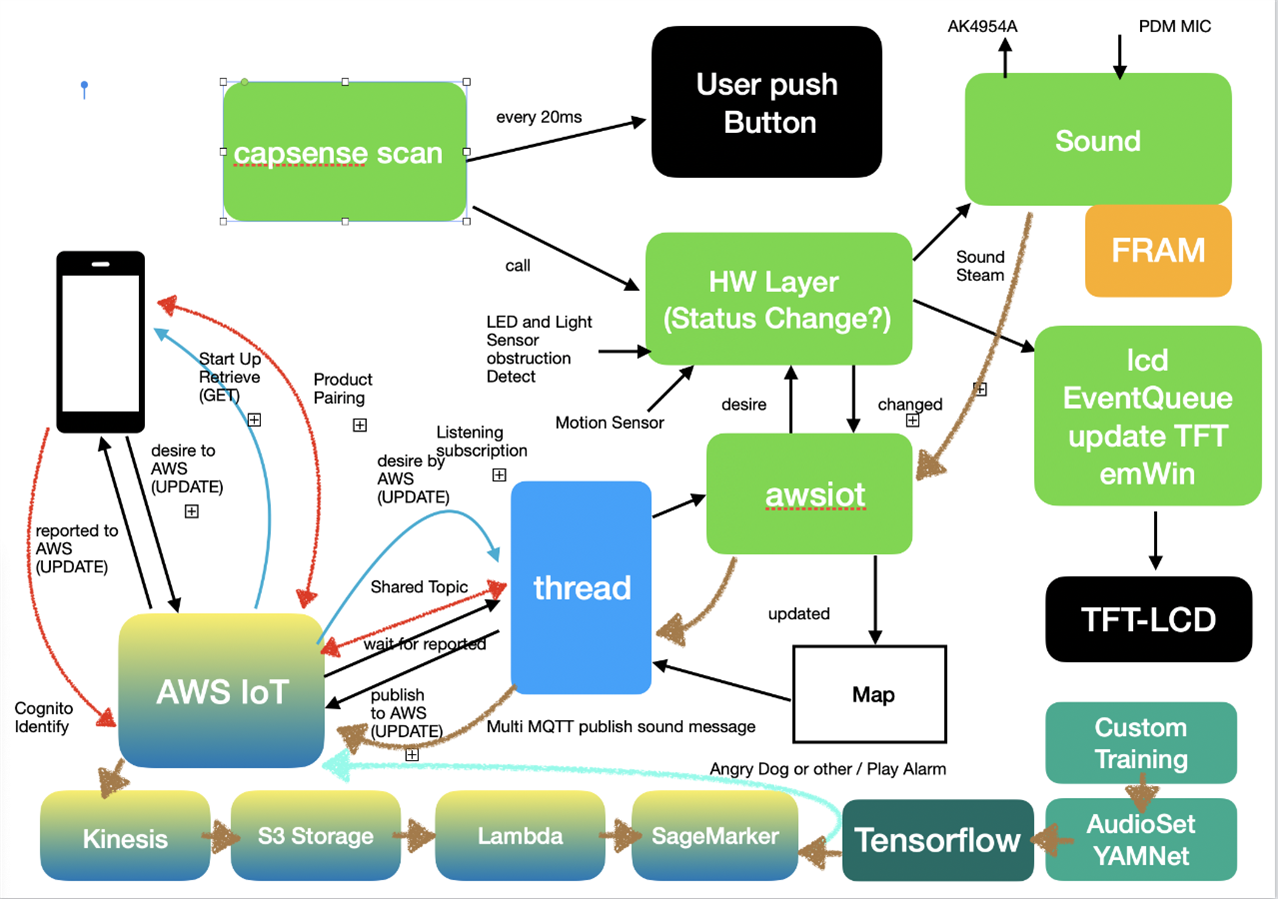

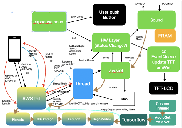

Block Diagrams
Above show the intelligent mailbox software components involved.
In additional of Cypress Pioneer Kit and the TFT shield, only a green led for mail detection is used.
For develop platform we run:
1. Mbed CLI
2. ModusToolbox 2.1
3. Xcode 11.4
Brief of the system working flow
Our System with three main parts, the cypress kit, AWS IoT Cloud and IOS APP:
Cypress
  1. Initiation of Mic Sound Card, WIFI and NTP,  Motion sensors, Analog Input of Light Sensors
  2. Initiation of FRAM and retrieve last status
  3. Initialtion emwin LCD display
  4. Setup WIFI connection
  5. Start up AWS IoT MQTT, subscribe to shadow get and productmetadata
  6. Retrieve AWS shadow status
  7. A separated thread for AWSIoT network transfer, included read FRAM sound data for stream and publishing shadow, handling IOS APP pairing, when idle wait of subscribe incoming.
  8. main thread enter to 20ms forever loop for :
    • Capsense read
    • Sensor read
    • Sound recorder control
    • RTC update
   9. Seperated thread for LCD update, which serve the main / awsiot thread for display task by event query
10. PDM MIC and I2S SOUND Interrupt for save data to RAM buffer, forwarding sound clip up to 12s under FRAM, only very small RAM buffer is required thanks of fast FRAM.
AWS IoT Cloud
  1. Security access managed MQTT broker
  2. Working for AWS shadow, provide two way synchronisation between IOS APP and Cypress Device
  3. Congnito user login for APP
  4. Kinesis stream for sound
  5. S3 Storage for storage sound clip recorded by cypress kit
  6. Lambda python function reconstruct sound steam, add wav header, build Transcribe job and publish result back to IOS APP and Cypress Kit
  7. Run under SageMaker for recognition of sound to classfield is or is not angry dog, if angry dog sound recognised, push alarm wav to IoT device and play it.
