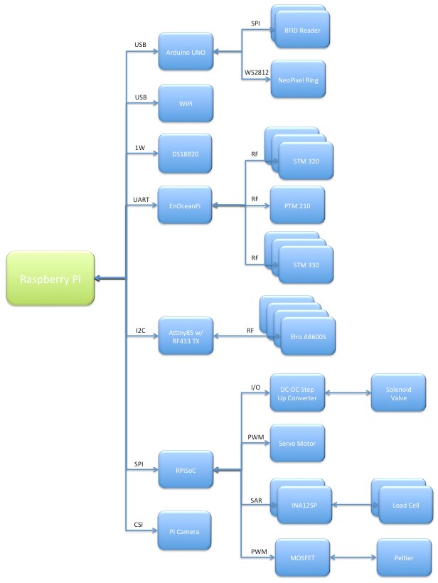

Hardware Components Overview
A lot of different components were used in this project. I have attempted to create a clear overview of how all components are logically interconnected.
As visualised below, the Raspberry Pi is at the center of this project. Sensors are connected either directly to the Pi or offloaded to another device which is controlled by the Pi. Various communication types have been used, depending on the device/sensor's capabilities.
Raspberry Pi
The Raspberry Pi can be considered as the "master controller" of this project. It hosts the software and interfaces with the different subcomponents.
Everything is connected to the Pi, making use of the GPIO pins or USB ports.
RPiSoC
The RPiSoC simplified a lot for my project. Because of the wide variety of functions, all controllable through a Python API, I was able to implement various features easily.
The RPiSoC drives the following components:
  • a servo motor for the food dispenser
  • a DC-DC step-up converter's enable pin using a digital output to control a solenoid valve
  • a peltier by means of a PWM signal and a MOSFET
  • two load cells using INA125P instrumentation amplifiers and two onboard SAR ADCs
The RPiSoC is an interesting add-on, complementing the Pi's GPIO with a bunch of new features.

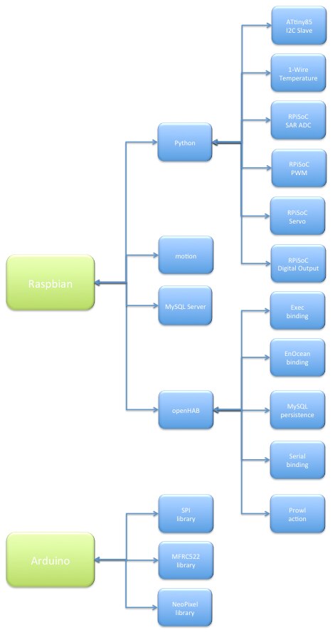

Software Components Overview
On the software side, some major components have been used, which then rely on scripts or subcomponents to get the different functionalities covered.
On the Raspberry Pi, 4 core components are used:
  • openHAB
  • MySQL Server
  • motion
  • Python
On the Arduino, 3 libraries are used:
  • SPI
  • MFRC522
  • NeoPixel
Here's an overview:
Let's go into more detail on each software component.
openHAB
Just like the Raspberry Pi is at the center of the hardware components, openHAB is at the center of the software components.
openHAB offers an easy to customise GUI, powerful rules engine and a wide variety of bindings and actions.
The installation of openHAB is covered in full detail here: [CaTS] ForgetMeNot - Week 1: EnOceanPi and Sensors
A handful of add-ons are used by openHAB in order to perform the required actions and data collection.
The add-ons used in this particular project are the following:
  • exec binding: is used to execute python scripts to get or set values from sensors
  • enocean binding: controls all enocean sensors described in the hardware components
  • serial binding: is used to interface with the Arduino UNO
  • mysql persistence: ensures all sensor data is persisted for trending
  • prowl action: takes care of push notifications
MySQL Server
The MySQL server is used for persistence of data from openHAB. I have selected this database type because it is the one I am most familiar with for deployment and troubleshooting.
Setting up the MySQL server and persistence in openHAB is covered in detailed in following blog post: [CaTS] ForgetMeNot - Week 3: Data persistence and charts with OpenHAB
motion
The motion application takes the video stream from the Pi camera and converts it to an MJPEG stream, which can then be embedded in openHAB.
For more details, see: [CaTS] ForgetMeNot - Week 2: Elro CoCo and Pi Cam with OpenHAB
Python
Python scripts are used to perform actions for which there is no suitable binding/action in openHAB.
By making use of openHAB's exec binding, the different scripts can be triggered to set or get values, depending on their purpose.
I have created following set of scripts:
  • cats_scale.py: read the voltage from the RPiSoC's SAR ADC and convert it to weight
  • cats_foodpy: control a servo via the RPiSoC to actuate the food dispenser
  • cats_water.py: control a DC-DC step-up converter to actuate the water dispenser's solenoid valve
  • cats_cooling.py: control a MOSFET driving the peltier element using a PWM signal generated by the RPiSoC
  • cats_rf433.py: control wireless power sockets by sending commands to an ATtiny85 driving a 433MHz transmitter
  • cats_temperature.py: read the temperature of a 1-wire sensor connected to the Pi's GPIO
The full set of scripts can be found on GitHub for reuse: https://github.com/fvdbosch/ForgetMeNot/tree/master/python

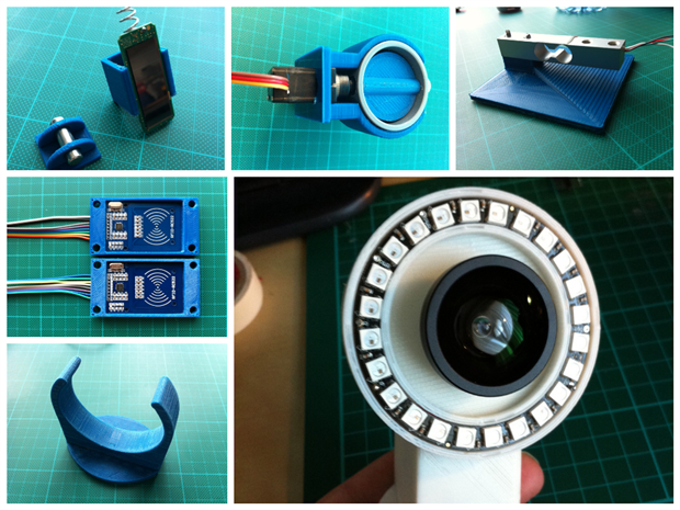

DIY Components Overview
Some parts needed to be created in order to be able to combine everything into a single solution.
3D Printing
3D printing is fun, that's for sure. But in this project, I tried to demonstrate that it can also be very functional.
A lot of parts have been designed and printed, ranging from clips for EnOcean sensors, weighing platforms for load cells or even mounting plates for RFID readers.
I've made a small collage of some of the parts.

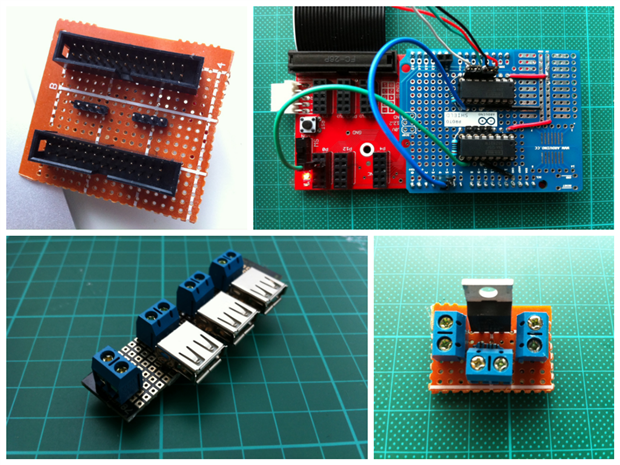

Circuits
In order to interconnect the different hardware components, I had to create some small circuits.
The different circuits are:
  • a power splitter: using a single power supply, up to six devices can be connected either via USB or screw terminal
  • a GPIO splitter: the splitter was required to make certain pins of the GPIO header available to different components
  • a RPiSoC shield: the shield is used to connect two load cells to the RPiSoC using two instrumentation amplifiers. It also provides connection for a servo motor.
  • a NOT gate: to drive the water dispenser's solenoid valve, an inverted pin is required in order to avoid problems in case of reset of the RPiSoC
  • a peltier driver: using a MOSFET and a PWM signal, a high current device such as a peltier can be controlled variably

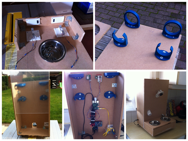

Enclosure
Every project deserves a nice enclosure/build. This project is no different.
I the last weeks, I started building the frame and installing the electronics, using the 3D printed parts.
Both home automation and pet care system components have been integrated in the enclosure, resulting in a single solution with many capabilities.
