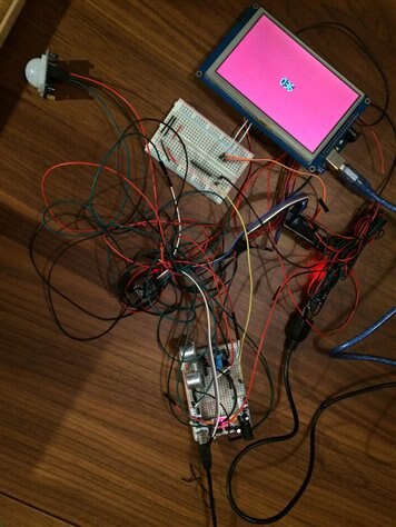

Hi there! Following the previous post and the issues I found with the TFT and the RF24, I´m happy to share that I managed to solve it. Rather than solving it, I have had to apply the workaround briefly introduced earlier this week: add a master node to control the RF while delegating the rest of the functions to the slave one. Let´s go into the details after the project status.

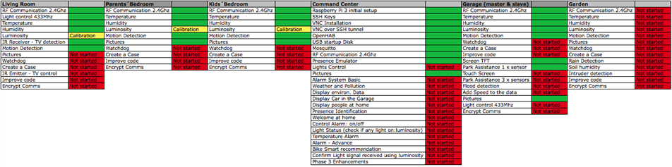

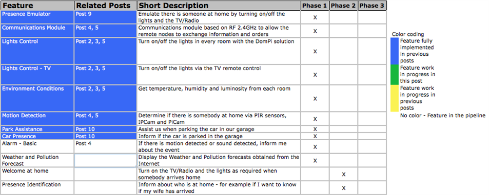

Project Status

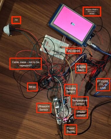

Due to some incompatibilities of my TFT LCD with the SPI protocol - very probably it is not releasing the bus when the device is not addressed by the chip -, the RF24 board was not working properly. Both devices, the screen and the RF, are key components of the Garage node and hence, I could not sacrifice any. I have not found any potential solution rather than the work around to separate the TFT and the RF24, connecting them to two different Arduinos and interconnecting the Arduinos with I2C:
  • Arduino Mega, Slave node: temperature, humidity, luminosity, movement, distance measurement, TFT display and I2C slave node
  • Arduino Nano, Master node: 2.4Ghz radio frequency communications and I2C master node

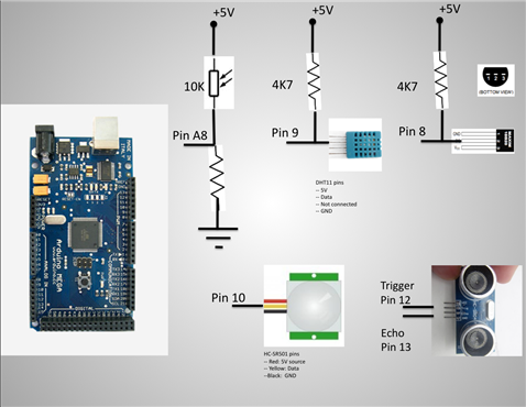

Slave node - sensor blocksGarage node: master + slave + TFT + RF24

Summary of the Garage Node
In the end, the garage node has become a bit more complex than expected, but at least working. As you can see from the pictures below, the last minute changes have transformed two arduinos and some sensors into a mess of cables prone for errors and disconnections... I promise to arrange them much better! Will do it when I try to put them into a plastic box (like those you can by in the supermarkets to store your food) - as discussed in a forum discussion, I have not found any better enclosure for this node... image
Yet another issue that I have found was with the Serial.print and the Mega. In one of the lines I wanted to inform via the serial port of a warning like this "Bla, bla bla !!!". I also made some changes to the code and it stopped compiling. It did not compile regardless my efforts to change the additional code and so until I found in google that the Mega goes into monitoring status when the uploader sends a string with the "!!!" and the upload never takes place... more time lost...

    That wiring is very artsy not to be imitated. I love it! Clem
  • fvan
    fvan over 10 years ago +1
    Impressive wiring indeed
  • clem57
    clem57 over 10 years ago in reply to mg.sergio +1
    It takes a sharp eye to make and check those leads. Don't' kid yourself. I have done a few over time and amaze myself how I ever wired it up. I also believe a clean desk is a sign of a empty mind. Cle…
  • mg.sergio
    mg.sergio over 10 years ago in reply to mcb1
    Thanks mcb1 for the RFM69, it seems a good alternative. Let´s see how I end up with the RF24. Re the wiring, it did not help the only jumper-cables at hand were 70cm (2.3ft) long - yes... yet an excuse image
    mcb1 over 10 years ago
    Wiring like that is definately fine ...until you need to problem solve, or you accidently pull out a wire image
    Been there, try not to go there again....
    These little 'time wasters' are always the things that get you.
    Nice to see you've been able to identify each problem and keep heading towards the end goal.
    If you decide the RF24 modules just don't work out, I can suggest the RFM69 modules that we got introduced to in the Forget me Not challenge.
    It's relatively easy to add the single gateway to get serial or I2C data.
    DAB over 10 years ago
    Great post.
    You are making good steady progress and highlighting that not all integration efforts work smoothly.
    Great example of standard project flow.
  • clem57
    It takes a sharp eye to make and check those leads. Don't' kid yourself. I have done a few over time and amaze myself how I ever wired it up. I also believe a clean desk is a sign of a empty mind.image
    Clem
  • fvan
    Impressive wiring indeed image
