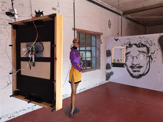

The above list does not need more words to explain the amount of processing power needed by the Raspberry PI. One of the reasons it was possible to create this scenario is due to strong software optimization, as well as taking care to optimize every resource. We should not forget that all these tasks will run concurrently in a small embedded Linux machine.
Above: Seven Of Nine seeing if some data is coming from the MagicMirror

    Hi Enrico, This is a fantastically well-polished project! It's a clever idea to house the Pi and hardware in the frame, so people can walk and see it from behind, and understand how it could all work.…
