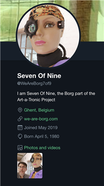

Finally, I focused my choice on using Twitter for user chatting through Direct Messaging.
Maybe conditioned by the fact that I rarely use it, initially I was not so happy to use Twitter Direct Messaging. Considering the task in charge to the animatronic and the kind of chat I was searching for then this choice revealed probably the best solution: only text chatting, not important to share images and other media, easy to authorize the human user to start a conversation and simply to stop if needed.
DM (=Direct Messaging) is a subset of the Twitter social network features.  It is easy to limit the number of users that can or can't chat via DM and the possibility of chatting does no impact authentication, privacy, and other features. A  blocked user to send DM is not blocked following and sending tweets, as well as the other features of the social network like mentions (you can tweet mentioning also a user that you are not following and don’t follow you)
Seven Of Nine Twitter account profile

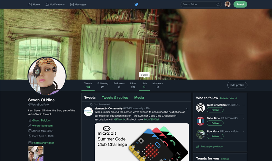

Twitter Direct Messages from Seven Of Nine: Evolution
Until I started to use Tweepy in a different context than sending Tweets I have considered this feature almost experimental. Instead, the experiment worked well and continue by over one month. I decided it was time to move Seven Of Nine to the next step: I have created a dedicated Twitter account Seven Of Nine (Twitter user @WeAreBorg7of9)
Above: Seven Of Nine Twitter home page

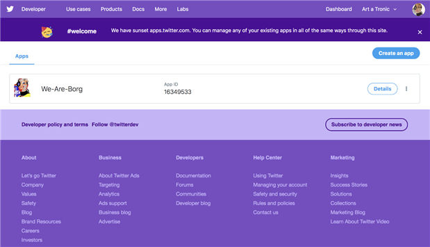

To complete the Twitter new user registration procedure it is necessary to specify an email so I have created a dedicated email too: sevenofnine.artatronic.borg@gmail.com
BTW, I also own the domain we-are-borg.com that will be soon online. Until the Borg website is not yet active you can send emails to Seven Of Nine, as well as start following the Twitter account mentioned above and eventually chatting with her.
After the new Twitter user has been created and confirmed, I have also registered Seven Of Nine as a Twitter developer and created the application We-Are-Borg, with its own public and secret keys and OAuth access token.

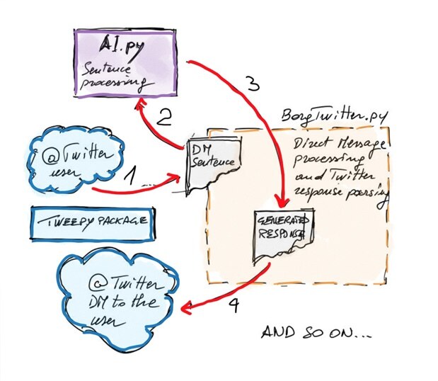

Software Notes
The image above shows the internal logic followed by the system to manage the Twitter messaging autonomously. As you can see the Tweepy package is the interface between the custom classes and the Twitter API.
The main logic implies checking if new messages have arrived in the list of JSON objects provided by the call to direct_messages() of the Tweepy package. If new messages appear on top of the list the AI class provide to process them generating the response, sent back to the generating user chat. This main event control is managed by the Python script TwitterBorgChat.py.
Note that while the Twitter chat is running the Raspberry PI is also able to maintain a voice chat with a local user.

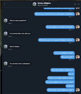

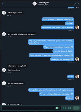

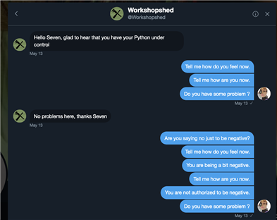

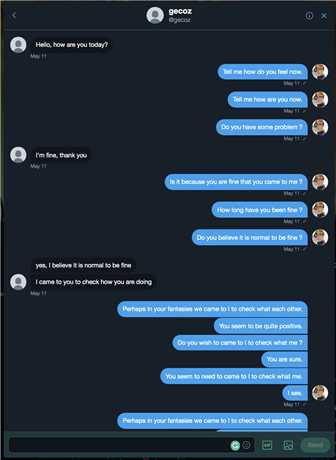

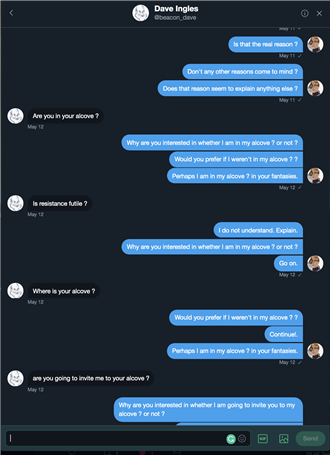

Chatting With the Borg
Below some abstracts of the chat Human-Borg created during the testing by Dixon Selvan, Dave Ingels, Andy Clark, Fabio Origlia and myself.
Me and Andy
Dave
Dixon
Gecoz
As you can see, there is a flaw in some sentence-response, where the sentence (or group of sentences) is repeated twice. After investigating I discovered being a problem of the Twitter API that updates the list slowly than the real sentence sent by the server to the chat area; sometimes when the list is read also some messages already processed appears as without response again. This flaw will be corrected in a future version of my class, adding a more rigid control of the received list of sentences taking n account the timestamp, that should be later than the last time response has been sent to a certain user.
