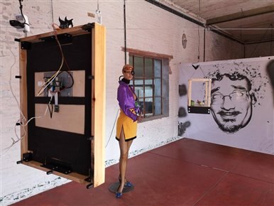

A Window to the Outer World
SevenOfNine should be able to interact with the visitors and the surrounding environment in several ways. One of these is starting a contextual speaking to the visitor through a third subject creating an unexpected and surprising situation; in all the interaction events the human-machine communication is started involuntarily by the visitor that originate a sequence of connected events:
  • The visitor is "forced" to note a magic mirror hang at about five meters from Seven Of Nine. it is impossible not to see it, especially watching toward the Borg-like.
  • The visitor is attracted by the hanging mirror showing a text (refreshed every 30 seconds) and the current time and moved toward it.
  • The mirror detects the subjects (via an ultrasonic sensor) and recognizes its moving direction
  • As the visitor nearby to the magic mirror, a live image is overlayed on the mirror screen.
  • While the visitor is focusing his attention to the magic mirror SevenOf Nine is notified of the event
  • SevenOfNine takes a shoot, send a tweet and says some sentence, contextualized to the situation.

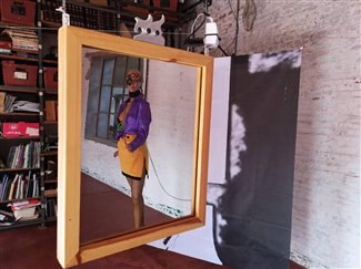

As a matter of fact, the mirror is part of the SevenOfNine installation constantly interacting with the mannequin.
Making the Magic Mirror
It is not the first time I build a magic mirror (the last was the Scary Mirror for the past Element14 presents Halloween) but in this case, some complications arose and I had to face to unexpected issues.
The Base Design

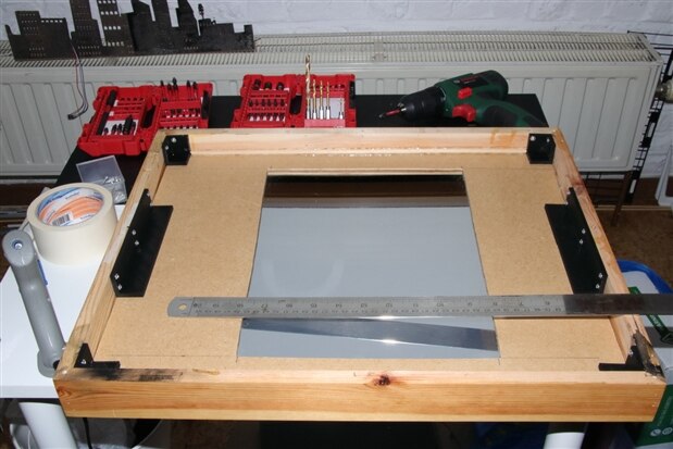

The principle to create a "magic" mirror is relatively easy; if it is well designed the impact on the visitors, especially those who have no idea of what will happen, is really nice. I started revisiting my first Magic Mirror project – a Magic Mirror development platform to experiment with the Raspberry PI – to which I have applied some structural changes. In principle, a Magic Mirror is a screen behind a semi-transparent mirror; this makes possible to generate incredibly and surprisingly effects.
The semi-transparent mirror front side is firmly kept in place by a big MDF frame; the remaining visible rectangle hosts laser-cut plywood with a square hole for the Pi Camera lens and the 7" Raspberry PI LCD touch screen (in this case the touch features of the screen are not used). For more details on the structure, look at the Magic Mirror project mentioned above.

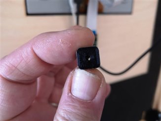

  • An Ultrasonic distance sensor, part of my Elegoo box of sensors.

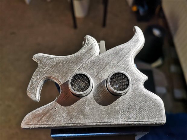

Dressing the Sensor in Style

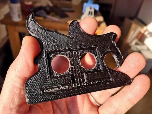

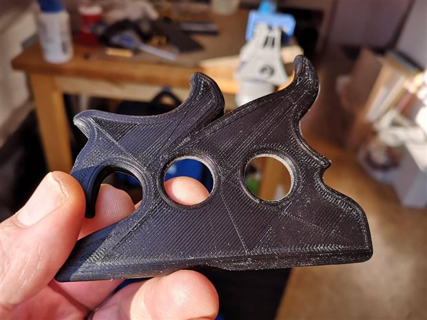

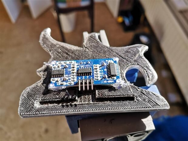

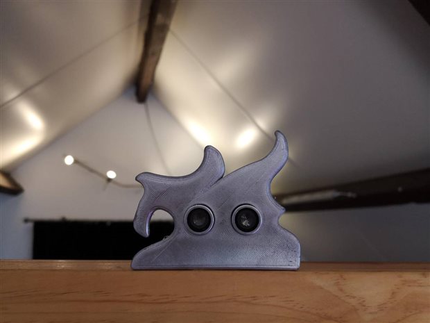

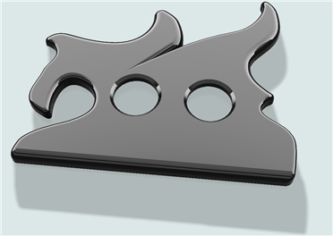

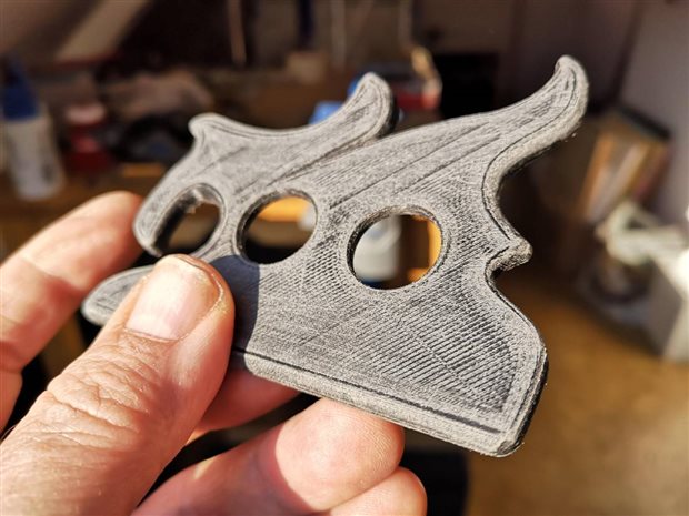

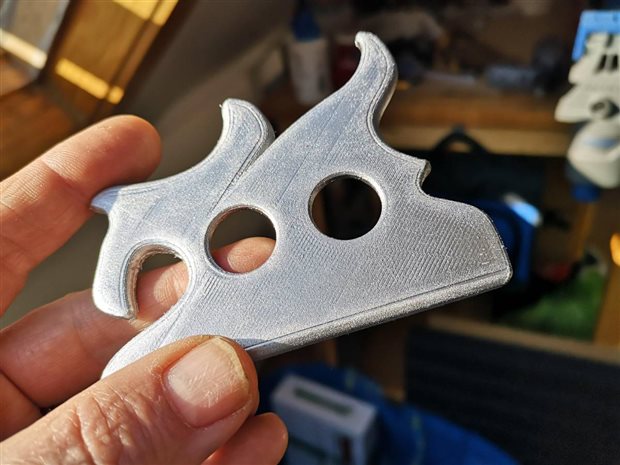

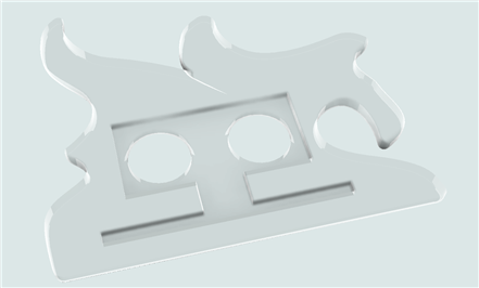

Also for the sensor, I have designed the sensor support with Fusion360 following a similar style of the eye implant and the laser of SevenOfNine.
Above: the quoted sketch of the ultrasonic sensor support for the Magic Mirror.
Below: the 3D rendering of the finished support.

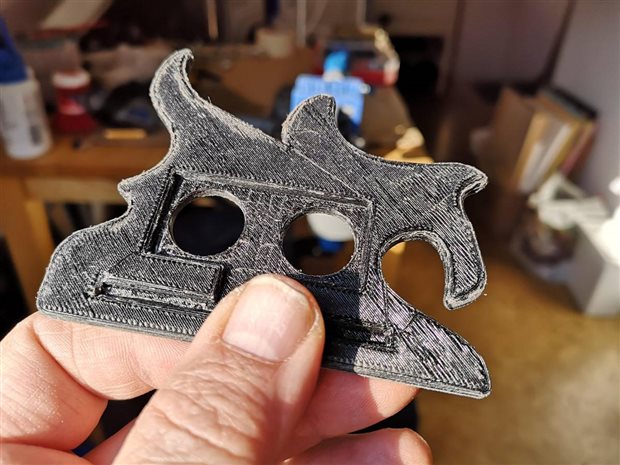

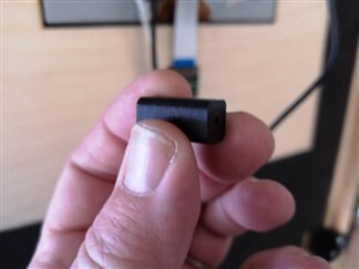

The sequence of images below shows the phases building the support and installing the sensor to its back.
{gallery} Magic Mirror Sensor Support
The 3D printed sensor support (front side)
The 3D printed sensor support (back side)
The support refined with sandpaper (front side)
The back side, partially refined
The support after chrome spray paint
The back of the support with the sensor hot glued in place
The finished sensor, ready to be positioned on the mirror

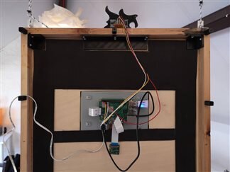

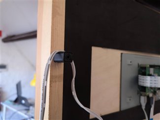

The sensor fixed on top of the mirror frame
Note that the ultrasonic sensor has been placed on top with a slant of about 5 DEG to the bottom for the better coverage detecting when a visitor approach the mirror.

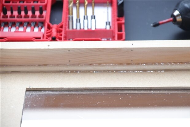

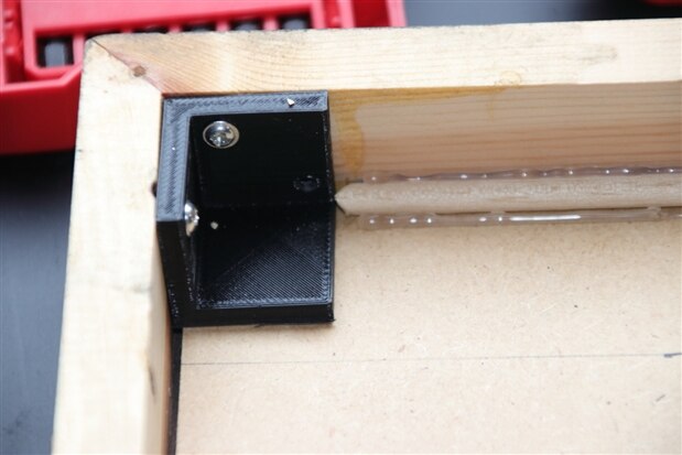

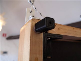

Finishing the Assembly

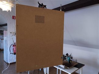

To close the back of the mirror frame I have 3D printed a series of spacers to fix the back leaving internal air circulation.
Then, after gluing ten spacers on the border of the frame I have closed the mirror with a sheet of MDF 3 mm thick

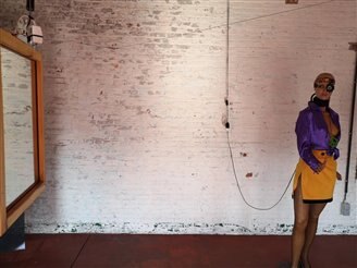

In the below images: the magic mirror installed and "visible" by SevenOfNine

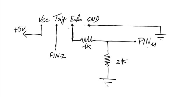

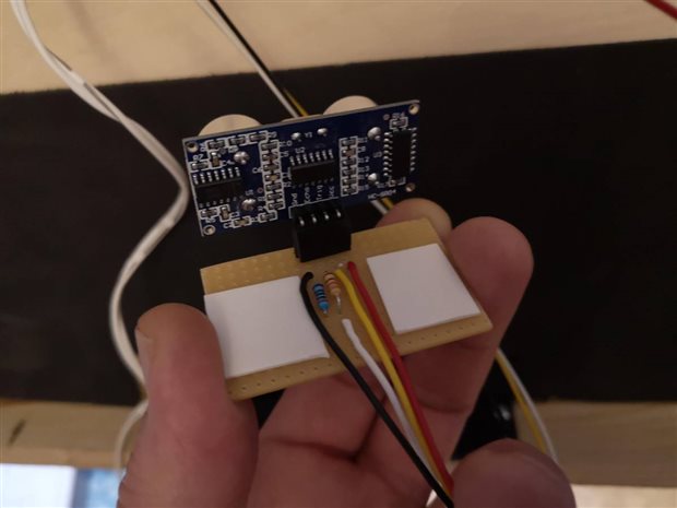

The Ultrasonic Sensor: Circuit and Software
The ultrasonic sensor HC-SR04HC-SR04 has four pins; the two power pins has been connected to the Raspberry PI 5Vcc and GND. The Raspberry PI pin 7 instead has been connected to the Trigger, to initialize the sensor emitter. The 3.3V provided by the Raspberry PI GPIO outputs are sufficient to activate the circuit. The Echo input instead, has been applied to a voltage divider as the sensor works at 5V while the Raspberry input pins accept 3.3V max. This small circuit has been assembled on a PCB breadboard attached to the connector and connected to the Raspberry GPIO as shown in the image below.
Driving the Ultrasonic Sensor
The principle on how the sensor works is easy: we start the ultrasonic emission changing the state of the trigger signal then see how many microsecond are needed before the echo signal goes high. Knowing the speed of the ultrasonic frequency we can calculate the distance of the subject intercepted by the sensor with the precision of a centimeter over a distance range of about 4 meters. This and other functions are managed by the distance_sensor.py Python script. Below the checkDistance() method that executes the distance calculation and optionally adds a short delay at the end of the reading.
