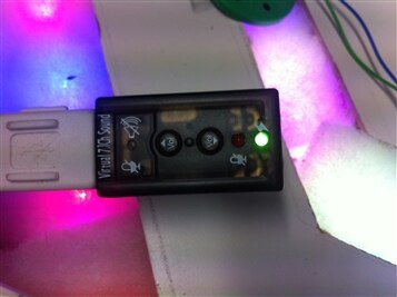

I was testing the combination of audio and light effects today, only to find out that they are affecting each other!
Playing audio messes up the animations and the LED strip starts blinking randomly. There is also a nasty jitter in the audio output. I don't know the exact cause of the problem, I just hope it won't affect anything else ... There's a video at the bottom of this post, demonstrating the problem.
Solution?
The current workaround involves a USB sound card. It's a super cheap, low quality sound card I got from eBay for about $2, which I had around. The device is plug an play, and all that is required is to specify it as the output device when playing out sound files.

It is the last one in the list, card 1, device 0. These are the two parameters required when playing out, using the "-D" option:
pi@PiDesk ~ $ aplay -D hw:1,0 example.wav
Playing WAVE 'example.wav' : Signed 16 bit Little Endian, Rate 44100 Hz, Stereo
The workaround is not that nice, but due to the time constraints, I'll stick with that for now. Another disadvantage of this solution is that it requires an extra USB port on the Pi. As I was planning on using the A+ (with a single USB port), I'll either have to use a USB splitter or move to the B+.
Anyway, problem solved for now, let's hope no other surprises pop up ...

    I suspect something is happening to the clocking for the signal.
    At least you have a workaround to continue.
    Jan Cumps over 11 years ago
    I can only see available processor time per process as a reason for the two things interfering with each other - or are they both relying on / messing with  the same hardware clock?
    balearicdynamics over 11 years ago
    Hello Frederick, well done and fascinating work !!! Can't wait to see the desk full operational.
    Then about the problem of the "noisy PI", I have no idea what this can be, the same tic happened to me in the same way. Definitely the only solution was to use (in my case the Cirrus Logic) and external audio card. Maybe there is something strange or whatever else but I don't know. Take a look to this video and you find the same almost identical issue. http://www.element14.com/community/videos/16822/l/speakers-issue
